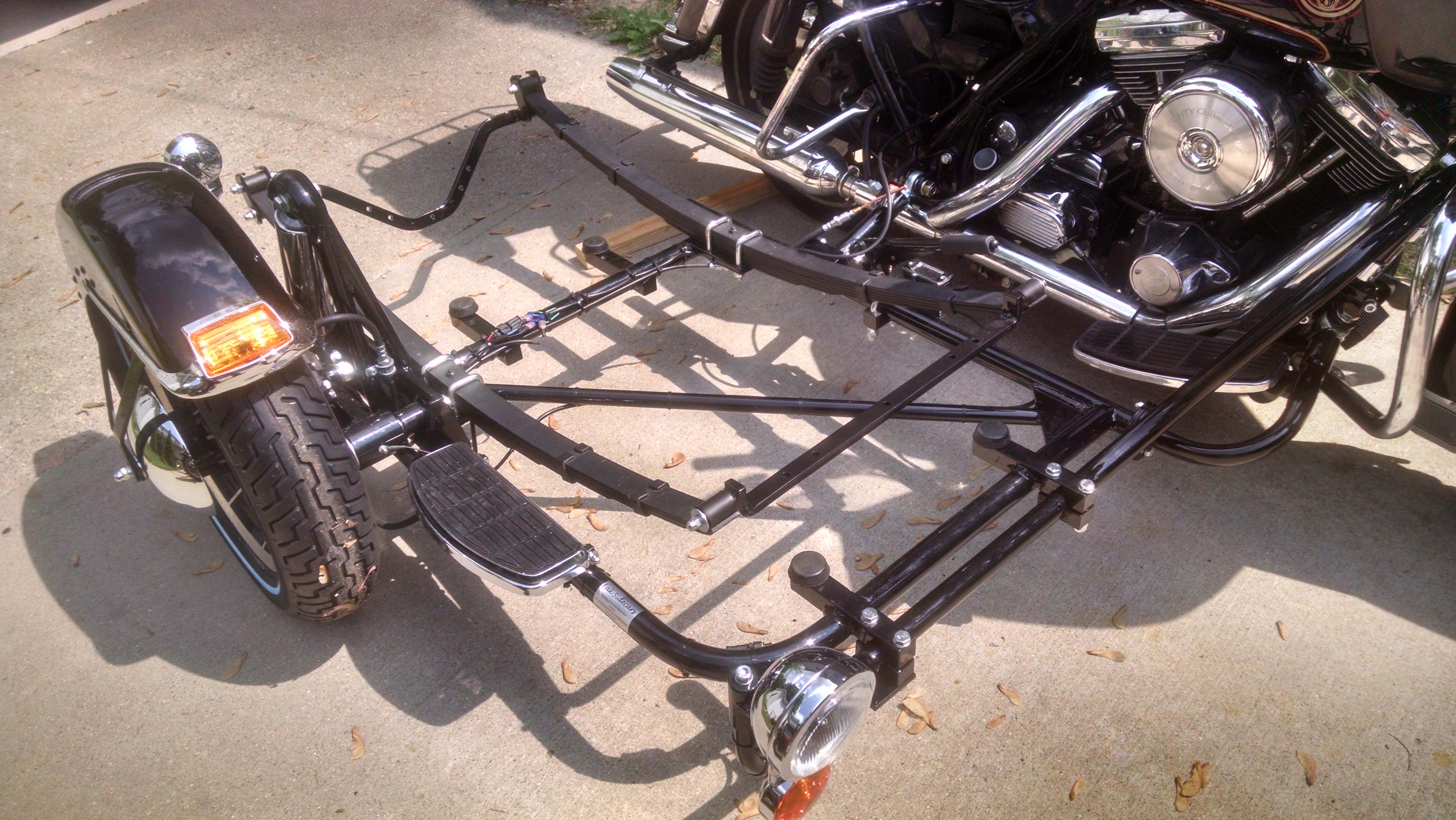

I am in need of a little assistance. I am in search of a new chassis for my car because I have a shovelhead mount that wont mate with my FLH. I have too much in the car/ paint and other accessories to part with the entire rig but is there another frame that will be a descent fit for my harley sidecar?
Posted : July 6, 2016 6:01 pm
(@davet)
Posts: 196
I have a Lak sidecar frame from the Netherlands. I have a Harley tub that bolts directly to the leaf spring crossbars same as it would to the standard Harley frame. I got the Lak sidecar frame because it has a suspension on the sidecar wheel. It was not cheap and took a little while to get it but I am happy with it. The mounts are basically the same as the Harley mounts but with a mix of English and metric fasteners. I looked at Liberty but I like the looks of the newer Harley body better. You could probably bolt a later model Harley tub to a Liberty frame if you could find one. I'm sure DMC or Claude Stanley could build you a frame that would work with your tub.

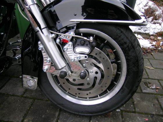

Great website! I particularly found this to be very interesting:
Posted : July 8, 2016 3:38 am
(@davet)
Posts: 196
Yeah, there are a few interesting front end treatments on those bikes. DMC makes a trail reducer similar to that for Suzuki v-stroms and maybe other bikes too.

IndSlim - 7/8/2016 9:38 AM
That sure looks interesting
