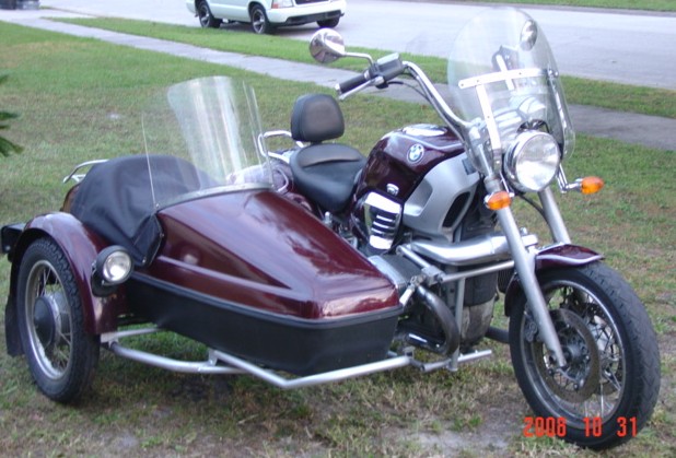

Yes it sure look like one but maybe it was modified with body work because the one I had looked a little different. My fender was seperate from the tub. Take a look. I hope this helps.Regards,Les

That looks like it except you have the head rest and rack. the fender is part of the tub. Any idea where I can get a tail light lens? I guess I will start serching for Lucas. Thanks for the info.

Les. Quick question. the car you pictured looks the same. How is your seat attached. It seems like the previous owner bolted a modified gate hinge on the front to the seat so it can tilt forward but is bolted to the bottom. I was planning on taking this out since it looks very uncomfortable to sit on these hex bolt heads. The added foam would not help that much. Is your seat attached to the car or sitting loose inside?
Does the head light look stock on yours or do you think it was added? Seems like a very good idea for more light plus you would be able to see the car at night from the front. He does have a car battery behind the seat which seems like a good idea since those old beamers were not that great electrically.

The seat in this one was hinged in the front like yours. I believe the headlight was stock. I would recommend using LEDs for a light on the front but only for awareness at night as LEDs use very little electricity, just a thought.Regards, Les

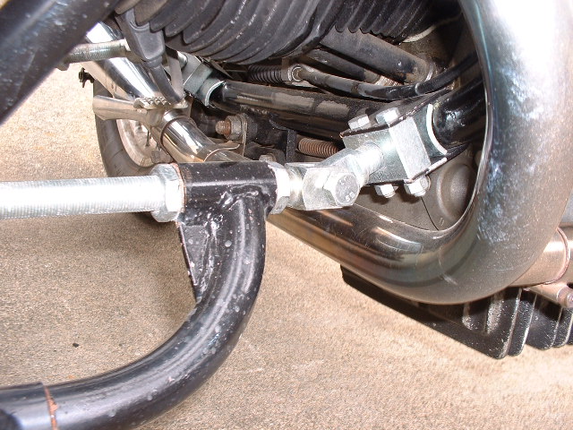

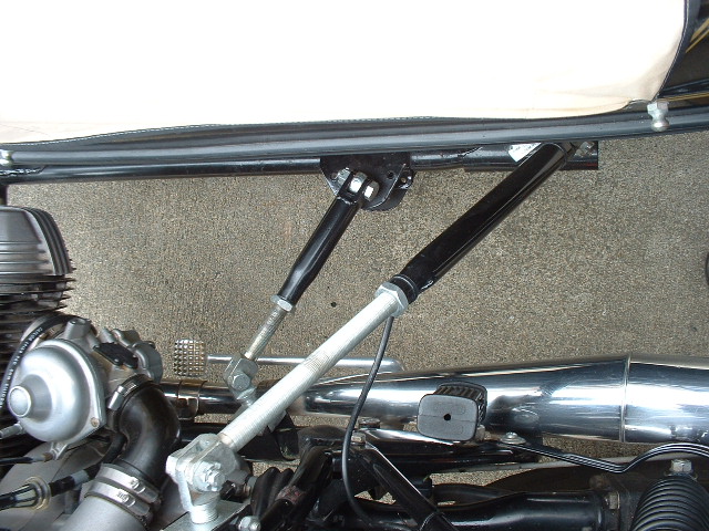

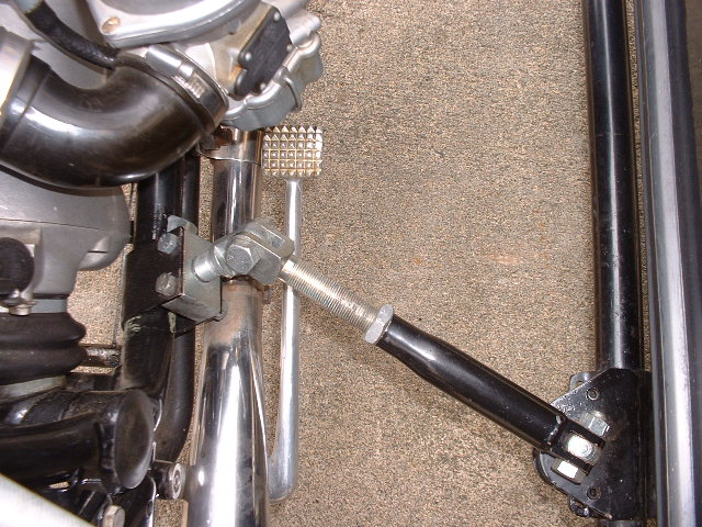

E_K wrote: "Oh yes. By the way. The bike that came with the car is a 1970 R75/5 Seems the bike was owned by a man that used the rig to drive his kids to school. Just bolted on the standard frame. Any thoughts on this."
If bolted directly to a /5 frame it no doubt was an evil handling rig and a Joe McGee setup. I've had a few of these come through the shop.
Here's a couple of examples of what I call "Mortis Rigging".
Note the right foot peg (not).
