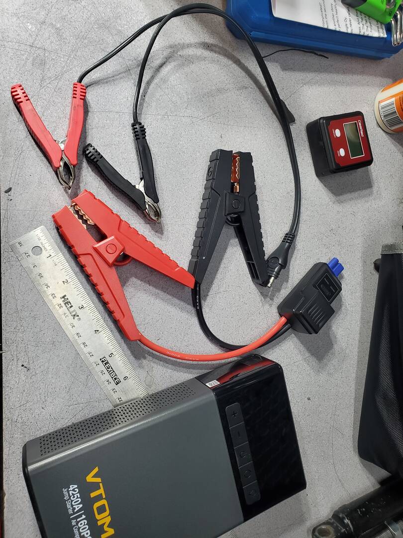

So about the VTOMAN X7/X5 that Drew posted. Are the battery clamps fairly large? On my 1500 Goldwing there is not much room to get to the battery to jump it. The terminals are kinda under the seat some what. I can barely get the small leads from a battery tender jr hooked up. I like the idea of a jump starter but won't do me any good if I can't hook it up.
I know this is a big ask. But does anyone have the VTOMAN and a battery tender lead they could do a size comparison? Thanks

Now here's where it gets tricky. If you slow down hot rod and re-read my post I'm talking about JUMPING the battery while it is in the bike. NOT charging it. Now here's where it gets REAL tricky because I could be wrong about this part. I believe the wires on the sae lead are too small for any kind of JUMP starting? Is that correct? Just low amp charging, right? So if I want to JUMP start the bike with this JUMPER BOX we are talking about I would need to connect the alligator clamps right onto the battery, hence my concern.

Here's a picture of the Battery Tender Jr leads next to the VTOMAN's leads.  Keep in mind this is the bigger version but they are likely the same size as the smaller version.
As others have said, you are probably best served by putting an SAE plug on the bike and adapting from there.
