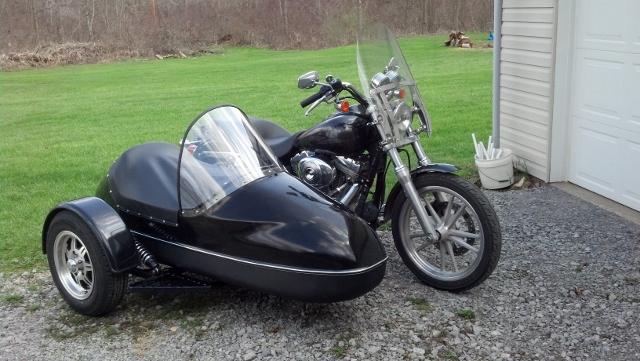

I just got my Super Glide / Texas ranger back from Bob at the Warkshop, He did a fine job on the install and I am pleased. I bought my first sidecar, a Velorex from Bob in 2002.
I bought the Texas from him also. He says i have the Honor of being the first to buy two sidecars from him. That was kinda neat. I cannot recommend Bob enough. He is easy to deal with and very knowledgable.

Very nice outfit there Bill. I've only visited with Bob via email and he seems just as you describe.
I suggest investigating "raked" triple trees. Our former Sportster Ranger rig was a great combination after lowering the gearing 4% and installed 5-degree triple trees. I also settled into 25lbs of permanent ballast in the Ranger.
Looking forward to more pics and stories from the road.

Nice looking set-up Bill..!! I talked to Bob a couple of times over the phone and although I didn't purchase anything from him, he was very helpful and gave me lots of pointers and ideas on my project.
