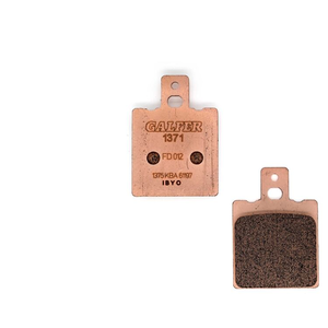

Posts: 620
A pad that's similar to the EBC FA47 is the Galfer FD012.  Very common one-piston pad.  Might be what you're looking for.
Galfer FD012

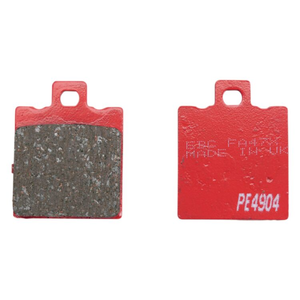

EBC FA47

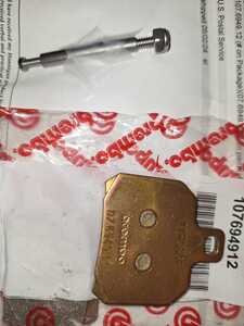

(@smitty901)
Posts: 801
20240508 141209[1]
I have a new set of correct pads on hand now and a pin. But Pin came with out the retainer . Think I can make one. Just a lot of BS just to get a caliper part. They act like it is a top secret part.
As you can see the pads are a different shape than the one shown above.

(@2FLTC)
Posts: 310
That sure looks like the FA266 pad.
Posted : May 9, 2024 7:17 am
(@smitty901)
Posts: 801
@2FLTC FA 266 will fit this caliper.
This is what you get from Bremo and then dealers have no clue without a Year model make of the bike and will not even try for caliper parts.
Like the pin
Screenshot 2024 05 09 at 07 28 12 Information request
Posted : May 9, 2024 7:31 am
sheath reacted
Posts: 1517
Well...dang it...we all tried to help Scared , but in the end you do now have the brake pads that will work with the caliper you have.

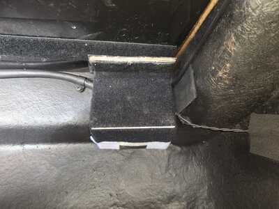

(@smitty901)
Posts: 801
This is no longer a Rabbit hole. But a Wood chuck tunnel. We pack at lot of stuff in the trunk and wheel chair parts it scuffs up things.
Made new cover for wiring. Coated inside with rubberized  truck bed liner.
  Replacing wore out Velcro that hold carpet down.
20240511 110456[1]
Posted : May 11, 2024 11:55 am
