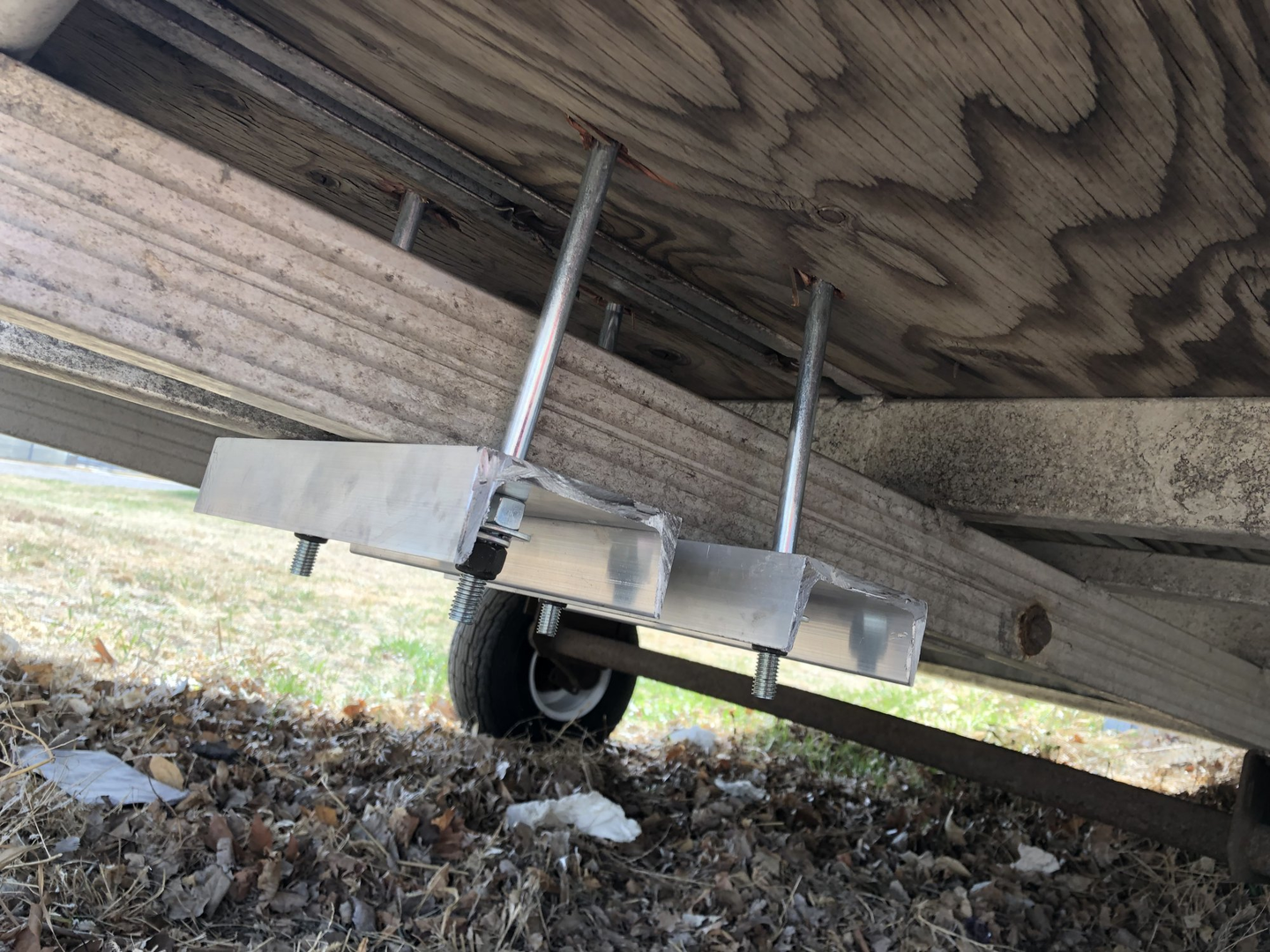

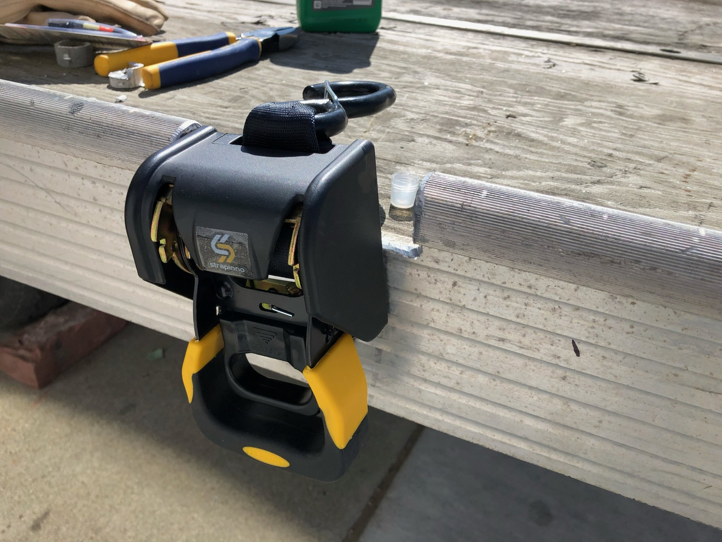

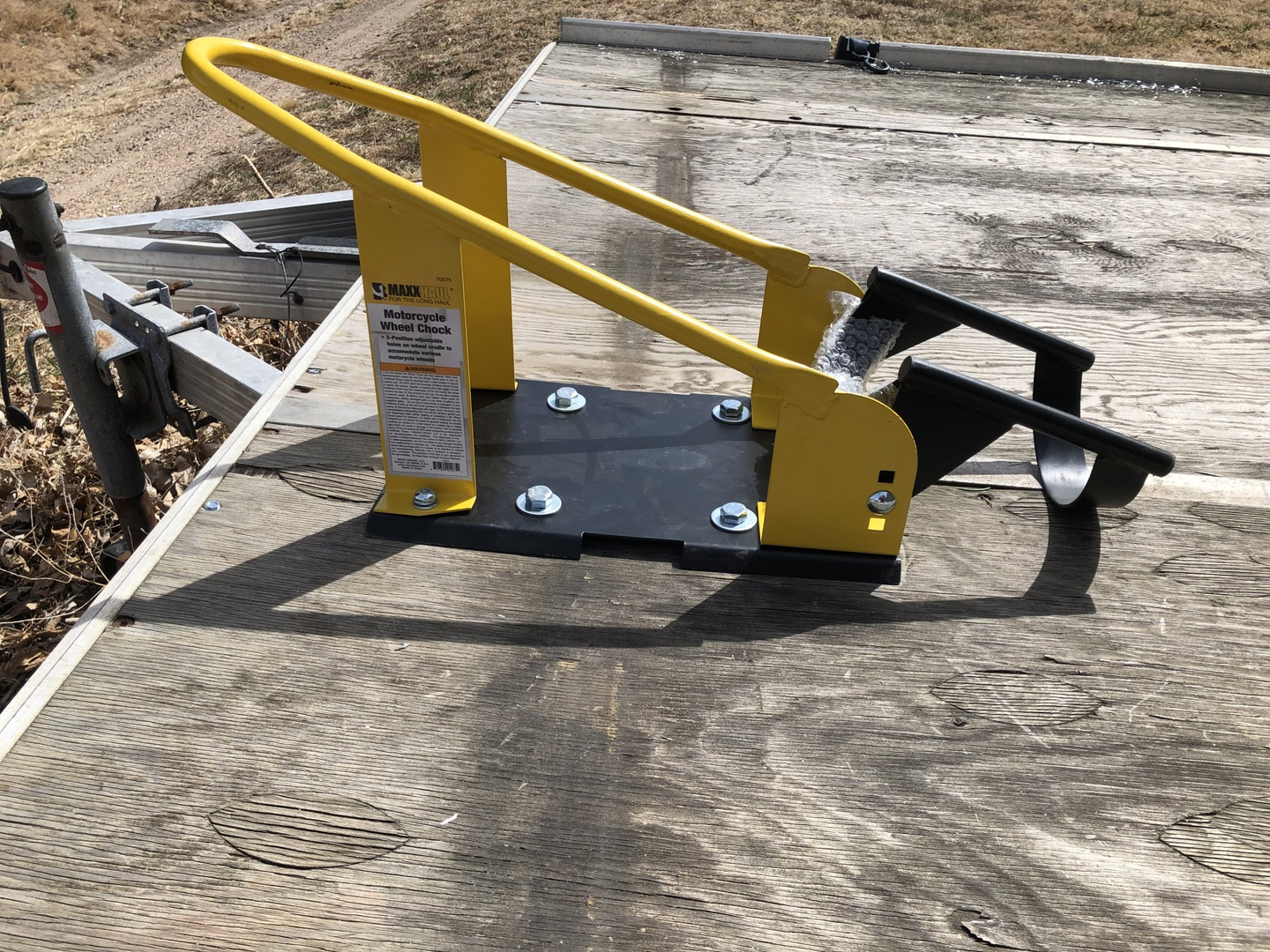

Posts: 1047
The thing I like about those types of wheel chocks is that it locks the front wheel in place quickly and easily and keeps the bike/rig from rolling backwards.
With most trailers, one would mount this in the center or equally distant from both sides for two bikes.  for a sidecar rig, you'll want to mount it so that the weight isn't too much to one side of the trailer, causing imbalance and fishtailing by the trailer.  Hopefully there is some structure under the trailer that the bolts can have maximum strength.
When I added that kind of chock to my deck-over trailer, I added two U channel beams underneath as mounting points since there wasn't any structure under that region.  I also added four of something like these to the sides to make securing the rig a 4 minute process instead of a 20 minute guessing game since I rarely had anyone able to assist with tying down or releasing.

Posts: 1858
Posted by: @thane-lewis
El Presidente', the deck of the BearTrack trailer is sufficient to hold the wheel chock. I drilled 4 holes through the deck, then used large fender washers on the underside to distribute the attachment force of the bolts.

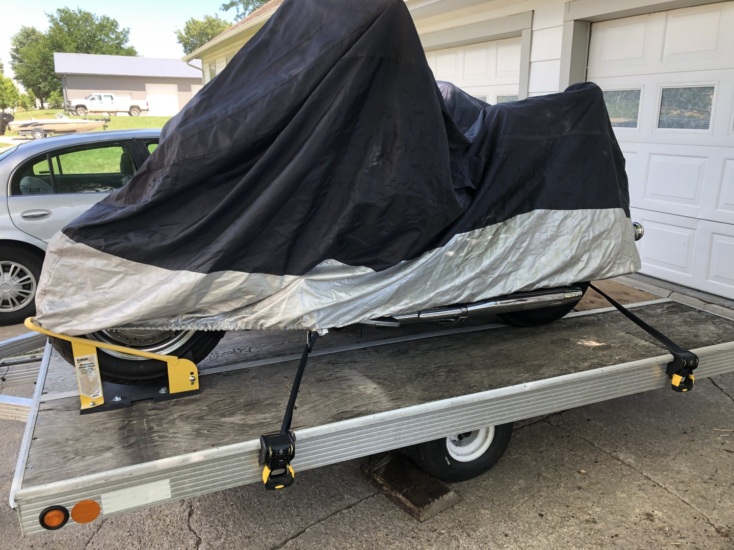

Posts: 1047
Ratchets:
Ratchets holding rig:
Chock supports:
Chock:
Link to build thread
Posted : December 2, 2025 3:44 pm
Ratchets:
Those ratchet straps are obligatory for Ronnie.         Can you imagine him trying to figure out how to use the traditional ones ?  Head Explody Head Explody Head Explody
