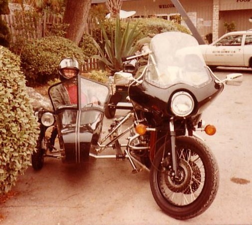

(@trikebldr)
Posts: 106
My first rig was a '76 'Wing with a Spyder sidecar. I made up a hitch much like the one on Tourist's rig. Seemed to tow just fine, but I did notice it more with heavy braking. Nothing to worry about though.
My next bike was a Kawasaki Voyager (Huge bike!), and I made up a hitch for it to pull the same trailer directly behind the bike. The trailer was only about 4" wider to the left than the bike's fairing. Not hard at all to get used to, but it never had any lateral effect on braking or acceleration.
