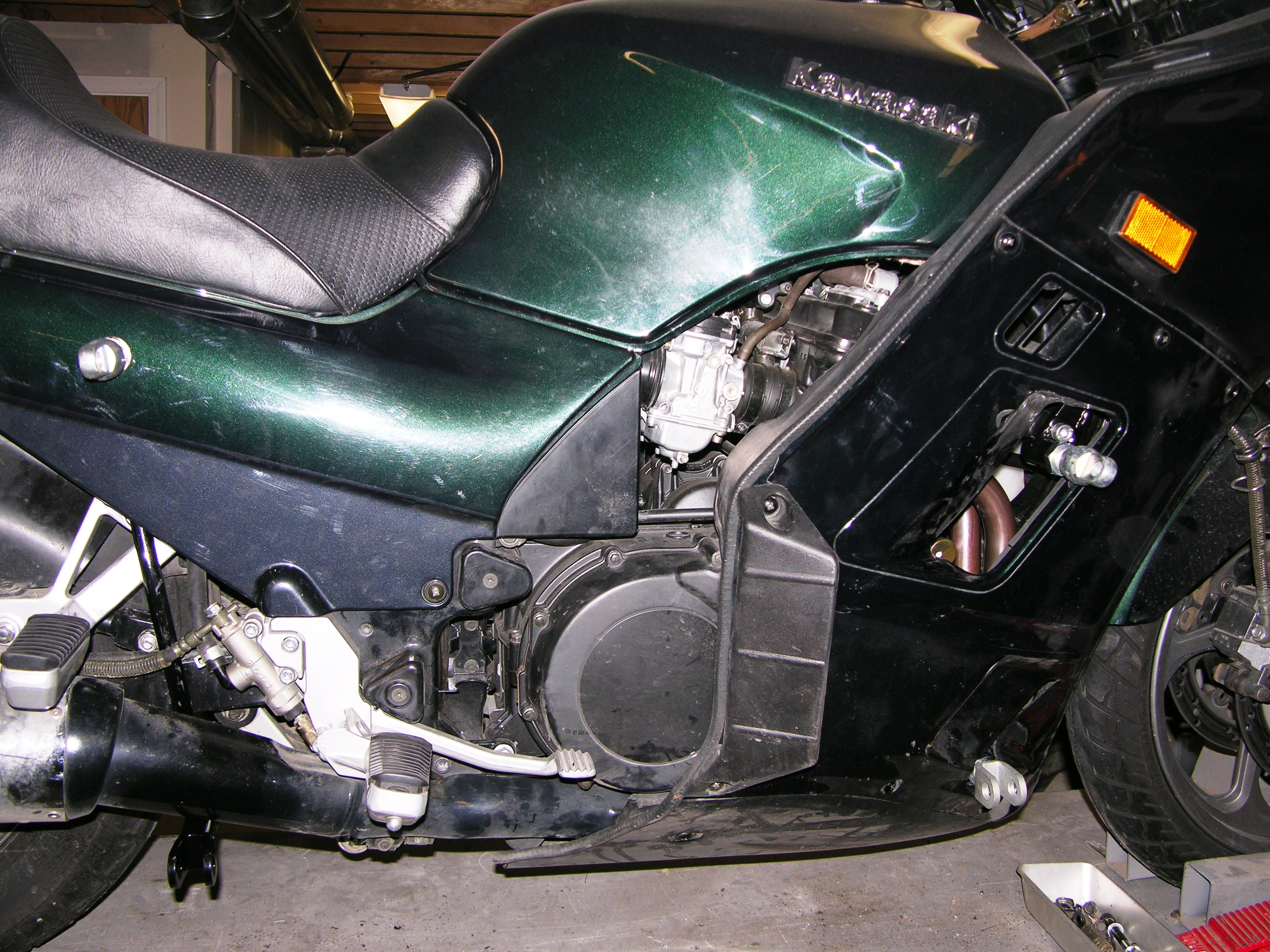

The Plan is to use my Kawasaki C10 (concours) for the tug. Jay at DMC will fab up a subframe for me when I get that far along(thanks Jay)

It has been suggested I find a different tug but I like the C10 and it is relatively easy for me to work on

Welcome David, a good tug is any bike you like and are comfortable working on. If it fits you, go with it.
The C10 has the power to pull a large chair as fast as you are willing to go.

Was there a reason given to support not using your Concours? I'm not that familiar with the bike but at first blush it seems to be an ideal tug.
Posted : June 29, 2016 3:29 am
The Concours works well however we do not offer any kind of steering modifications for it. I owned one years ago with a sidecar made by another USA company held on with clamps that they had the previous owner drill through the clamps and the frame and cross bolt them to keep them from slipping. Not some thing we would ever do.

No particular reason other than keeping the C10 for two wheel duty Maybe using an older GL for the tug

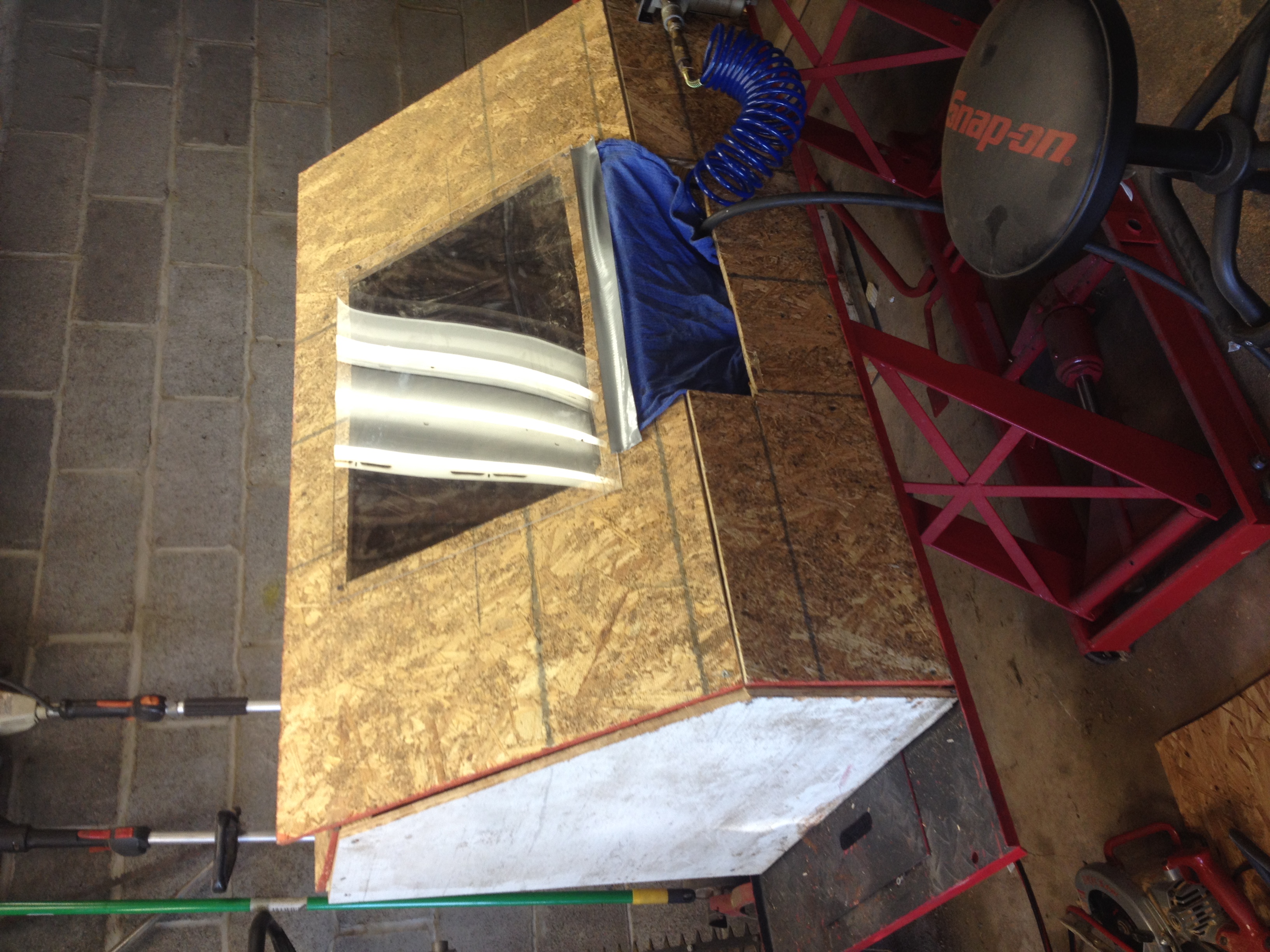

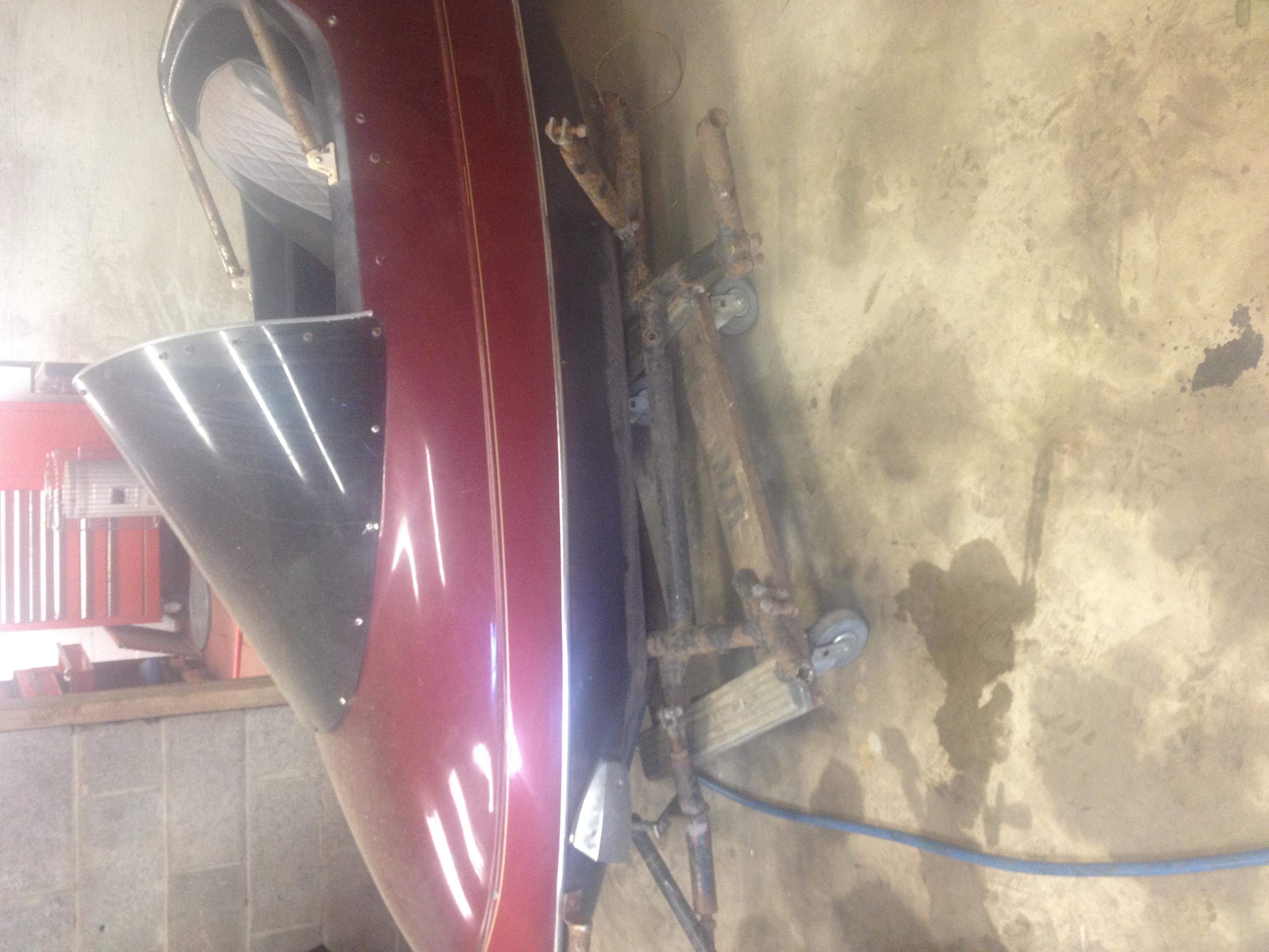

Well Im back Got distracted with some major projects around the house But I have made some progress the past couple of months Ive disassembled the sidecar got the frame and hard parts cleaned primed and coated with bed liner Jay has sent my mounts Should be here soon New bearings all around just to remove the unknown factor from things
I knew this chair was in bad shape but I am committed to it now that I am on the down hill side as far as finding all the bad
Box is my home made blasting cabinet I made to clean the frame and other parts
