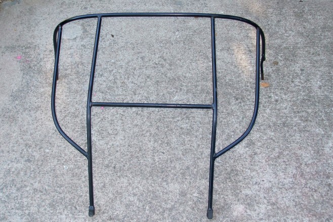

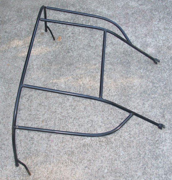

 VLAD
(@vlad)
Posts: 451
Some pictures.
Posted : December 15, 2015 9:21 am

(@Tourist)
Posts: 49
Vlad, I appreciate your post with photos, but I already have a convertible top and frame in good condition. I guess what I was looking for is just a frameless cover that would snap on in minute or so,in the event of a sudden shower or thunderstorm. Don't even know if one was available years ago. Something akin to what I had for my MG Midget back in the day. Thanks for replying.
