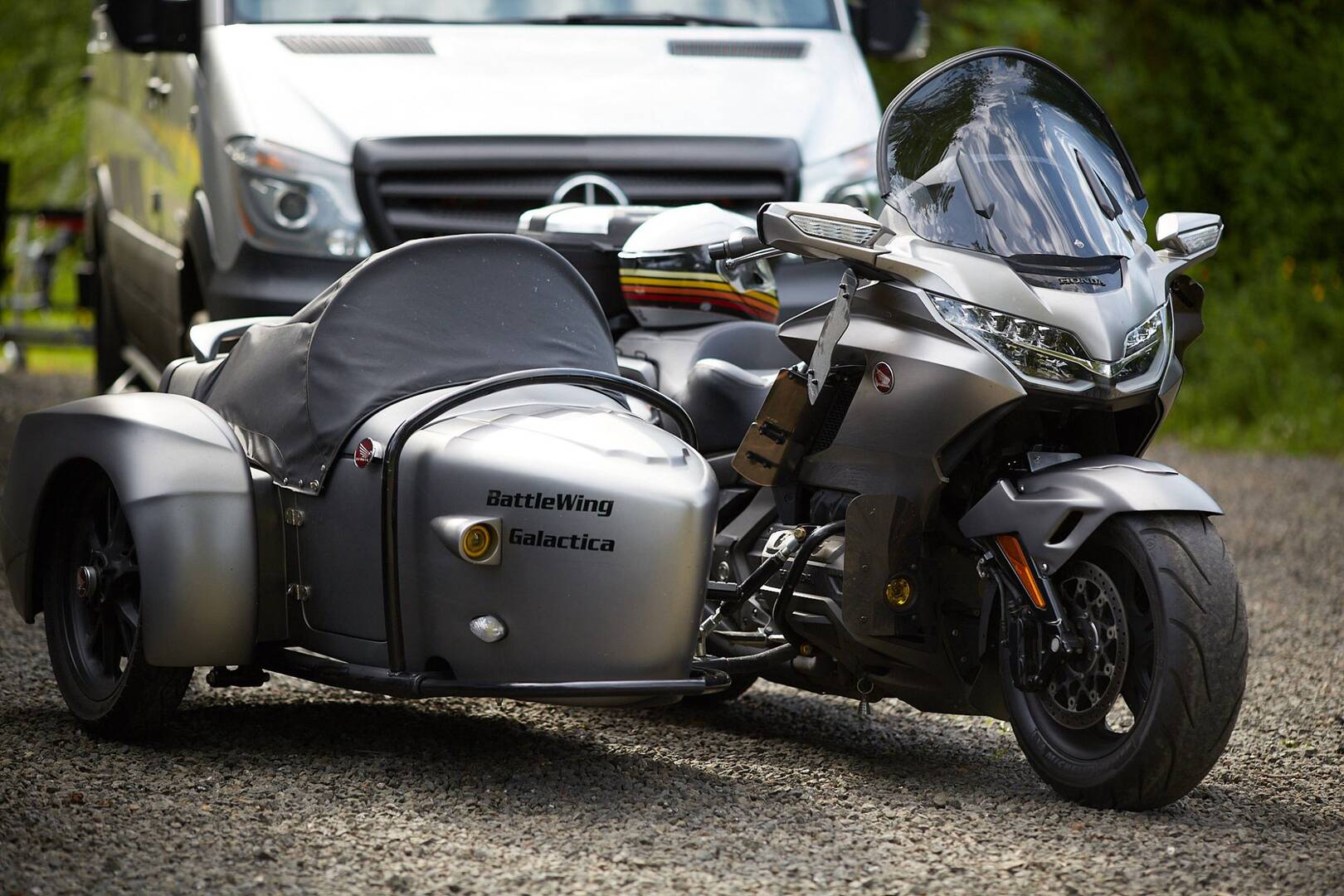

BTW, that California Friendship ll is a relatively light sidecar in todays sidecar world, as a lot of us have much, much heavier siders, by choice.
20230520 lbs open house 17 goodman
