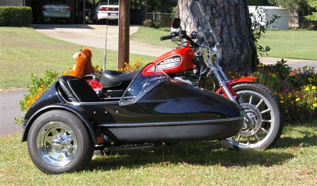

We are well pleased with our Texas Ranger mounted on our '02 883R Sportster. Attached is a photo for a look-see. While looking around the 'net on a rainy day, I see a slightly used Texas sidecar for sale over in Southern Alabama:

Swampy Hey:
That is a great-lookin' combo. The windshield is just right. Very nice lines.
Leo

Thanks so much for all the suggestions... Lee, I like the Texas Ranger on your Sportie and agree with Richard, the windshield/screen is spot on. If anyone else has experience/pics with Sportsters, any info is appreciated. I hope to talk to the local shop Richard uses in or area and start there.

Credit for the windshield goes to Bob & Deb at Texas Sidecars. Jena didn't like looking thru the "stock" windshield so Bob & Deb suggested the shorter shield. Jena now looks over the shield; it works great with her helmet w/face shield as airflow is out of her eyes but across the top of her helmet, sorta like an Indy car.
But we haven't yet progessed to a cool paint scheme like Leo's rig.

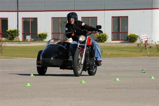

BTW, Beth: The wide handlebar & mid-controls of the Nightster work well for sidecar use.
Attached is another view of our rig from our S/TEP class a few weeks ago. IIRC, this is the pass where I would have crashed the sidecar into the SUV represented by the cones. Glad it happened on the range rather than the road.
