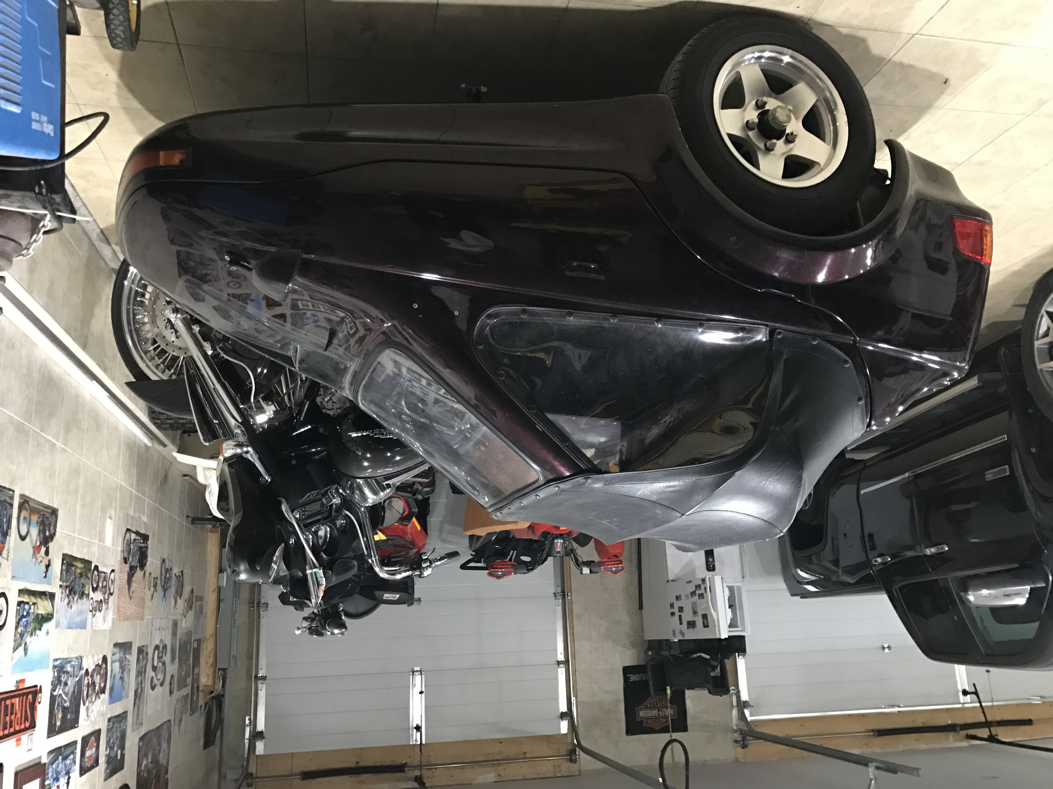

i will try to post pictures .it doesnt look too bad

minor damage to the back of the sidecar

now that i got it in front of me it doesnt look too bad.but regardless it will get sold because i bought another one. when i got the print out it sounded like it had been really badly damaged .but i dont know if the frame is racked.i got the estimate before i got the bike back.
Posted : October 5, 2012 9:04 am
(@horrorguy)
Posts: 285
guess i will sawzall off the crash bar and take it out in the neighborhood for a ride to see how it feels .they listed a new frame on the estimate.

I think they do that almost all the time just to cover themselves. I've seen many bikes totaled by the Ins Co's and the frames are fine. One give away on the newer ones is the powder coat will show stess or cracking by the neck or down tubes.

The shop estimators will call for a new frame if the paint has been damaged, since a new one comes with a new unmarked finish.
If the bike track is awry and can't be brought in alignment with a rear axle adjustment it could be due to the frame, swing-arm or front fork tubes being damaged.
This looks like minor damage, mostly cosmetic.

Is the frame bent? if not it does not look all that bad. Are you going to fix it or sell it?
