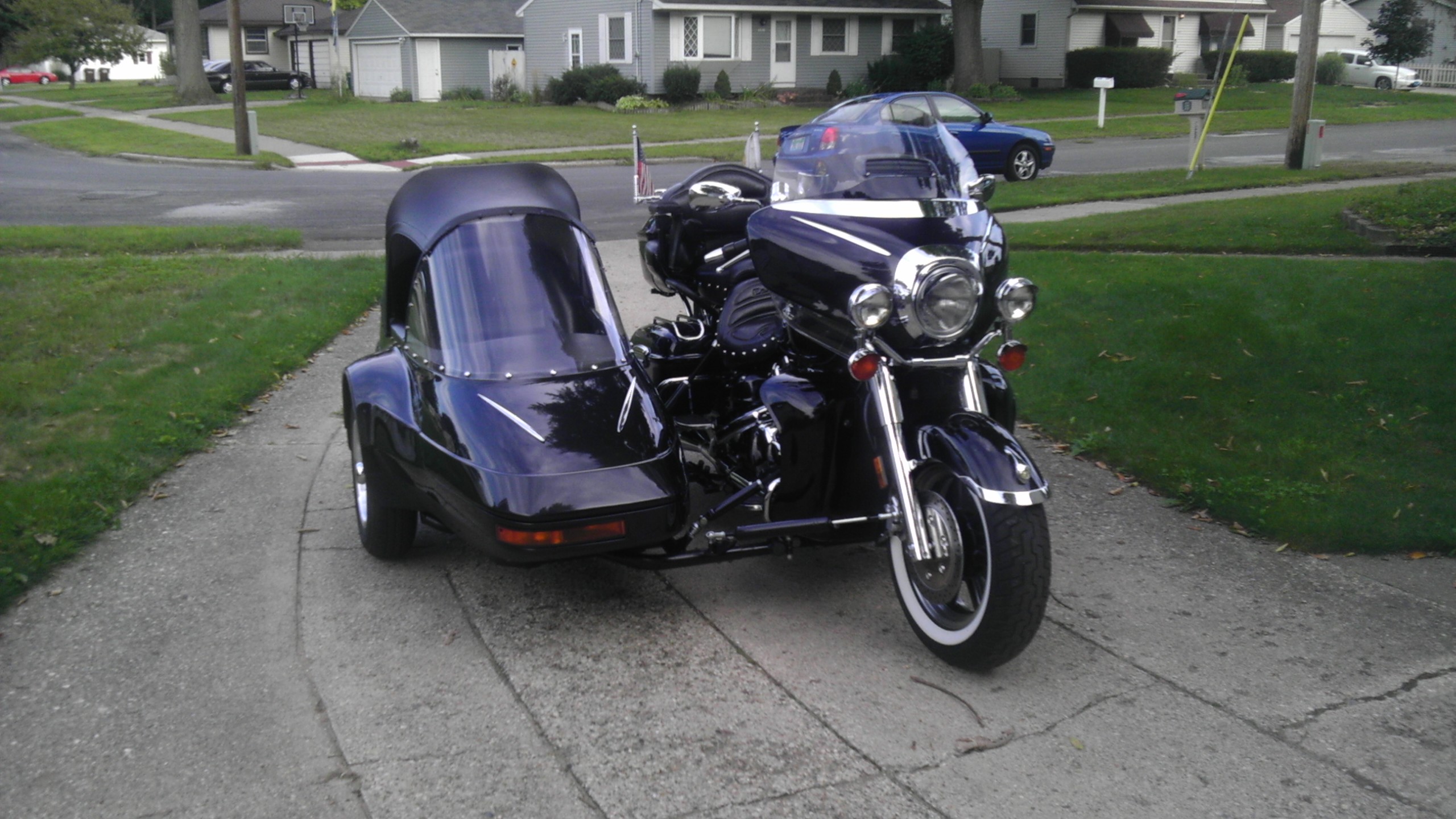

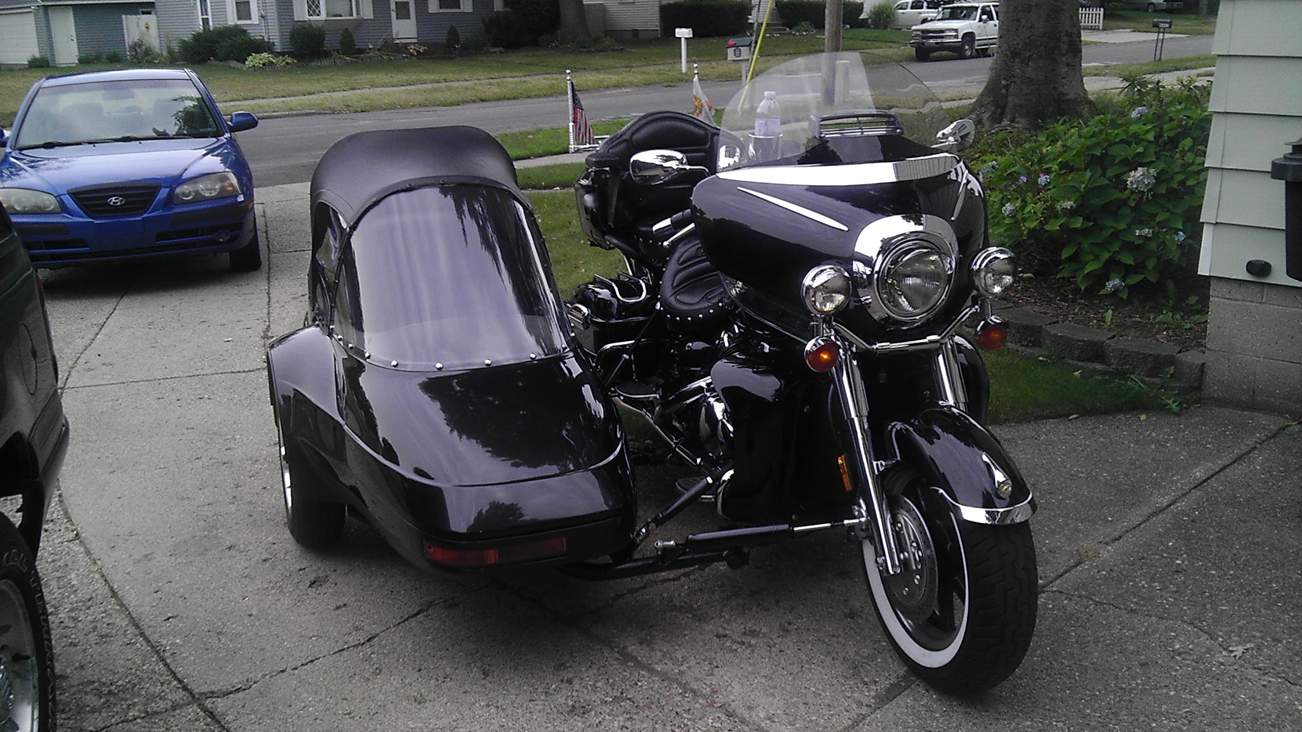

Hello everyone, I have been lurking around here for 2 years with the anticipation of acquiring a sidecar rig so my son can ride with my wife and me. I looked at many different options and asked a few questions along the way. My final decision was to add a sidecar to my 2004 Yamaha Venture and keep it attached all the time.
I purchased a Champion Escort earlier this year and have been leisurely mounting the sidecar ever since. My son is still too little to ride, but I wanted to spend some time learning to drive before he started to ride with me. I have been learning many things along the way. One is that I am not that good at setting up a rig. I changed the setup about 6 times before I was happy with it. I have logged about 1000 miles with the rig and no passengers. I started feeling comfortable with it and I can see why so many of you enjoy traveling this way.
I live in a residential neighborhood and I can travel many roads within a square mile without using a main road (25MPH). I took my wife and son for a ride the other day and he loved it. He is not a big fan of his helmet, but he put up with it and was smiling and laughing the entire time as long as we were moving.
The next thing I learned was not motorcycle related, but I thought I would share my new knowledge so you don’t make the same mistake. When your wife climbs aboard the motorcycle, there are many things you can say. What I choose to say was “ WOW, I didn’t think the suspension would drop that much”. I am still paying for that one.
So I changed the setup again based on both of us riding it. I am going to lower the air ride suspension when I ride alone and keep it at max when we ride together. We are going to wait until spring before we venture out further with my son because his helmet is a little too big for him.

My new setup is the best so far. I set the rear air shock at 57psi (max) and loaded the bike as if my wife and I were riding. Then I set the sidecar from that. I road it without passengers and lowered the rear air t0 20psi. With acceleration=0 the steering was neutral most of the time and pulled very little at expressway speeds. I will try riding with my wife and son soon, but we still won’t be going faster than 25mph. I set the toe-in at 1.25” and after reading the most recent post from Lonnie, that may be too much. If/when I adjust it again I may decrease the toe-in.
Thanks for the kind words from everyone.
