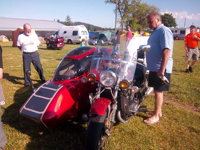

A Canadian guy I met years ago runs a homebuilt sidecar that is very professionally done. It was white when we met at a UMCI rally those years ago. He and his wife came to the National in C d'A. They're still running the same rig but it's been repainted... I'll post it here.
Posted : August 22, 2012 3:41 pm
I dig that Tom, do you by chance have more pics of that side car?
Posted : August 22, 2012 6:55 pm
I'll send you a PM with the guy's name and e-address. He's not in that photo btw...
