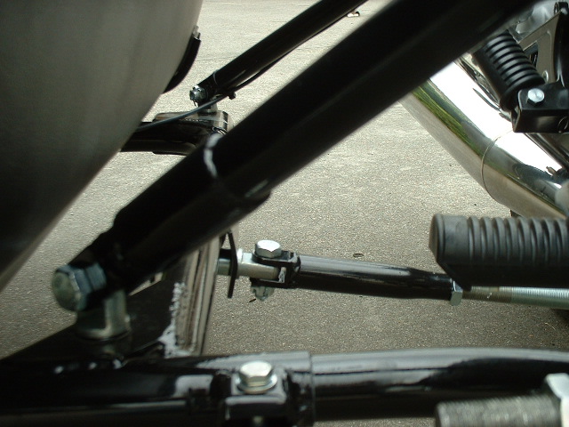

Since the Cozy sidecars use the Velorex Universal mounting set the instructions shown from Cyclesidecar.com are taken from the Velorex Handbook and like the Velorex handbook the placement position of the rear sliding mount and strut is flawed.
The positioning shown has a tendency to slip and rotate on the frame tube of the sidecar (which has caused many complaints from Velorex owners through the years).
This strut should be mounted in a straight line at 90 degrees to the bike but NOT at 90 degrees from the clamp.
The strut should be mounted as shown here. It can be above or below the sidecar frame for the most level placement.

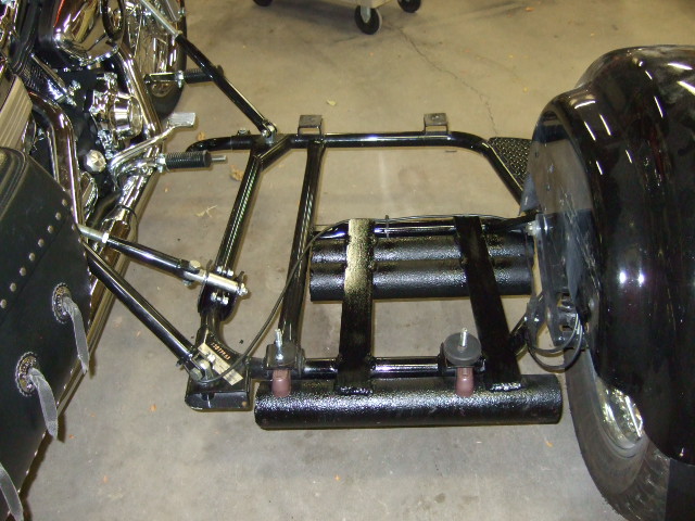

One that 2nd jpg : - 2007..MSV... .0016.. What are those tubes running across the frame? ballast? Just curious..
Thanks, gail
Posted : April 4, 2009 5:55 am
They are 3" steel rod stock lengths used for ballast.
Posted : April 4, 2009 8:10 am
