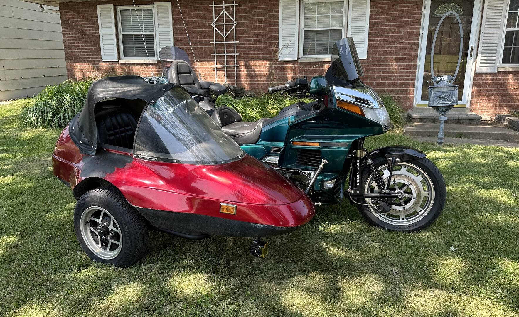

I finally got this pig done!!  Just thought I'd share my initial impressions.
There are no wobbles at any speed. Not even when taking off or at 35mph. I could take my hands off the bars at any speed if I wanted to. But I just loosely let go of them and no head shake.
I do get a pull to the right under acceleration, and a pull to the left while braking. This can be changed with the lean angle, speed, and how hard I accelerate. I guess this is normal?
I know nothing about handling,,,lol. It seems to ride ok. I guess I'll just leave all the shock settings as is and hopefully I can get a volunteer at Flint Hills to ride it and say it's ok, or it's crap.
I LOVE the low speed ease of turning. I can turn this thing on a dime. Well left hand turns that is. I'm still too nervous to take a right hander very fast in fear of flying the chair,,,lol.  Maybe with time. I did pull into a big parking lot and do a slow speed very tight right hand turn just to see if it would lift. It did. Scared me a little. But at least I was expecting it.
Out on the highway at 65mph I can't say I love it. It is VERY responsive. Too easy to turn. I can see swerving to miss something and something bad happen? I don't know. What would happen? Could you flip the rig? Would you guys recommend a steering damper just to slow the responsiveness down? Or is that just counter productive?
My brakes are crap. They are very spongy. I put new oem pads on both sides of the front and installed speed bleeders. I bled the hell out of the front and rear.  I do seem to have ok stopping power on just the front hand brake. But I'm not happy with the rear. I guess I need to swap out the lines to stainless steel line? I know I can tie the lever down overnight and it firms it up.

Posts: 1516
Calvin,  Caretaker of Sidecar Willie....the handling, braking,  accelerating....all sounds  correct and  normal.
Good on you for  a successful  installation of  that  Leading Link,  and....for the  wise decision of  which  battles to  choose to  fight, regarding the  bad tire shop.
Yes, it would  appear to  most  people that  the sidecar  tire  should have the  valvestem pointing to the  RIGHT, but the Shrek-man @thane-lewis is just naturally  backwards,  so don't  think that  he  read your  post  wrong.....it's  Shrek being a  Shrek.
Question: specifically,  what tire pressures are you  running in  each of the  3 tires ????????????????????

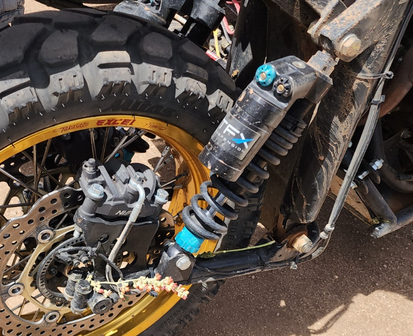

My thoughts for what they are worth:
Use preload to set the sag correctly, not adjust for ride.  Set it to where about 30% of possible wheel travel is compressed with the bike sitting still, on front, rear, and hack wheel.  If this is not possible within the range of preload, consider swapping heavier (or lighter) spring rate springs to achieve this.  So if total possible wheel travel is 6 inches, resting, loaded sag with you on the rig should be maybe 2 to 2.25".  (I am on my third set of springs on the LL's, and finally feel like I have it dialed in to perfection.)
If the shocks offer damping adjustments (Compression and Rebound) maybe lighten up the compression damping a bit (less damping, turn screw out a few clicks) ride and see what you think.
What shocks are on the LL?  Do they offer any adjustments other than preload?
Just for a frame of reference, this shock has an "H" screw at the top of the reservoir for high speed compression damping (sharp hits like rocks and stuff) and "L" screw for low speed damping (stuff like waves in the road, dips, etc.) and a blue collar at the bottom for rebound damping (how fast the wheel can drop down into a pot hole or return to the road after a hit on a rock or something.)
It also has a collar that can spin to change pre-load on the springs for setting sag.
My goal has been to get about 30% sag with me on the rig and the junk I usually carry in the hack AND have the rig level at this setting.  I typically put a digital angle finder on a horizontal frame rail to check this.
I have fooled with the damping quite a bit to get it dialed in for the compromise between dirt and pavement that I do.  Soft for rougher stuff, firmer for twisty pavement.  There seems to be a sweet spot for each setting that is a good compromise position that I don't have to adjust to go from one type of riding to the other.  If I am going to spend the day on one type of riding exclusively, I might shift the HS compression damping up or down a few clicks accordingly, but generally just leave it alone, these days.
