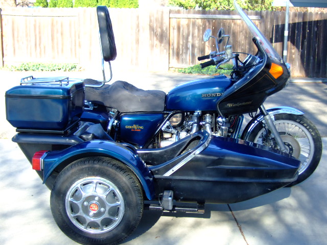

Here are a couple of shots of my '82 Goldwing configured close to what you describe, saddle bags, no trunk and only a stubby, blanked out windscreen.
Posted : April 27, 2014 8:49 am

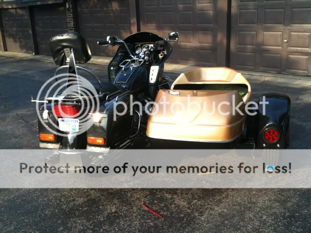

Here's a "77 GL/ Hitchhiker rig we sold recently. And a Kaw Police bike with an early Velorex from back when.
The Kaw hack was later given upgraded wheel, tire and suspension.
Posted : April 27, 2014 4:02 pm

Thanks guys. I am grateful for the pictures
