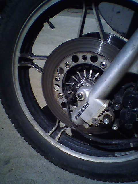

The outfit will stay a permanent outfit as I have a solo bike but for now I can't fork out on leading link. The original forks on the bike are poor and in need of a service same goes for the rear shocks. What can I do to improve the standard suspension for sidecar use? I was thinking static rate springs for the front at a 1kg rating? I have no idea with the rear shocks.
Any help would be appreciated.
I have some photos that I have from the bloke I bought the bike from.
Posted : August 8, 2007 3:09 pm
See if you can find some good used forks from a different model which will fit your bike. Look for forks which carry the axle in front of the forks instead of centered as shown in your photos. This should reduce the trail improving your steering at less cost than new links....

Reducing trail will ease steering problems.
If raising the fork tubes in the tripletrees to reduce trail as shown (see: Honda forks 1.jpg), be very sure there is adequate clearance for the front fender, radiator, or any other appertenance that may interfere with the steering when the front suspension is fully bottomed out.
Heavier viscosity fork oil and fork spring spacers (1" PVC?) can help eliminate front end dive.
Snug up the steering head bearings a bit to eliminate front end flop from side to side.
Wider handlebars reduce steering effort.
Lean the bike out from the sidecar a bit to eliminate the left pull. It will feel a bit odd at first (like you are leaning to the right) but the road crown will have you sitting more erect and just like the difference between steering instead of countersteering, you'll soon get used to it.

I'm not sure what your comfort level is with modifying your bike but other things that can be done to lessen the trail are:
1. Raise the forks in the triple clamp (already mentioned and shown).
2. Get leading axle fork tubes (already mentionedand shown).
3. Use a shorter aspect ratio front tire or swap to a smaller front wheel/tire combo. I think your GS has a 19" front wheel - going down to an 18, 17 or 16" wheel with the right tire will help with the trail- lots of people use car tires in the 16" size. If your GS has wire wheels, re-lacing a smaller rim might be a fairly cheap way to go. Approach cautiously, check tire and fender clearances (usually not a problem with shorter tires but check tobe sure).
4. Find, buy or fabricate triple clamps that put the fork tubes further forward.
5. Get some longer rear shocks to raise the rear end a little. Does the same thing that lowering the forks does on the front without the cleareance issues. On a BMW (not side car) that I road raced, I raised the rear by fabbing new mounting points for the upper shock mount. It was (in my case your bike may be harder) an easy and cheap way to quicken the steering and get a little extra ground clearance and stiffen the feel of the rear.
Being that I'm new to sidecars - I'm not necessarily suggestng these things but thought I'd throw them out for discussion.
