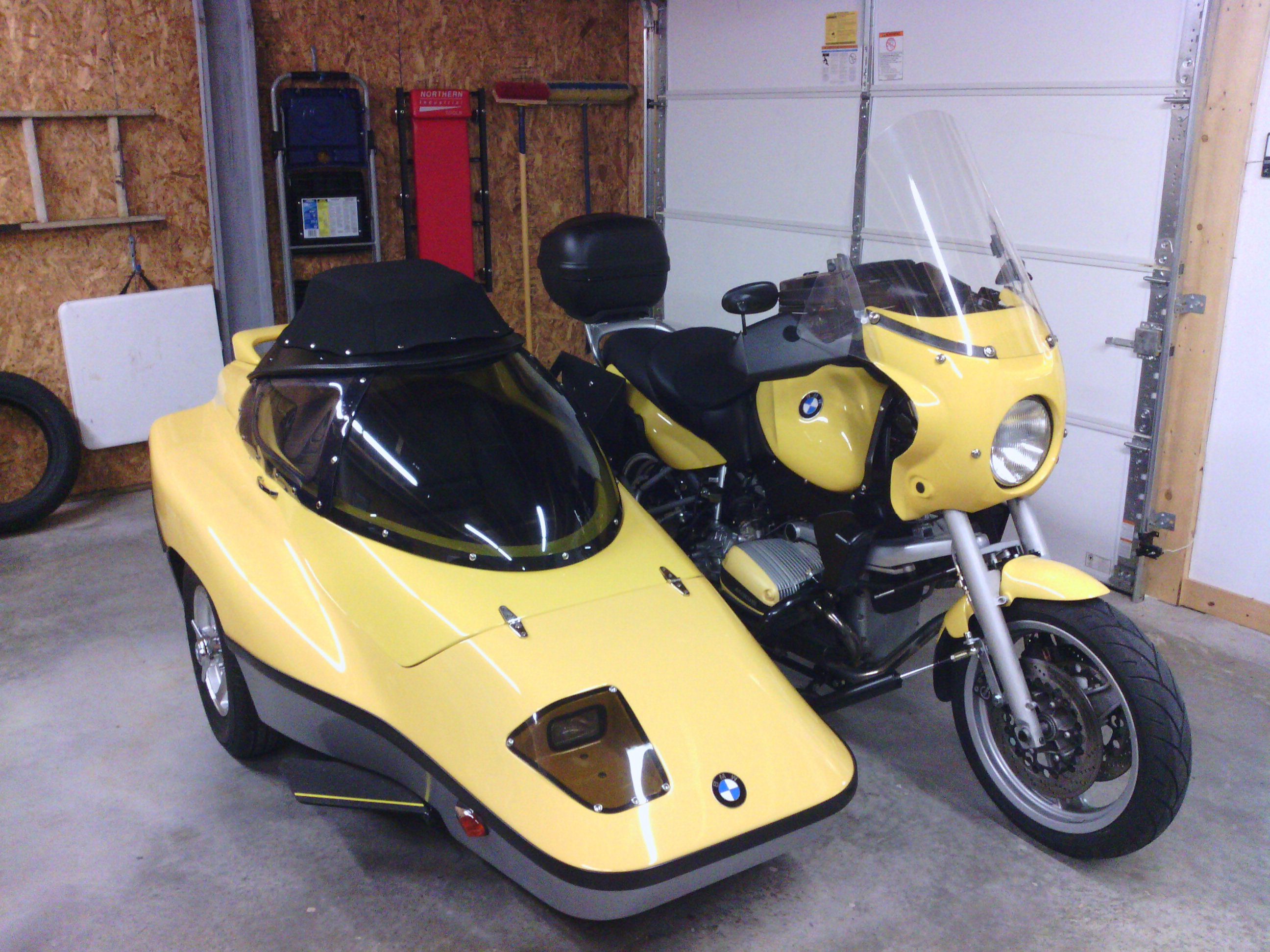

Well it is finally on the road. I have been working on this project for about 4 months. Have been collecting parts for approximately two years.
Tug - 98 BMW R1100r
Tub - Hannigan Astro Sport
Modifications - automotive rear tire from Claude Stanley -steering mod from DMC - tub mods of raised top, side windows and curtains by me
Changed spring on sidecar to 200/350 - still waiting on new custom Hagon shocks.

Nice work, nice color, nice rig, well done!

Thanks, trying to improve on previous rig, however that will be hard. Have put about 25000 on Vulcan/Hannigan rig and have been very pleased. Did not modify steering so it was a handful in the twisties, but a great highway rig.

Did not have any head shake but put damper on because it felt too easy, probably because i was used to other rig

Think of the steering damper as life insurance.

I replaced the stock steering damper with an adjustable universal one and it was all i needed.(Shindy was the brand) Have since installed a 3.36 final drive from an r850r and is was a huge improvement as were the Hagon shocks. Ready for spring and some camping!

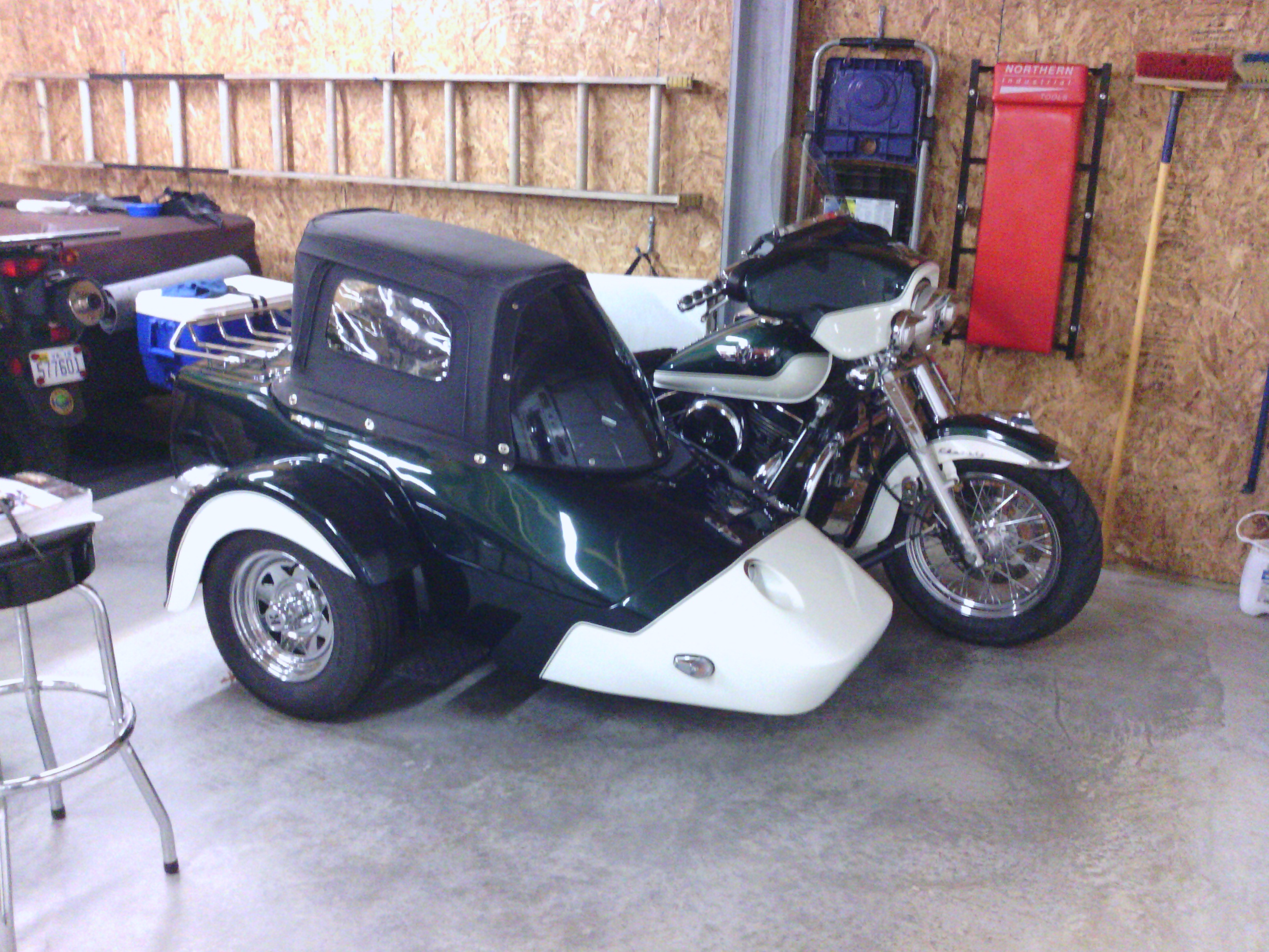

Posted : February 23, 2013 10:51 am

(@draperg1)
Posts: 157
Thanks for the kind words. Took a good ride yesterday with my monkey and got a favorable report (the only one that counts by the way) Once I get the auxiliary gas tank installed I will be ready for a long ride.. Some good weather would be nice too! 🙂
Posted : February 25, 2013 2:26 pm
