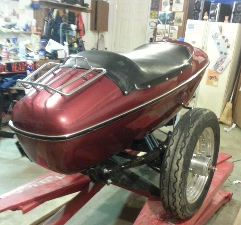

Hello all, I just bought a Harley sidecar for my 1983 FLH and am learning to ride all over again. I've owned my FL since new so thats a lot of riding without a hack. It was painted yellow so hence the name my friends gave it......I'm looking into installing brakes on it (it came with none) if I can find a source..It has a drum with nothing in it right now.

is the drum empty? or is the backing plate entirely missing? brake lines gone? does it still have its wiring harness for the brake/running light and the turn signal?
i have a disk brake sidecar, im way happy with it but i missed out on a drum brake sidecar just before i got the one i have. disk brake ones are easier to aline - but the drum brakes are more retro and work just fine

It has the back plate, drum and wheel cylinder. Just needs the shoes and springs I think.............I'm not sure what shape the the wheel cylinder is in, it most likely will need to be rebuilt or replaced...I'd love to have a disc brake, they work a lot better as well................

I didnt want a Yellow submarine so now it's Red October.......LOL

looks like a custom wheel of some sort......
the brake cyls are avail, so are rebuild kits - basically its a standard harley juice brake setup...
part numbers are late 50's to early 60's and were still being installed new right till they went to disk brakes. and ill be a buc that the drum brake parts will be available longer than the disk brake parts will be since there are at least 50 drum brakes for every disk brake built [harley sidecar disk brakes are unique to sidecars - the drum brakes are the same front back and side.
also on that vintage bike you can get a adjustable tree that has a bolt you change position of for sidecar steering or bike steering. they also made a headlight adjuster ring that bolts right on. both work real slick and the raked tree makes them handle very very well. best of all its all stock.
if the bike is a 4 speed there is a cast in space for reverse in the trans case - but the internals for reverse are VERY VERY hard to find.

Thats good info guys, thanks for the help........I think I'm going to get a new wheel cyl. if thats the case, I'd rather go new then rebuilt anyway. Im going to keep looking for a front 16 spoke mag for it and make it fit one way or the other......
