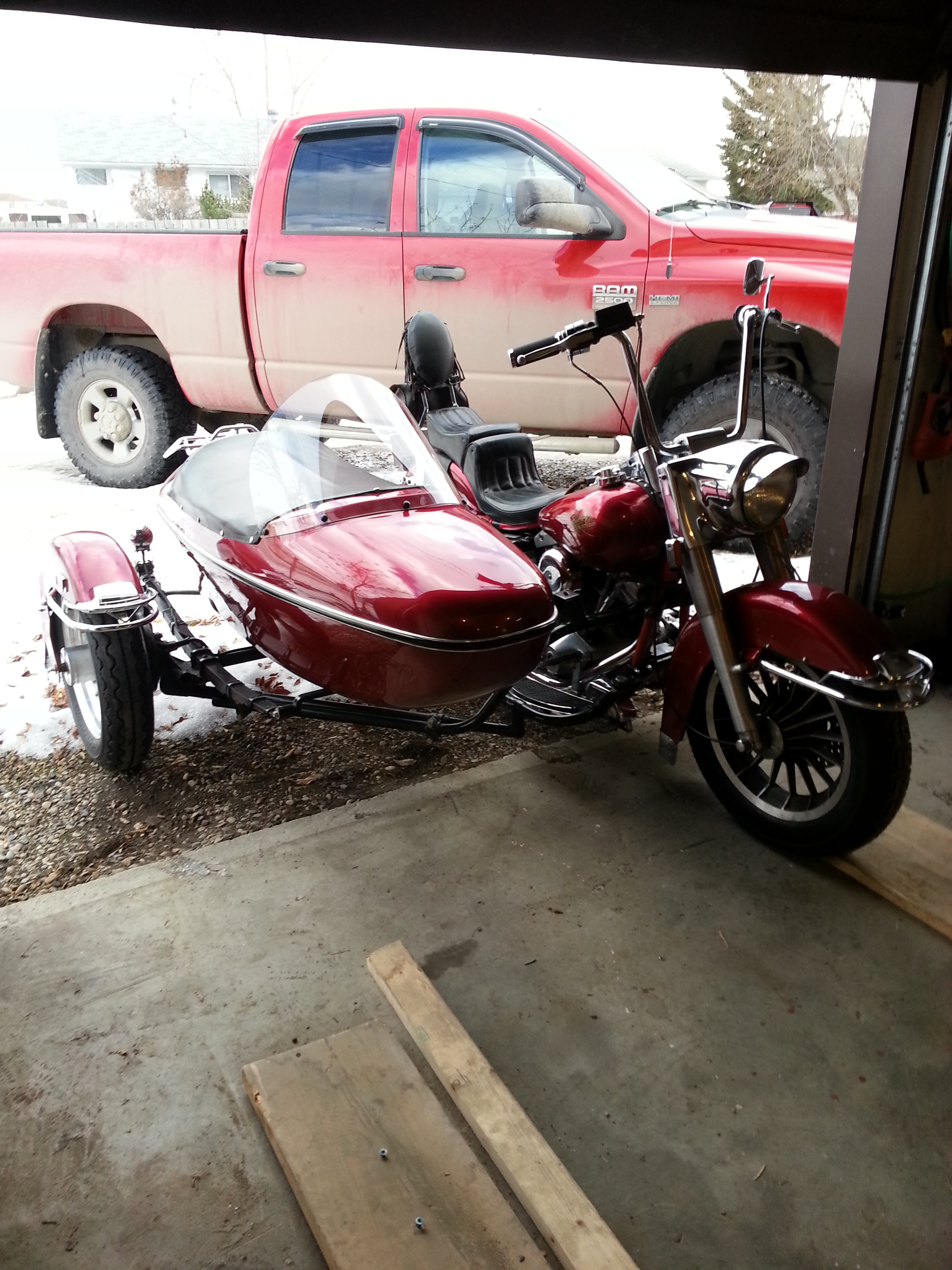

Your lucky, your colors work and look good together......Yellow was a bit to bright for me next to my Red bike..

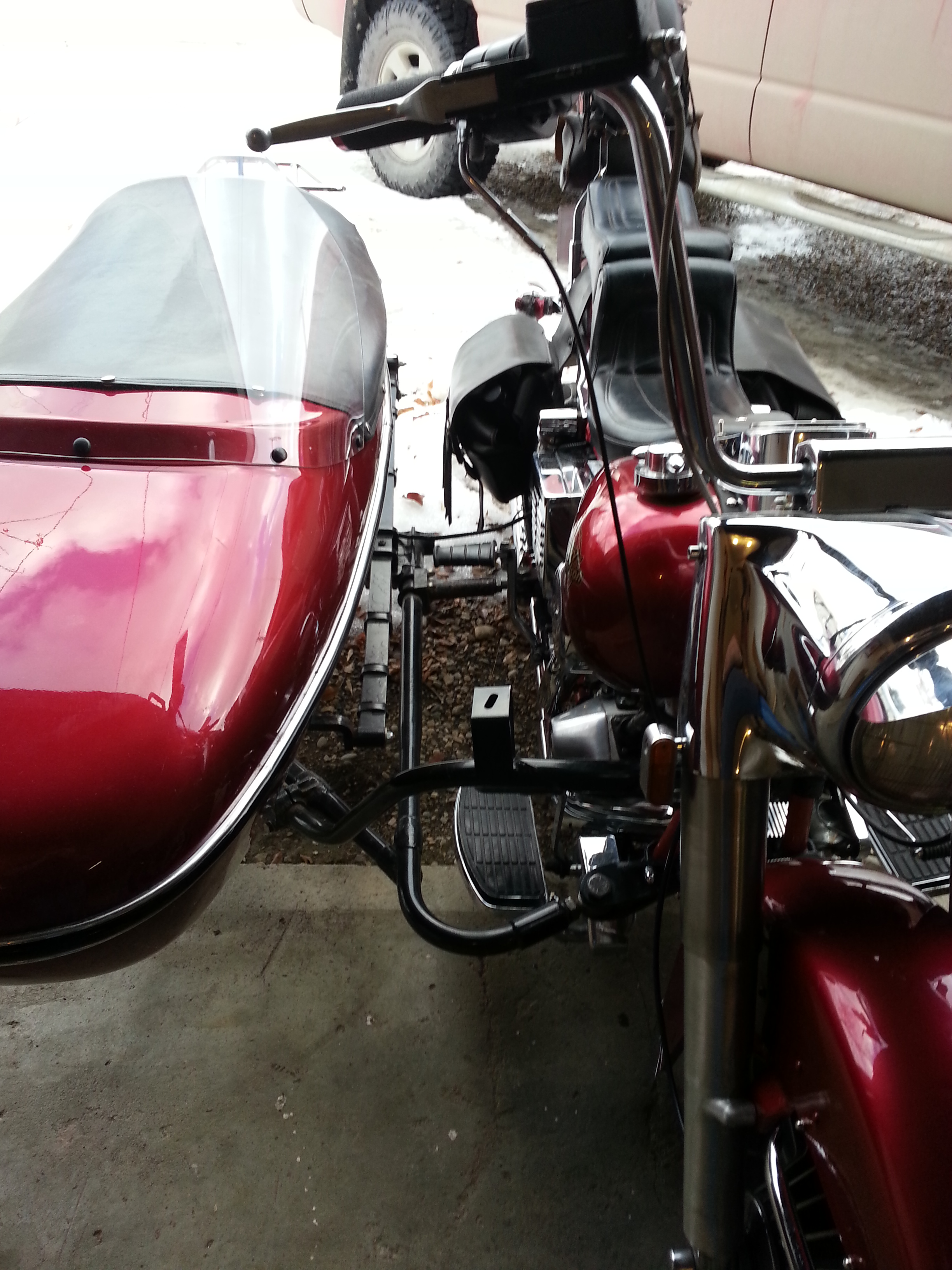

I had the hack wired and ready to reinstall on the bike when I noticed the tire was flat, so off it came and off to the tire shop......
I must say I'm impressed with my new matching fenders, I blinged them both the same.....pics coming soon..

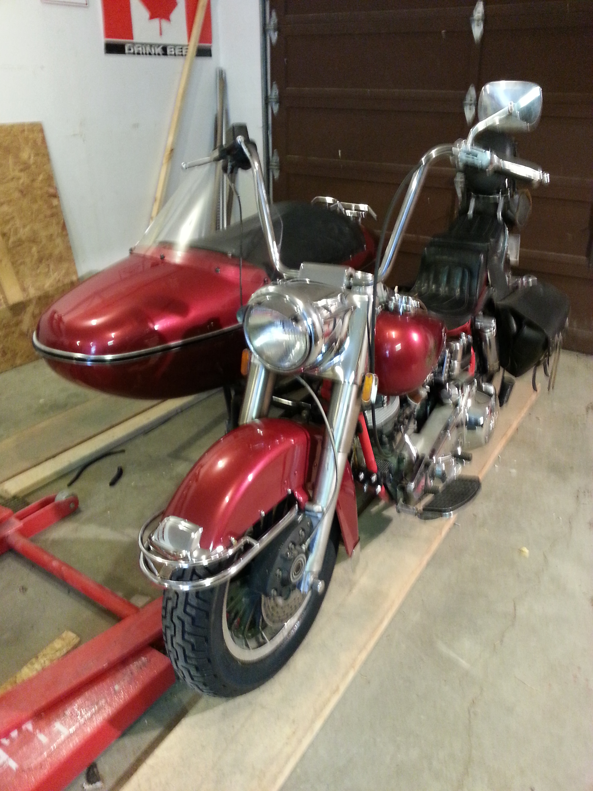

I hear ya....I have plenty of bent, twisted and home made contraptions in my tool drawers as well to get my job done....I've not riden mine that much but didnt notice weather those ape hangers were going to be a problem. I have the original buck horns and clutch cable around here some where if I need them. I'm looking forward to warmer weather so I can ride this thing......
Posted : January 14, 2013 5:27 pm
I've found the Harley "Buckhorn" bars are like rototiller bars, requiring elbow and lateral forearm muscle control.
Being a long rider I find that this style of bar wears on one quickly. Especially with a loaded hack.
For a sidehack rig I prefer bars that allow push/pull from the shoulders. Later FLH bars for instance. On many other Harley tugs I've used the 1995 Wide Glide bar. The '96-''07 RK/RG High bars also allow steering straight from the shoulder and cost of these bars are quite reasonable.

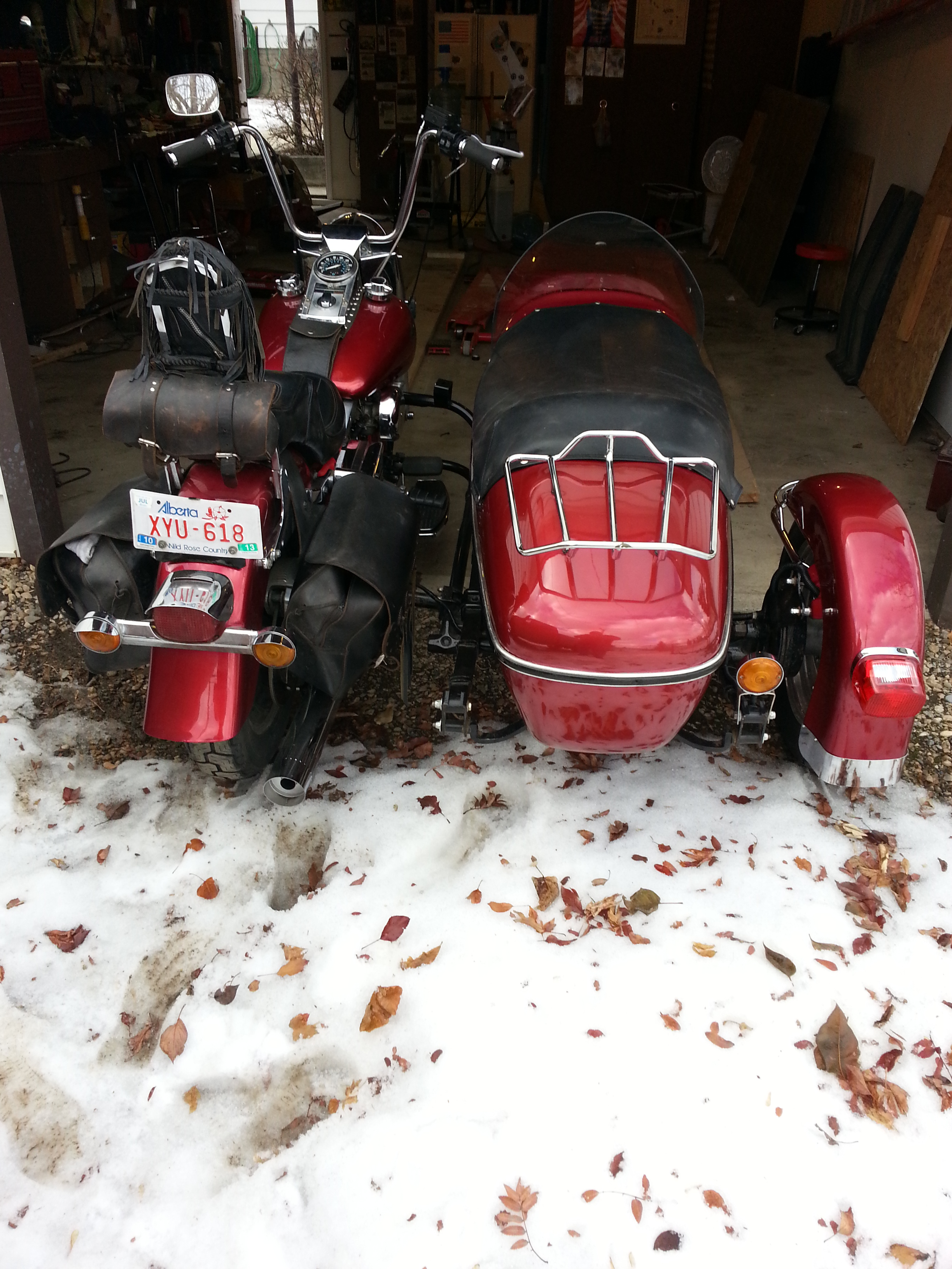

Together again.............

Do you have a raked tree or are you going to install a steering damper?
