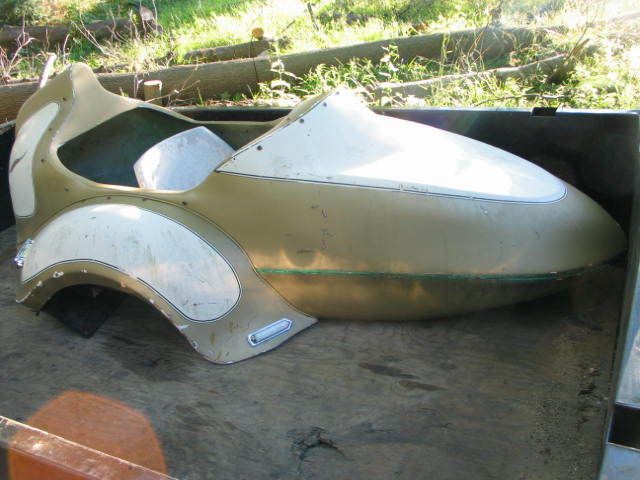

Sweet SL-440 Sidecar Rejuvenated by Roman
Recently I received an email from a gentleman stating that he had one of my original sidecar body's, and if I could build him a frame. I explained to him that even if I built him a frame he would still have to get a friend that new how to weld and fabricate to make the mounts and attaching rods. He wrote back stating that he was a computer guy, and had made a living in that trade his entire life, but that he was also a car guy that could fabricate in metal and was a proficient welder. I told Roman that if that was the case I had a Photobucket account with pictures of my sidecars, frames, mounts, and rods so that he could see just how they were made. I also mentioned that if he cared to build his own frame and components he shouldn't have more than $300 in materials. We sent emails back and forth along with dimensions and a material list of what would be needed. A few days later I get an email with pictures of a completed frame ready to be mounted onto Roman's motorcycle. He also mentioned that he sent the body down to the painters to be sand blasted and painted. Evidently somewhere in the body's history one of the owners painted some of the body panels in gold. It was funny to see one of my old body's in the pictures Roman sent me. The model that Roman has was the SL-440 and they had the color in the fiberglass gel coat and were offered in Black or White only. In all I sold around 50 of the SL-440's. The SL-440's were different than the earlier more popular SL-220 model in that I added 4" to the passenger compartment, not that the SL-220 was cramped, but I wanted to add a dash board so that the customer could install a radio for a little more enjoyment. At that time in history the modern day bagger bike didn't exist. Vetter and others made custom wind screens but to add a radio was out of the ordinary, not that some didn't have radios, it's just that my customers didn't.The SL-440 also had a bolt on fender that could be removed in a matter of a few minutes. If a customer is going to run into something the fender is the part of the body that will suffer the damage. I had a standing guarantee that for $100 I would replace the fender to any customer that smashed one up on the SL-440 model. Not one customer ever collected on the guarantee.
Roman spent less than two weeks working at night and on weekends building the frame and mounts for his new sidecar. We had many emails going back and forth over those two weeks but in the end Roman built one good looking rig. Future plans are to have me stitch up the upholstery and a cover for the passenger compartment. I think we called the cover, a tonneau cover back in the day.
I'm proud of what Roman has accomplished rejuvenating his little sidecar. The things that a guy like Roman can do are becoming a lost art in this day and age. When I was a kid growing up every kid in the neighborhood could make something, but in today's world that is a thing of the past.
I hate to think that this Sidecar hobby that we all love so will also some day be a thing of the past. With a limited number of manufacturers and one of the largest motorcycle manufacturers halting production of sidecars I'm not sure what's in future regarding sidecars. I don't see any young guys coming along like so many of us did back in the day to build these crazy things. Think about the last time you attempted to explain what sidecars were all about to a friend or a stranger asking, and most just didn't get it. Well thanks for reading and keep the bottom side down as you make your way around some part of the the world in that crazy contraption called a Motorcycle Sidecar.
Johnny Sweet

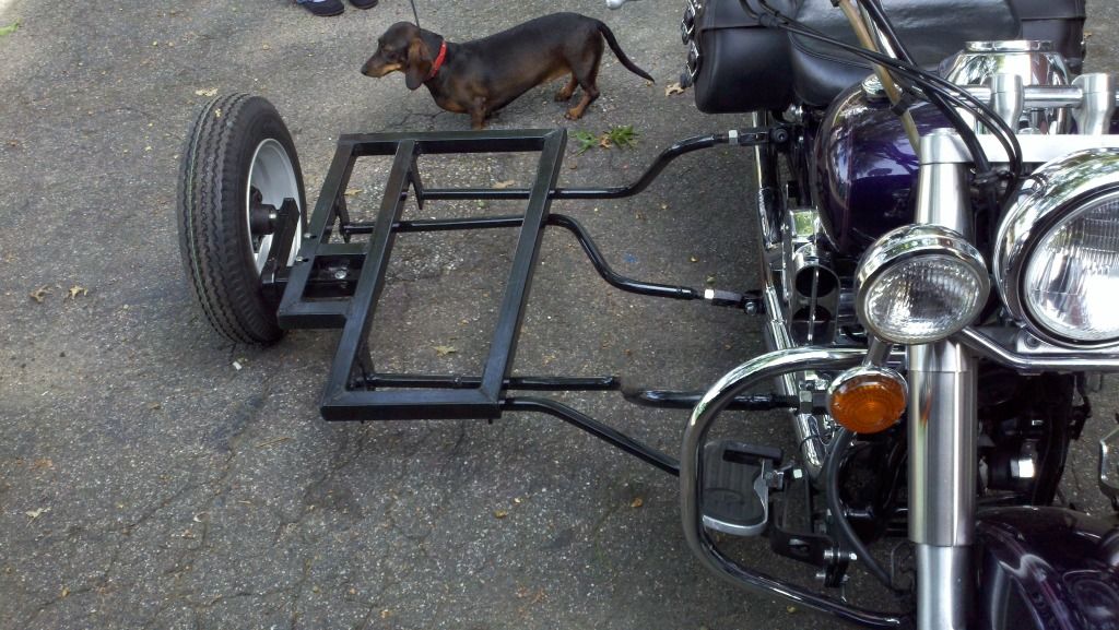

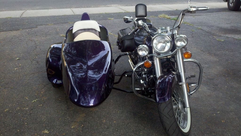

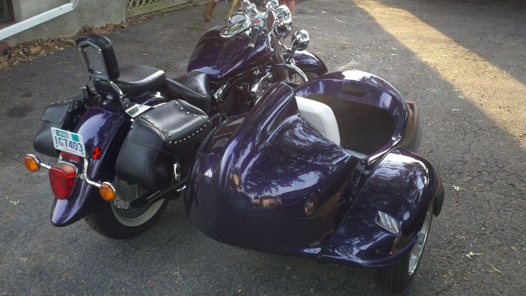

(@ehadams)
Posts: 8
Johnny,
Thanks for replying to this thread and bringing it back to the top of list.
I wanted to show you what we did with the one we bought for my wife Heather.
If you remember this is what our sidecar looks liked when we brought it home.
before
Before 2
After some restoration and modifications to for her this is what we came up with.
after Pinstripe and windshield
after  Side
After Front
Posted : September 3, 2012 5:22 pm

ehadams - 9/3/2012 10:22 PM
Johnny,
before
Before 2
after  Side
After Front
You did a fantastic job on your sidecar. I especially like the wheel choice. The new modern day base coat clear coat paints make the lines jump out at you, very nice color selection. White has always looked good on the SL-440, in fact it also looked good on the SL-220.
It would be interesting to know if after all these years your rig still tracks straight without having to be tweaked. Once they were set up we never had to touch them again. A few of the customers installed air shocks on the Goldwing's and they could adjust the bike camber when the road had more run off than normal.
Going from memory, on your model I designed a top front mount to fit where the horn was bolted to the frame. We moved the horn, but I don't remember where we mounted it to. Some guys would bring in air horns and I would hook em up for them.
One other thing that I never figured out, Customers would bring in bikes and for some strange reason they would have the same bike model with serial numbers within 200 or 300. These would be total strangers who just happened to purchase the same type of bike and at the same time decided to purchase a sidecar. Many times this phenomenon happened. The strange thing was that I set each unit up the exact same way and one would shimmy and the other would not. I would install a VW shimmy damper on the problem unit and the shimmy would disappear. If the bikes in the shop at the same time were all different I would have never even thought about it, but with the bikes being the same model the problem jumped out at me. We built and raced what's called "Super Modified race car", and had very expensive scales. We would set the scales under the three wheels on the different sidecar rigs and do weight and balance calculations. The same type bike and sidecar would weigh out within a few pounds. We never did figure this one out, it was fun calculating center of gravity and Roll centers. Our entire group were all Engineers and today when I watch that nutty show about some actors playing the part of some nerd scientists I think of our group trying to figure out the secrets of why one sidecar rig shimmed and another would not. We even went as far as to measure the resistance on the front wheel/tires using a linear device we fabricated that pushed on the scales to measure the resistance. I always thought it funny that we could build and race World Class Championship Hydroplanes and the fastest circle track race cars in the world and couldn't figure out the why of two identical sidecar rigs shimming. The customer never new the difference because in the end the rigs drove straight and didn't shimmy with the needed modifications.
Over the years I've read different papers written on Leading link front ends and my newest project, a tilting trike will be using one, but back in the day there was no way I would have ever tooled up and produced them.
One last thing, If it was me I would consider lighting up your sidecar like a Christmas tree. In today's world you want to be seen out on the road. Other than that, job well done, and may you have many a happy highway mile. You only go this way once, so live it to the fullest.
Johnny Sweet

(@ehadams)
Posts: 8
Johnny,
 It does track straight.  We have not had to make any changes to the attachments except tighten them down.  they were loose when we picked up the rig.
The addition of the fairing made the headshake so much that my wife couldn't drive it at first this summer and was something that we didn't see last riding season.
To deal with the head shake we found that addtional weight in the sidecar makes a difference  She now rides with 100lb of lead shot in the trunk, we also tightened down steering head bearings on the bike that that made it much more drivable for my wife.
I also remember the story about his sidecar being stolen. Too bad that it has not been found yet. My heart goes out to him.
Thanks
Eric
Posted : September 6, 2012 5:27 am
(@Johnny-Sweet)
Posts: 159
That's interesting in that the addition of the fairing made it shimmy. You could add a VW steering shimmy damper. I used them on any of the set ups that gave me the least bit of trouble. I didn't want any customers coming back a few weeks later complaining about a shimmy. My feeling was to corrects a situation before it became a problem. I would purchase the VW shimmy dampers from any of the auto parts stores. The units that we used were from the 1960's VW. I'm not sure if they used the same damper in the 70's. I fabricated a bracket that attached to the right down tube and ran the VW shimmy damper over to the top front solid rod even with the attaching point on the down tube. I will see if I have any pictures of the combination that will show what it looked like.
I'm glad to hear that you placed the added weight to the back of the sidecar in the trunk area. I always had to make sure that every customer was aware of the problems if they placed the weight in the front of the sidecar. I would explain to them about weight and balance and moving what's called the "Moment", It's an airplane term. We only placed 40 lbs in the back, but if you feel comfortable with 100lbs then go with it.
One thing you may want to consider is placing tape, "yes tape" on the speedometer. In airplanes and some race cars back in the day they would place colored tape on the instruments. It was a small band around one eight of an inch wide. It was placed on the glass with green in the operating range and red in the "Danger Zone". All a pilot or a race driver has to do is look to see that all the instruments are in the green. If the needle is in the "Red" your in trouble. I did the same with some of the sidecar rigs, by placing a thin band of green tape below 38 MPH and a "Red line" above 38MPH. All the driver had to do when approaching a right hand turn when they were riding solo was to look down and see if they were in the " green", if they were in the " Red " it was time to pull the front brakes to slow down. We found that with a 40llb's of ballast below 38 MPH they were safe. More about stopping with the " Front Brake at a later time. I have pictures of the tape set up that I can post for any that may be interested.
Thanks for posting the information about the sidecar tracking straight after over thirty years warms my hart. I've always wondered about things like that.
Later, Johnny Sweet
Posted : September 6, 2012 7:28 am
