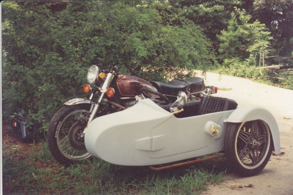

Larry Dodsons one of a kind Sweet Sidecar
Back in the 90's I was building a few sidecars after moving South to Carolina. A friend and I were at motorcycle show in Charlotte North Carolina displaying my Sweet SL-440 and my Classic model sidecars when a gentleman rolls up to me in a wheelchair and asks if he could talk to me. I slid up a chair and we began a most interesting conversation. Larry had an idea for a sidecar rig that was different from anything that I had ever seen before. He wanted to transfer into the sidecar from his wheelchair and be able to drive form the sidecar. He also mentioned that he wanted the sidecar to be mounted on the left so that when driving he could stop and do his banking and at the same time could see on coming traffic, and not have the motorcycle hindering his view. As soon as he mentioned his idea my mind raced back to when I was living in New Hampshire years earlier and had designed a 4 wheel sidecar rig that had two wheels on the sidecar and the body was shaped like an Indy car. I had it designed so that when the handle bars turned the front sidecar wheel would turn with it. Before I finished my Indy sidecar I made a trip up to the New Hampshire Department of Motor Vehicles and asked about registering my one of a kind sidecar rig. I was told that because it had 4 wheels I would have to register it as a car and it would have to have to pass all the requirement that a car had to. At the time a thought passed threw my mind " were would I attach the seat belt". In the end I never finished the 4 wheel Indy sidecar rig. Little did I know that I would later move to the South and could have driven it without ever a word, I digress.
Larry and I drew out some ideas and I told him that the only problem that I saw was that Harley didn't make a bike with an automatic transmission, but that Honda had in the late 1970's. Larry said that he would find one and have it shipped to my home. A few weeks later a guy shows up with a running Honda 750 with the Honda matic transmission.
I got out my Classic sidecar mold, it was a copy of the metal Harley sidecar body that was built starting sometime in the 1930's till 1963 or so. I had built around fifty Classic units and had a few to build for guys in the surrounding states.
At the time I was heading up an Engineering team and had fourteen or fifteen Engineers under me and I spent all day long putting out fires. Engineers can and are difacult to deal with at times. It's not like when I worked in a design team sculpturing car body's or various other products. In those venues we design by comity and everyone works for the good of the project. Mechanical Engineers are in most cases prima donnas and only their idea is the good idea. I had the Engineering license so I was the guy in charge. So working at nights and weekends on projects like Larry's sidecar kept me sane.
I set Larry's sidecar up like any other in that the set up was the same but the implementation of the controls got a little complex. I ended up using a Honda car rack and pinion steering unit that I cut one end off. I then installed the rack and pinion into the sidecar and fabricated a push pull rod that extended over to the motorcycle. On the lower end of the front end of the motorcycle I fabricated a bracket to attach the push pull rod to. Earlier I calculated the steering differentials and were the pivot points should be. Larry had limited mobility in both arms and hands so the steering had to be lock to lock without to much resistance. In the end Larry brought me a padded U shaped devise that he placed his hand into. He could grasp the devise and it swiveled on the small steering wheel. The other hand, his left was used for the throttle and brakes. With the sidecar body on the left all Larry had to do was reach over the right side of the body and pull or push the shifting lever in or out of gear. I ordered longer throttle cables and placed the brake and twist throttle on a tube that was attached on the left side of the steering wheel.It was simple to drive, reach down and pull it in gear and a twist of the throttle and he was off. To brake all he had to do was push on the brake lever, not pull. Remember he has limited mobility. I used the front disk brake and installed an additional disk brake on the sidecar wheel. No rear brake was ever used. I attached the two brakes together and they worked perfectly from day one. I had studied brake dynamics and brake bias at my day at General Motors Institute and it came in handy.
Once the basic sidecar was completed I still had the wheelchair lift to design. I got into a freeze design wise. I walked past Larry's sidecar rig for a year going to and from work and couldn't figure it out. Larry would make his way down on some of the weekends and drive his rig around my yard all afternoon, but still no wheelchair lift. Then one day I woke up and the entire design was right in front of me. It took around two weeks and I had it working. It was set up so that Larry would open the sidecar door and transfer from the wheelchair into the sidecar. He would then close the door and hit one of three toggle switches. An jacking arm in the back of the rig drops down and lifts up the back of the sidecar. A second switch activates a rotating arm around to the side of the sidecar. A third switch operates a linear actuator that drops the arm down so that Larry can slide the wheelchair onto the arm. He then lifts the arm and it swings the wheelchair around to the back of the sidecar. One last triggering of the jack switch and the sidecar is dropped back down and he's "good to go".
Larry drove his rig around eight to ten thousand miles a year and made many friends. It had been over twenty years since Larry had been out on the road. He was a Veteran and after the war rode until his accident. To me it was one of the most rewarding projects that I had ever worked on and in doing so I gained a true friend. Larry had shoulder surgery and can't drive his rig any longer. We have talked about changing the steering to an electric power assist unit. I'm still looking into it. Also the sidecar wheel has a bent shaft and it's set with camber built into it. All these years Larry thought that was the way it was suppose to be. The original wheel had a .750" grade 8 shaft and it bent early on and never moved any further than what's in the picture. I have a BMW wheel with the 25mm bearings that I will use in the future.
I hope you enjoyed reading about and seeing pictures of Larry's one of a kind sidecar. Larry was out of my life for over ten years and I didn't know if he was still with us. It's been an absolute pleasure once again hooking up with an old friend.

Larry's sidecar rig before the wheelchair lift was designed
