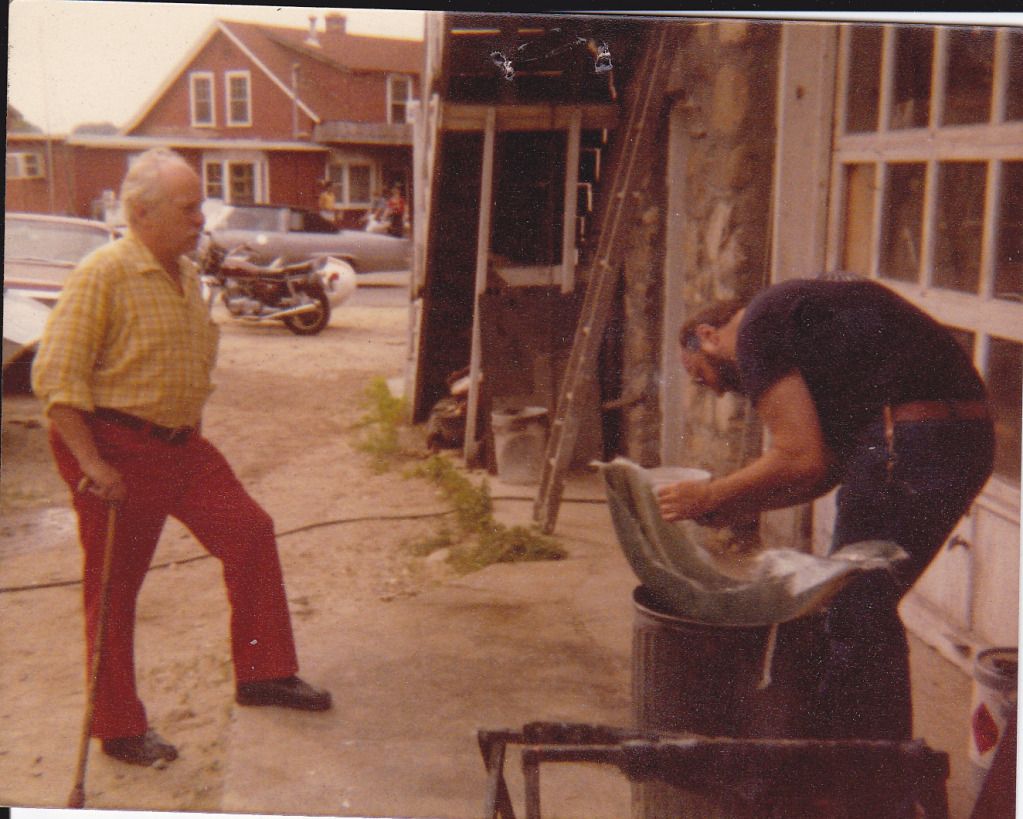

The very first of the SL-110 sidecars ever built.
Who ever said a business can't be started in a two stall garage. My buisness start up was as low tech as they came. These were the first units built, in the picture the black unit is sitting next to the Honda 500 and not installed. The first units were built using 3/4" rods as shown in the picture, they ended up being unsatisfactory. At the time the machinists lathe that I had would only except a rod 3/4" in diameter. I then picked up an old WWII Monark 16" lathe that would turn almost anything, I then went to a 1" rod. The red and blue body's were painted in Metalflake Candy colors. From the house the famed Metalflake shop was only over the hill around four miles away. At the time Metalflake advertised all over the country with adds in almost every car and bike magazine. I was a regular customer for years and worked at getting one of my sidecars in their adds, something that never would happen, a guy can dream can't he.
The first and only Metalflake sidecar that I ever built. I ran a custom paint shop Ohio in the late 60's called "The House of Flake". I swore I would never paint anything in Metalflake again once I sold the buisness. Candy Colors were OK, but no Metalflake. When a childhood friend wanted me to match his Harley with a Metalflake sidecar I couldn't say no. Wayne was a dynamiter and worked on the last of the interstate highways. He would leave on a Sunday afternoon on his way back to "Down East Maine" with his suitcase and his jack hammer in the sidecar. He would work all week and make the drive back to New Hampshire on Friday night. He ran the sidecar rig for two years in the Summer months until rt 95 was completed. When he got married the wife wanted no bikes around so Wayne sold the Harley, but refused to sell the sidecar. It set in his front yard for years and then he sold it it a guy that had been bothering him for some time about buying the sidecar. He brought it to me to mount on something, I don't remember what, and he had me paint it black.
This picture must have been taken on a Saturday afternoon. I still hadn't installed the dust cap on the spindle. I finished and test rode the rig later that day. Wayne told me to deliver it to the local "Watering Hole" that Saturday night. It was dark when I pulled into the parking lot and everyone was feeling no pain. Most of the guys in the bar I had know most of my life. The sidecar was a big hit and I gave all the drunks rides up and down the road. Wayne signed off on the sidecar and told me to take it back to my house and he would pick it up the next day when he was feeling better. I drove back to my house and dropped it of and took my Honda 750 with my sidecar back to give more rides. This time to the girls. I kept the rides in the the driveway of the parking lot . A hole lot of screaming went on that night. I would run the rig up and down the driveway in first gear making left hand sliding turns. The dirt track guys would have been proud of me that night. I was the only one sober and drunks got in one by one. A few laps around the driveway and they were screeching to get out. I would do the ten laps and by that time they had enough. I would stop in front of the entrance door where the crowd was standing and let them out. A few seconds later the next dare devil was getting in the sidecar. I gave out a lot of rides that night and one things for sure, I burned all bridges relating to any future sidecar sales to any of my old friends. The recipients of the hell ride would have the last word.
The Honda 500 on the left was one of my Dad's with the sidecar from the Philippians. He was in and out of Olongapo Philippians many time each year, so he had a custom sidecar built just for fun. When he wasn't driving a Sweet sidecar he drove his Philippine rig.
I had gotten into hydroplanes the year before and in the right of the picture is one of my hydroplanes.
