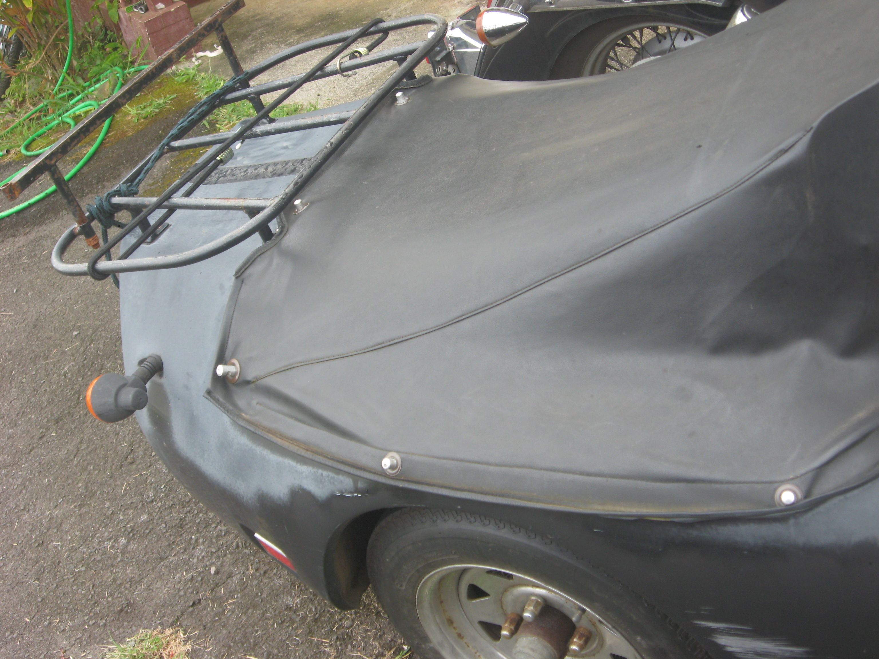

I made my own of my own design. An aluminum pin that is fastened on by a screw from the inside. The aluminum pin is about .4 inches in diameter and less than an inch tall. An ordinary brass gromet is put into the tonnau and goes over the pin. "Twerks good for me, never breaks or wears out. You can't say that about snaps or the twist type that boaters use. Yea Yea, I'll go take a picture of it.
Cut a piece of aluminum rod and turn on a hobby lathe to a diameter about 1/32nd of an inch smaller then the grommet hole and round the shoulder. Leave a wide area at the bottom so that it can't wobble.
drill a hole in the bottom and tap for threads of the size of the allen screw you want to use. I prefer the butt head allens.
