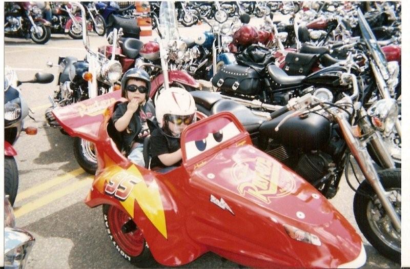

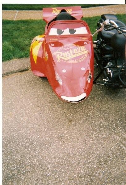

Pictures- I've got more so I'll try to put them in an album. Thanks Jason
Posted : August 29, 2008 12:45 am
(@plenkway)
Posts: 17
Wow - that is some fantastic work.
Pete
Posted : August 29, 2008 1:23 am
Thanx. I still have more to go but that will wait till witer.
Posted : August 29, 2008 10:37 am
I like it!
Dave
Posted : August 29, 2008 3:05 pm
Sweet work on the car!
