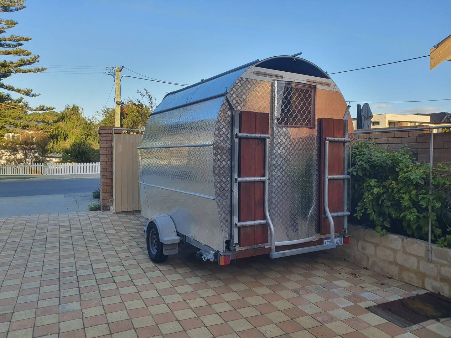

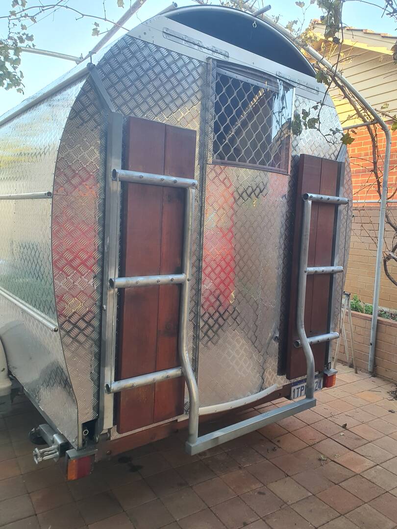

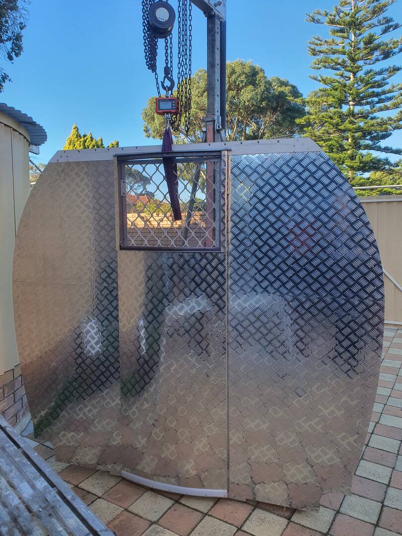

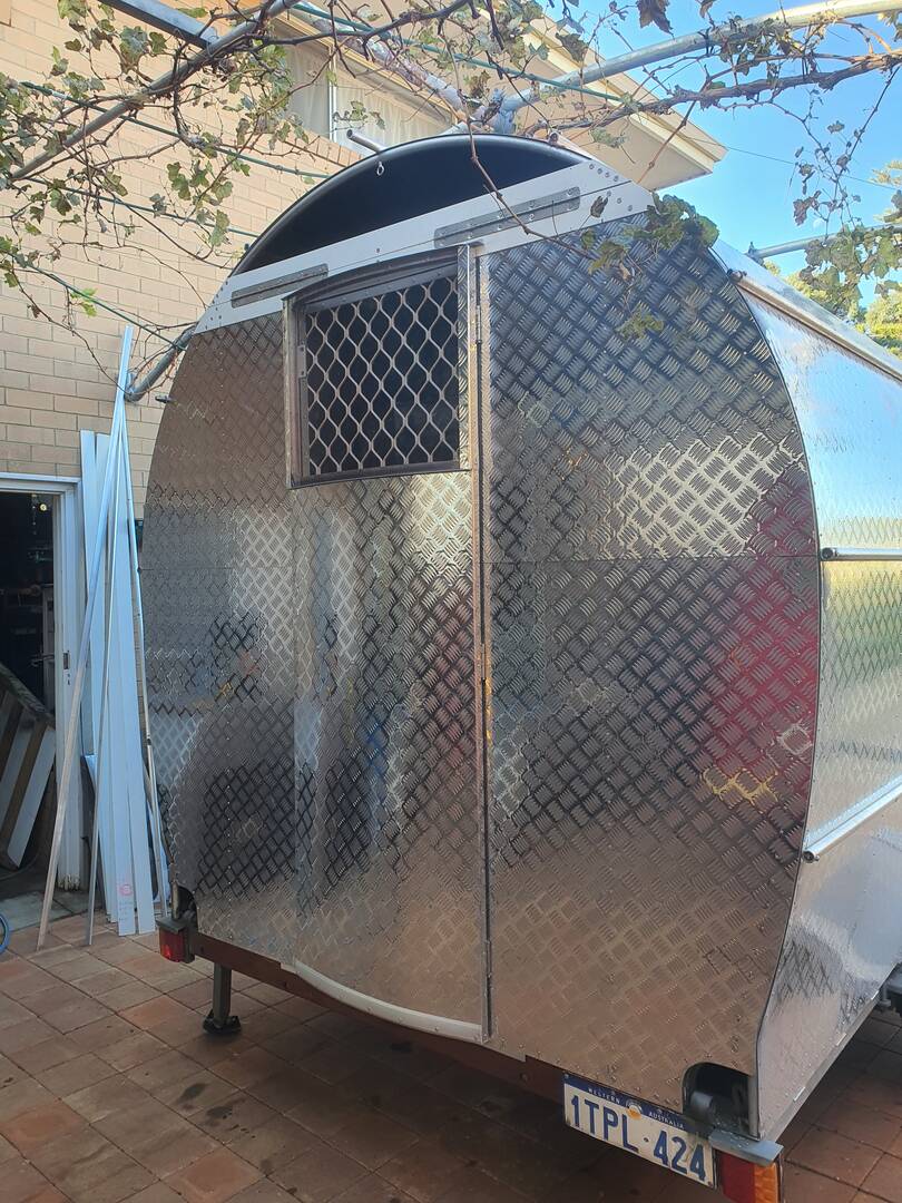

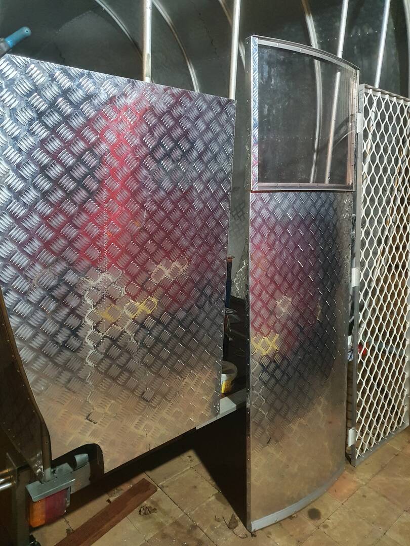

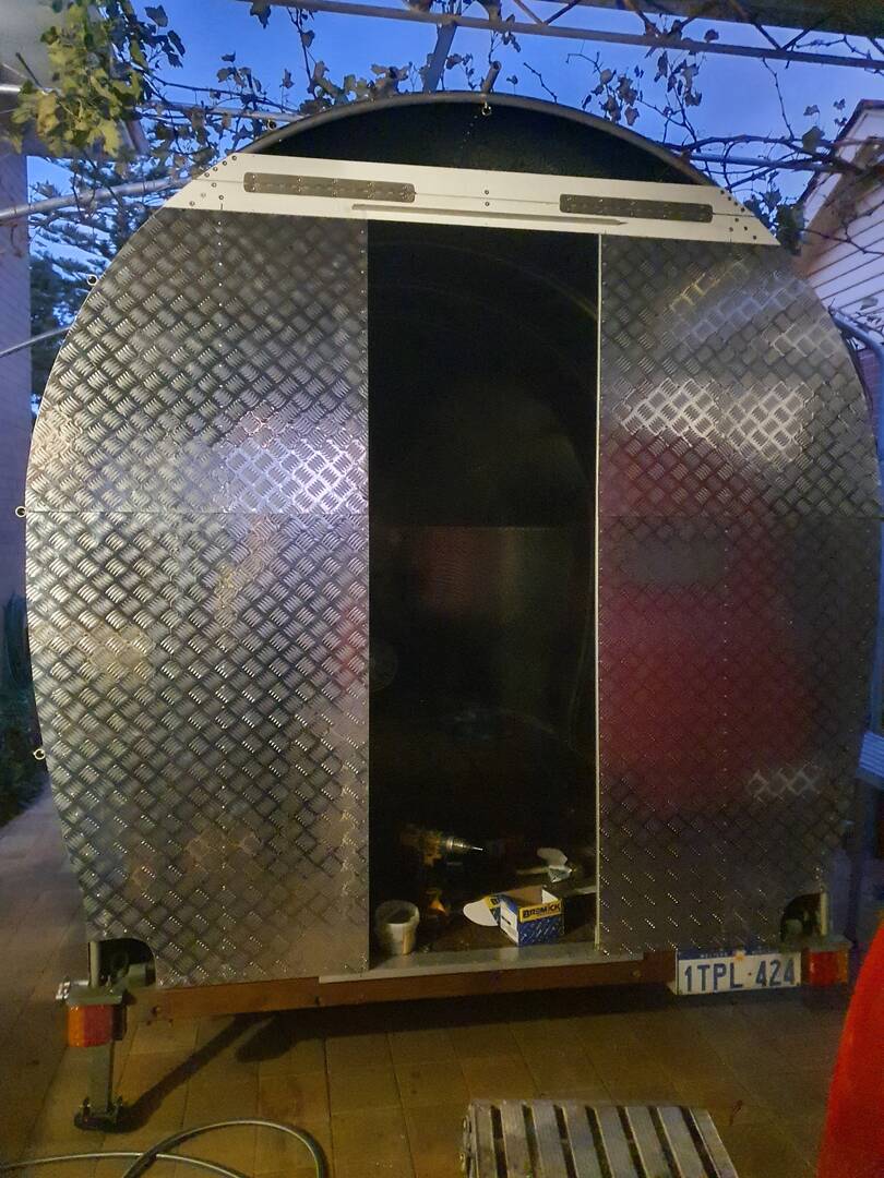

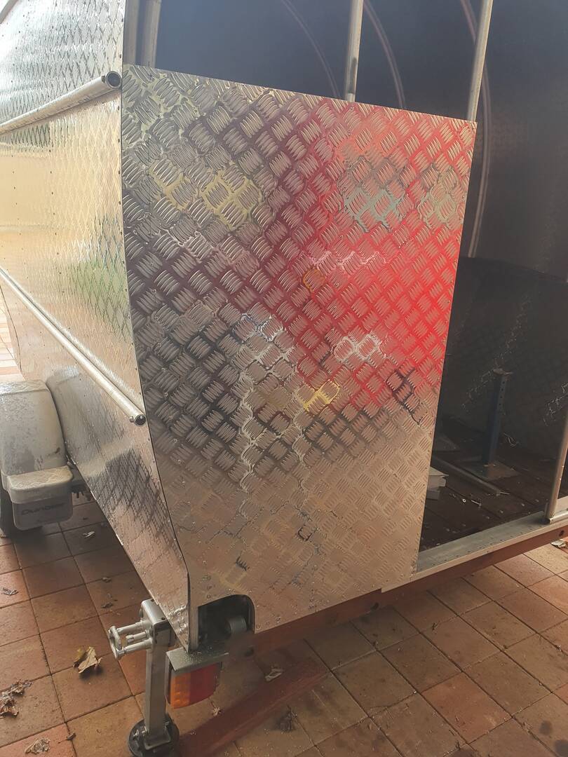

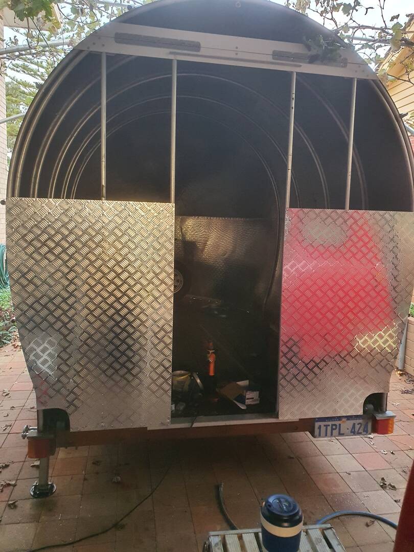

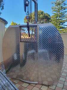

The back doors, that's a door within a door within a door.
Have it seems taken more time, effort and what's left of my grey matter than the whole canopy thingie so far.
The  curved personnel door will open with probably a small gas strut to keep it open.
(Somebody just had to got the extra and curve it.)
The inner mesh (so far ) door should stay shut with another small gas strut.
Then the whole back should lift on gas struts forming a canopy over the ramps.
The ramp can be levelled to use as seating.

Oh and the weight crept up a bit.
Thinking around 45kg so far.
About 50% over the plan.
Gas struts definitely needed.
Hopefully I won't have to ditch the steel and timber ramps at 53kg.
Then spend a few hundred on a pair of loose Ali ramps at around 20kg.
Posted : June 3, 2025 8:28 am

The weight refers to the entire rear lift up door.
It's  a lot about weight distribution, I'm still within the aggregate limit but may need to move the axle assembly rearwards.
Will see soon enough.
As to the curve on the door within a door within a door?
It's already got Miles asking why......
Nuttin like success!!!....
But really it was the picture I had in my head.......
It will always make me smile.
Wanted to curve the whole lift up door but the ramps made it impossible.
The solution for slipping Moto Guzzis will be to rough sand the ramp.
And turn of the traction control each time.

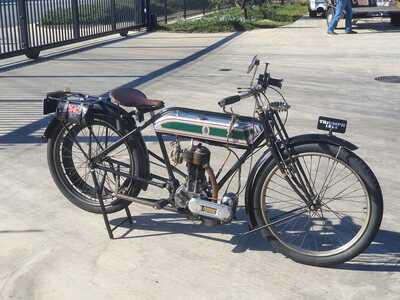

3 engines
20250605 113302
20250605 174114
20250605 091336

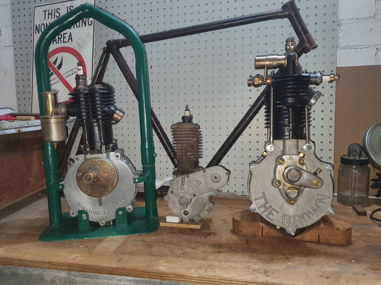

  3 engine made between 1903 and 1906?
The Brown is 1903 as far as we know based on newspaper ads.
The JE Smith ( a clip on engine ) is a few years latter.
And the Minerva is somewhere in between I think.

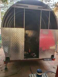

Cut and mostly fitted the top 2 sheets to the trailer.
And a coconut? Washed up on our beach.
Palm trees are A very long way from here so interesting.
My my sister suggested a dinosaur egg???
Have to load the Fiat tomorrow for Saturday's meet.
So what's done is done on the trailer.
Could bolt the 2 smaller doors on though.
Just haven't worked out any sort of locks and handles.

Got the Fiat loaded for tomorrow.
And the 3 engines.
That's 4 100yr old plus motors.
Cool.
Don't let me forget to tie it down.....
The liftup door is mostly done though will be using props tomorrow instead of gas struts.
Also used a temporary lump of wood to hold the 2 smaller door's shut.
Looks OK to me.

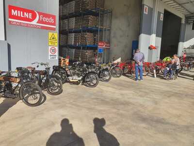

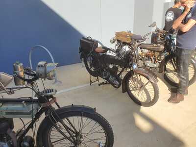

It was a good day at the Heritage motorcycle gathering today.
It was put on by Marley's transport in Hope Valley , well Frank Marley In particular.
There were a lot of vintage and veteran bikes on show.
With some of the guys bringing 3 and 4 machines.
20250607 133356
20250607 133329
20250607 132747
20250607 100456
20250607 100135
20250607 095643
20250607 100145
A smaller group of machines went on a short run then it was lunchtime.
Burgers by Marley's.
Posted : June 7, 2025 5:31 am

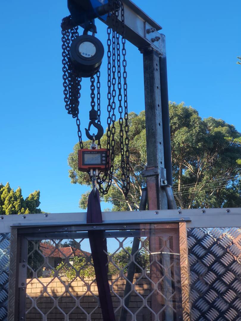

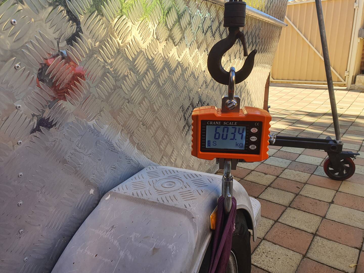

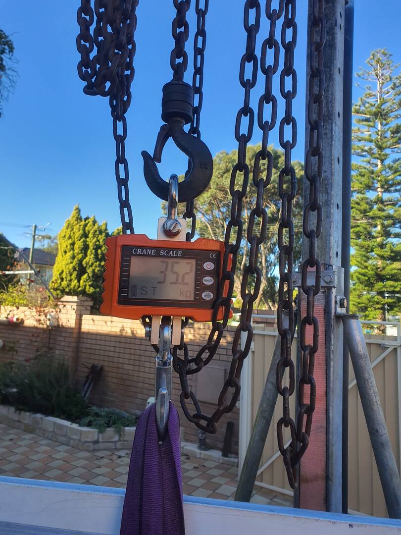

OK.
143kg on the towball.
603.4 kg on the left.
607.6 on the right.
Total is 1354 kg with a good 10% on the drawbar.
Room for another 46kg
Pretty stoked about getting that so close.
The lift up doors are 35.2 kg plus locks, gas struts and mounting.
A mere 5kg over.
That part is on track.

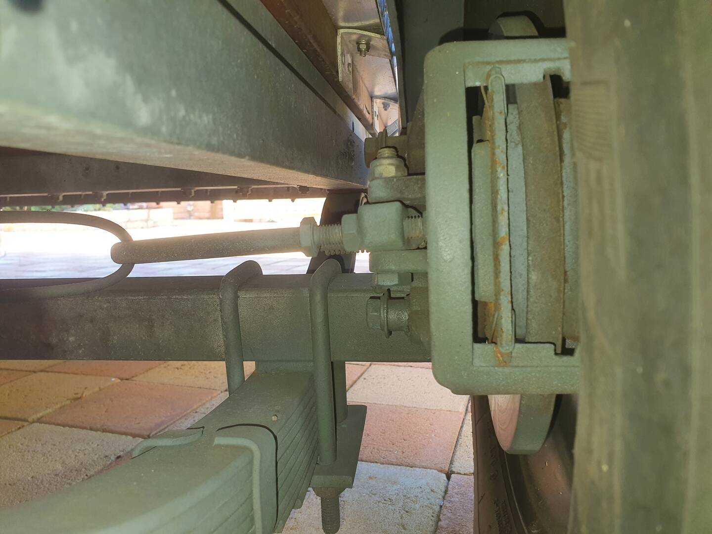

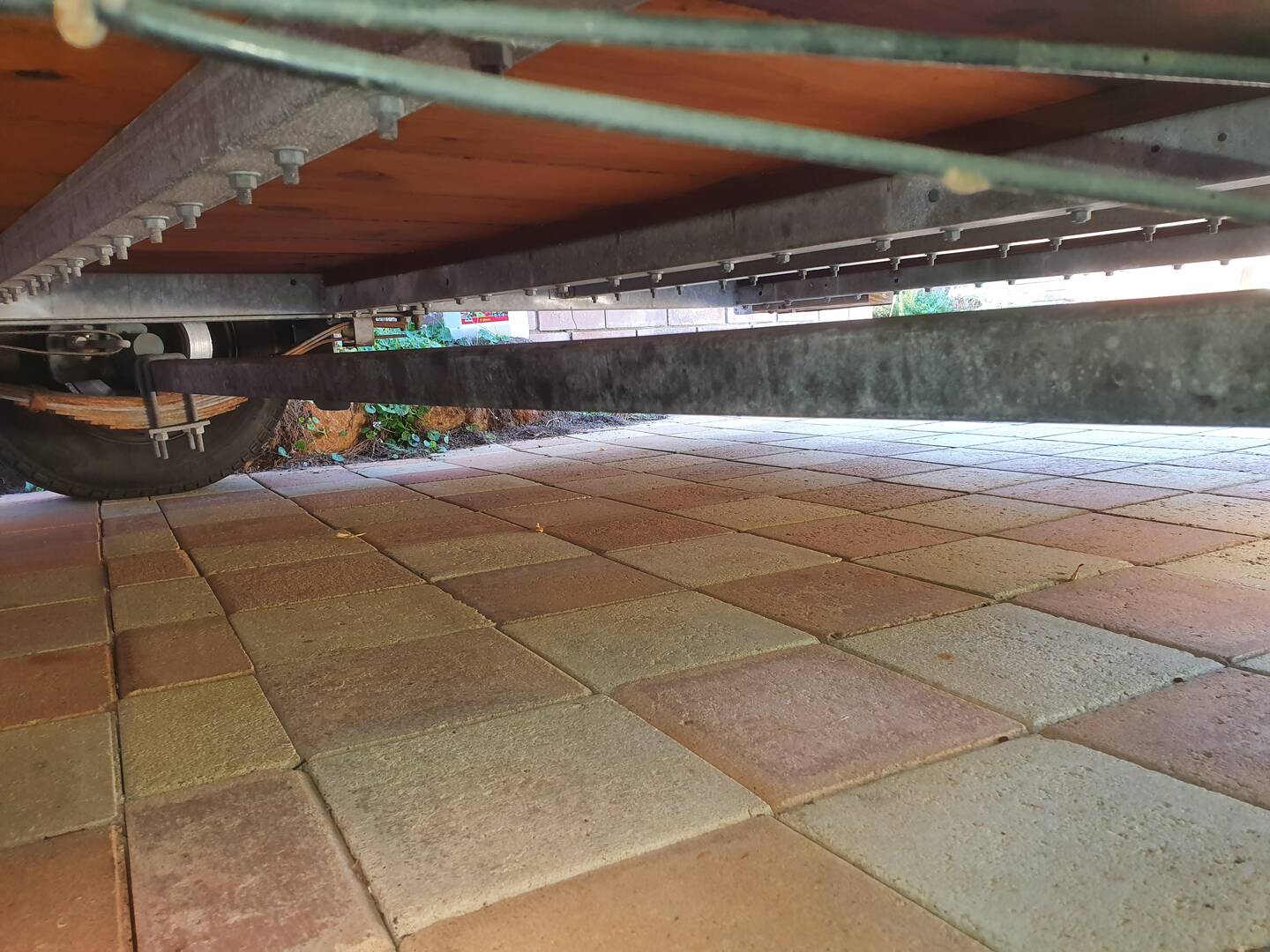

Where I did get a fright is in the axle.
It's a 50mm solid bar drop axle.
Looks to be flexing a bit.
So had a look underneath.
The brake levers on the disc callipers have just  over an inch travel till they hit the chassis
The axle though has more than 2 inche's travel.
Problem if any distance is involved.
Looking into it now.
Maybe a straight axle is needed?
The drop is only a couple of inches.
Will see.
Posted : June 8, 2025 1:44 am
Posts: 1876
Suggestions from the wanker On The Road.....cut off the remaining 1.3 inches, or 34mm of thread on the bottom of all those shackle bolts at the leaf springs,  so you end up with another 34mm of clearance.
Remove all brake pads, lube the caliper pistons, lube all contact points, then reinstall the brake pads in the calipers,  so that the trailer brakes actually function.
At this point,  it is far too late to consider replacing that drop axle with a straight axle.  Yes, the roads in OZ, and in Western Australia are bad, but....you are hauling precious cargo,  so slow down.
Razz
Edit:   or.....replace those smaller wheels and tires with  16" wheels and tires that have a taller profile, like a 195/75-16.....or even a 195/80-16 tire, then simply raise the fenders. That is much easier to do than replacing the axle.
Posted : June 8, 2025 5:48 am
Posts: 622
Actually Miles the point I was trying to make even though the threads could well be cut back.
Is that, that brake lever will hit the frame well before the axle does on hard bumps.
Enough repeats will break said lever and there go the fancy brakes.
A straight axle would solve that issue.
Or see if different lever set ups are available.
I could perhaps try modifying them.
Though that would need careful thought 1st.
Servicing the brakes does seem a reasonable idea but won't stop them from failing.
I'm surprised I never saw this before.
And that they got the thing registered like this.
Saw a straight axle on Facebook the other day.
Raising the trailer an inch and a half shouldn't make the ramps too much steeper.
Under slinging the axle would be a bit extreme.
Giving more than a 4 inch lift.
I do like the idea of larger diameter wheels.
Say matching the Dodge.
But reluctant to do that.
This post was modified 9 months ago by Brstr
Posted : June 8, 2025 8:21 am
