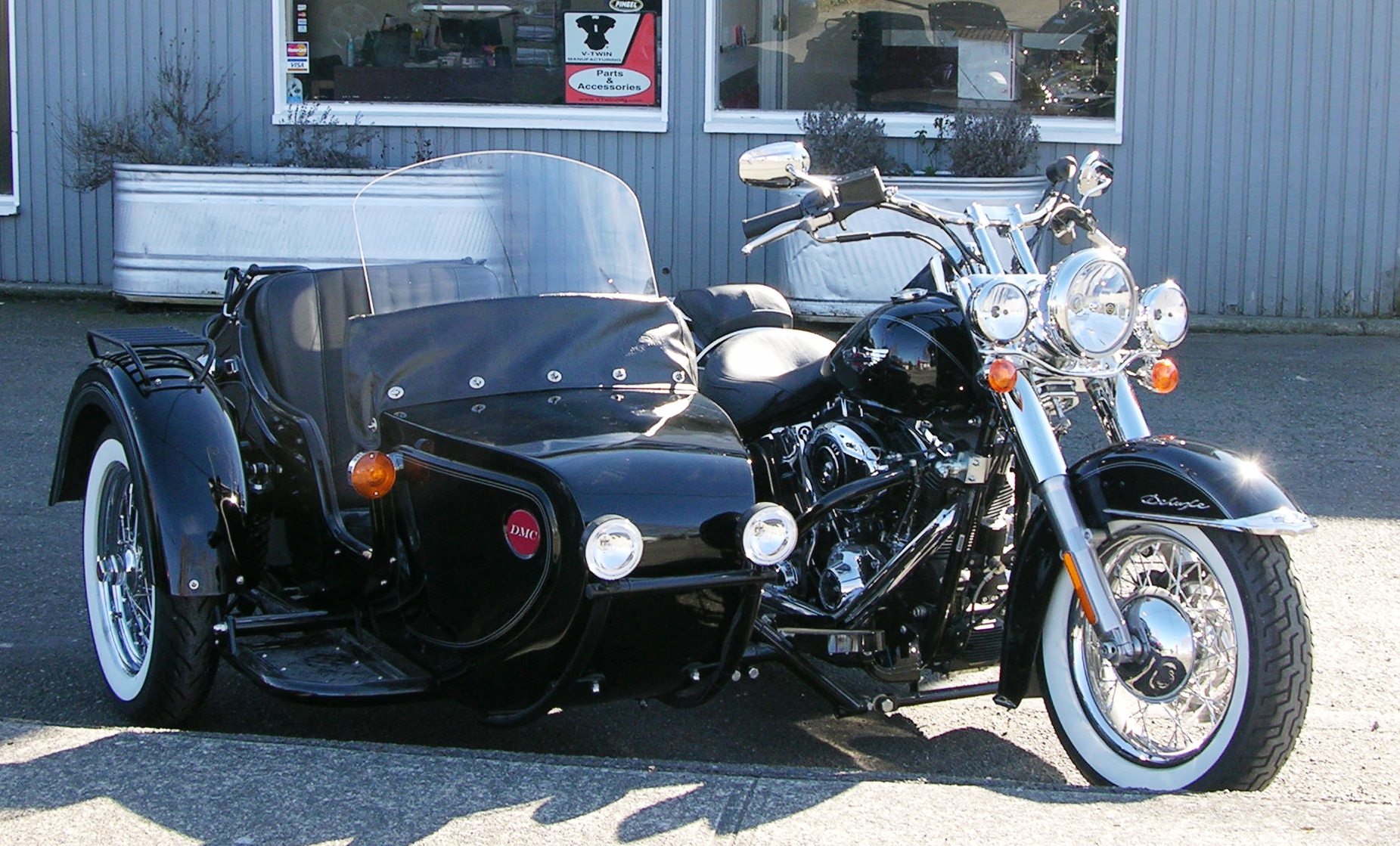

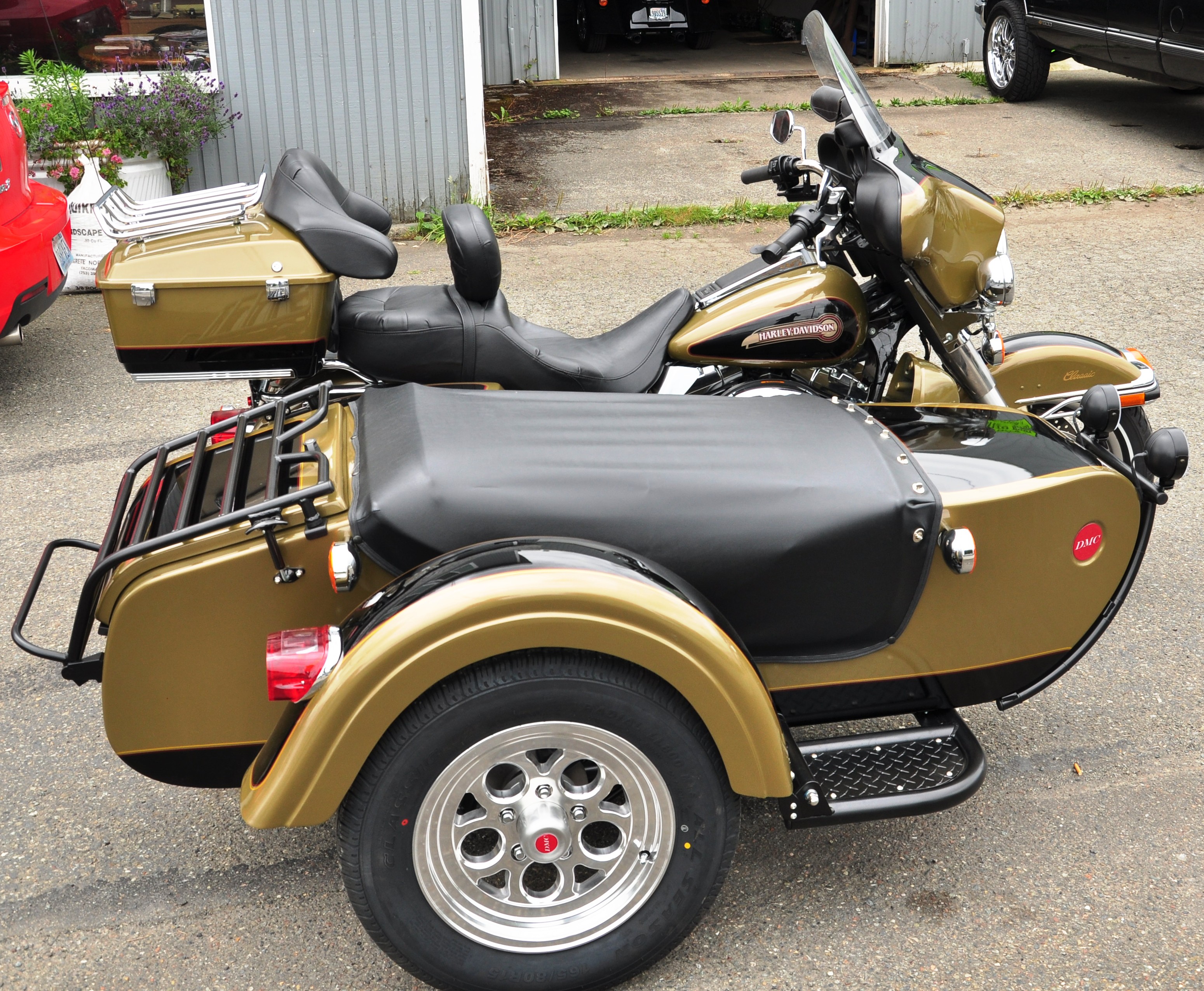

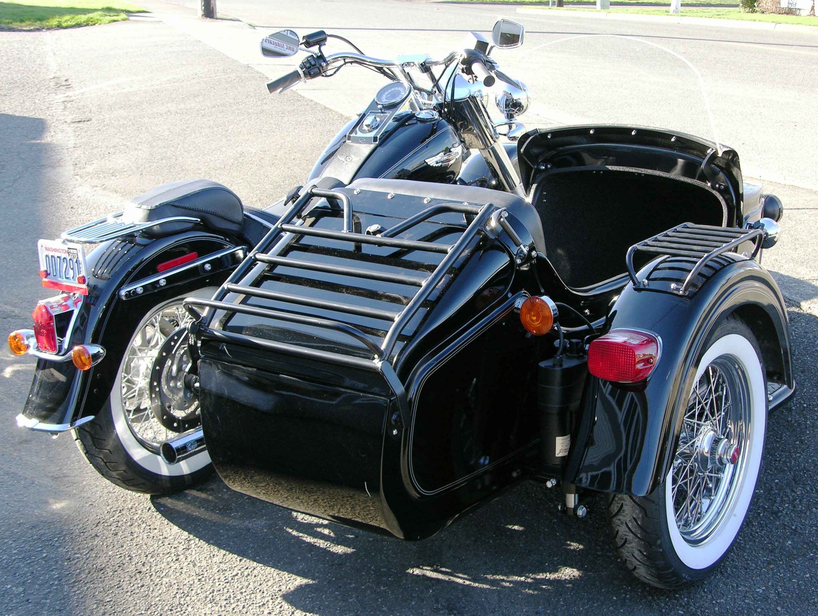

Sidecars we offer I can recommend for either bikes from least to most expensive are the Kenna single or double, the M72C, M72CX, Tomahawk, Tomahawk SE (note we would run a Harley type fender rather then the Indian type fender) and our Expedition. I have attached photo's of the M72CX and the Expedition.

With proper mounts and some ballast the 563 Tour has worked well on dozens of Softtail Harleys we have converted since the Tour models have been around (2004, with no negative feedback).
