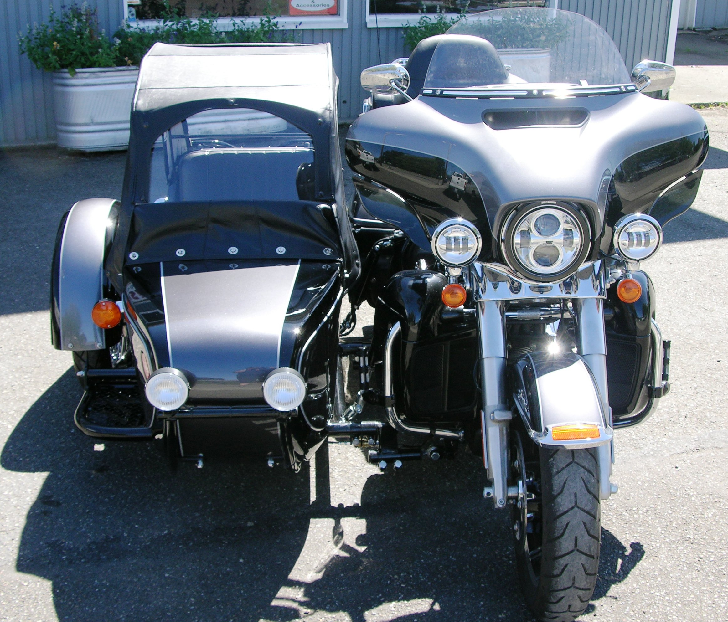

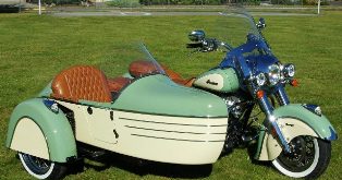

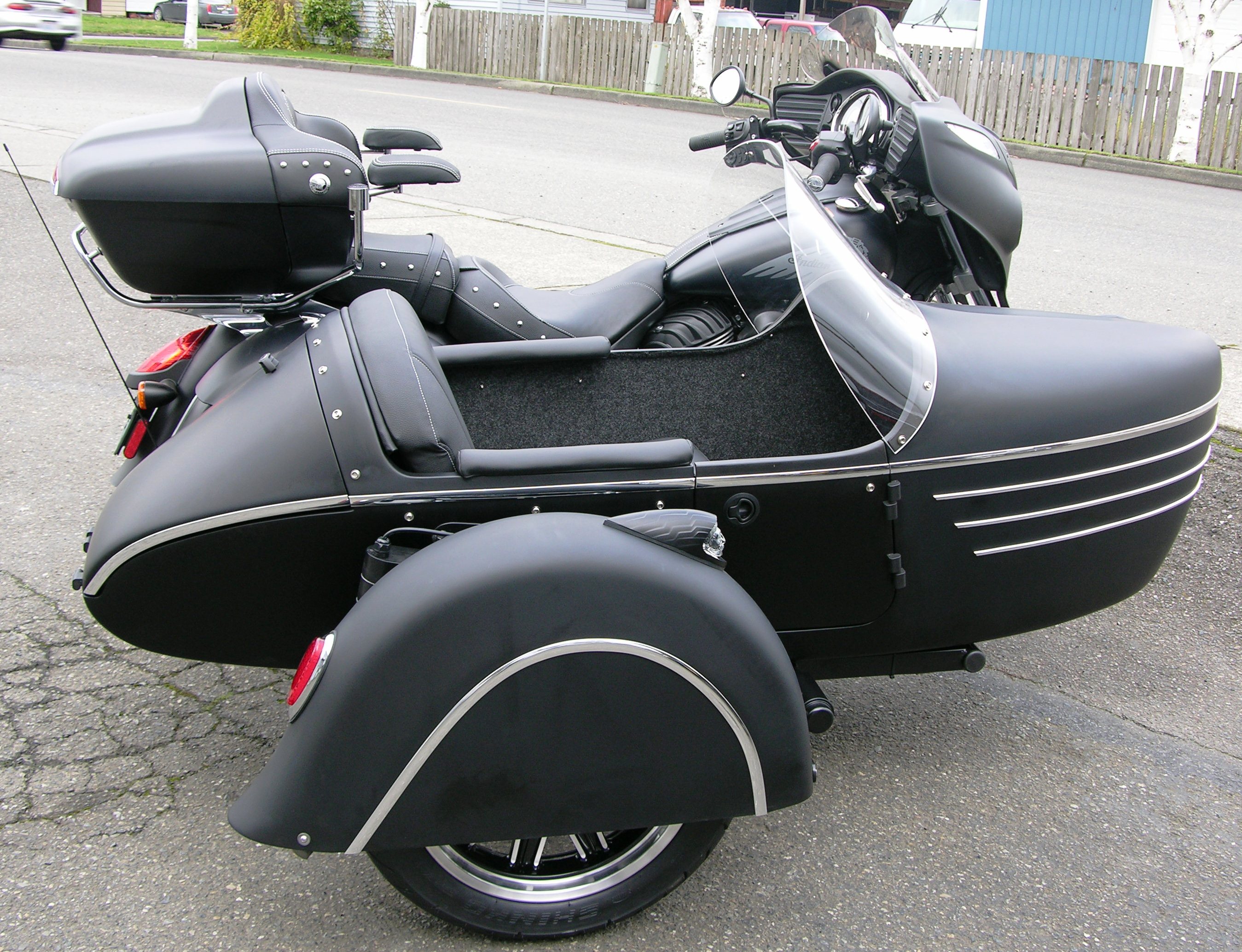

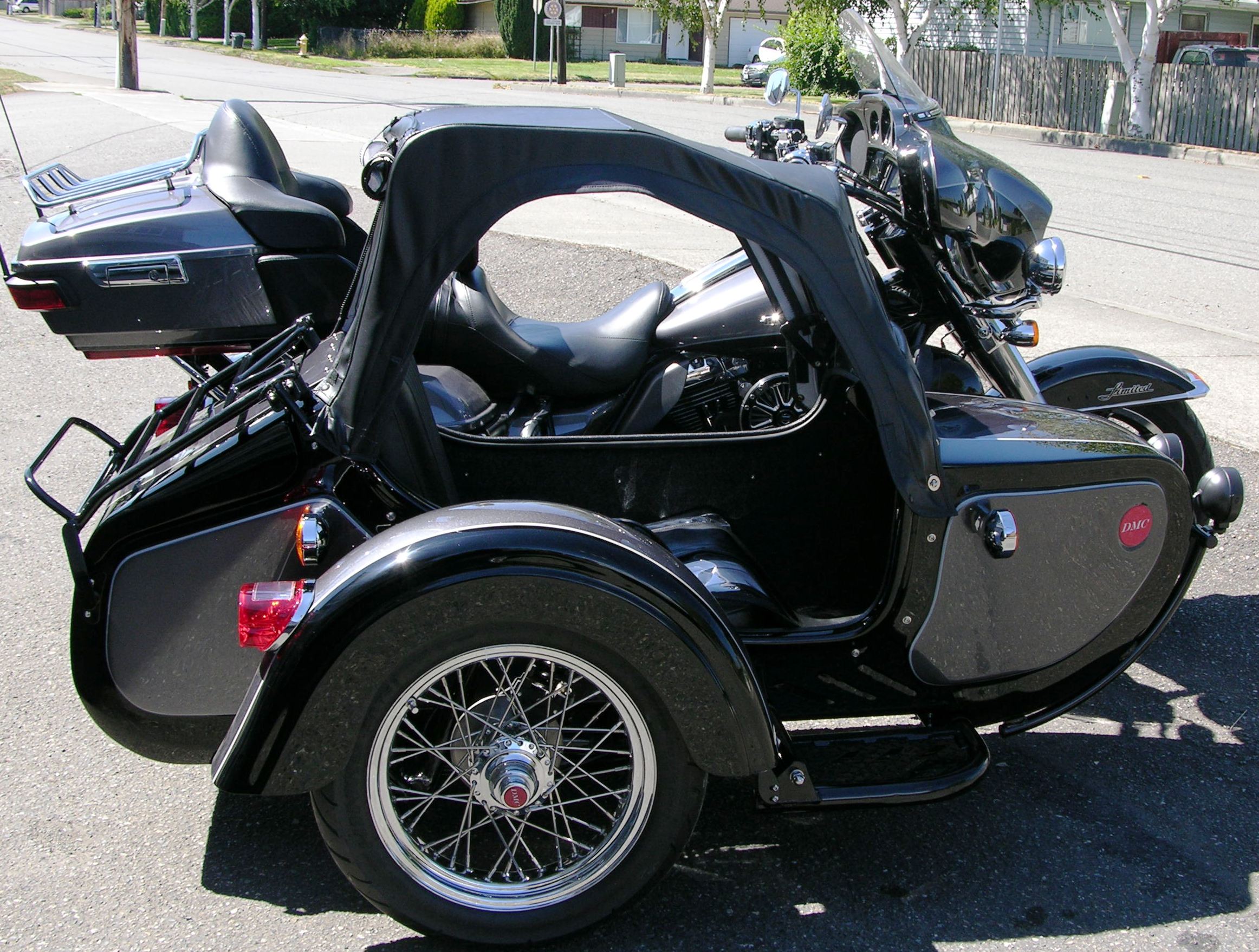

HI Rob, as triple tree's are made of the Harley I would go with the tree's. Your Guzzi more then likely as you were not able to find tree's for the Guzzi, we made tree's for a while but not a lot of demand for Guzzi items. While links have some advantages on a bike like the Electraglide I doubt you could push the bike hard enough to notice the difference. Tree's are a lot less money and keep the stock look to the rig.
The Harley is nice as you can add reverse to the bike, nice to have but not a must however some times loading the rig onto or into a trailer and off can be easier with reverse. What ever sidecar you go with make sure that it comes with proper bike specific mounts not a bunch of "universal" type frame clamps they tell you will fit your bike. As more then likely you are going to have the rig for many years make sure that Sue (and perhaps down the road you, as you never truly know what the future will bring) is easy to get in and out of and has a seating position that will work for years to come. If I were doing this I would go with an Indian instead as they seem to make a great sidecar bike. At this link http://www.dmcsidecars.com/video/ There are three video's the first tells you about us, the next two are the entire installation process for one of our Tomahawk SE sidecars onto an Indian. This will give you an idea of how we do things.
There are many very good (and a few not so good) sidecars out there. In our line up most of our sidecars can be built with a Harley type fender and a matching Harley front wheel and the Tomahawk can be built with either a wire wheel or an Indian front wheel. The M72C, M72CX, Expedition and the Tomahawk SE are the most popular we offer for people in your situation. All of these sidecars are fairly wide except for the M72C which if you are going to be using a toy hauler type RV might be a consideration as you must be able to get it through the door.
I would be glad to answer any questions you may have.

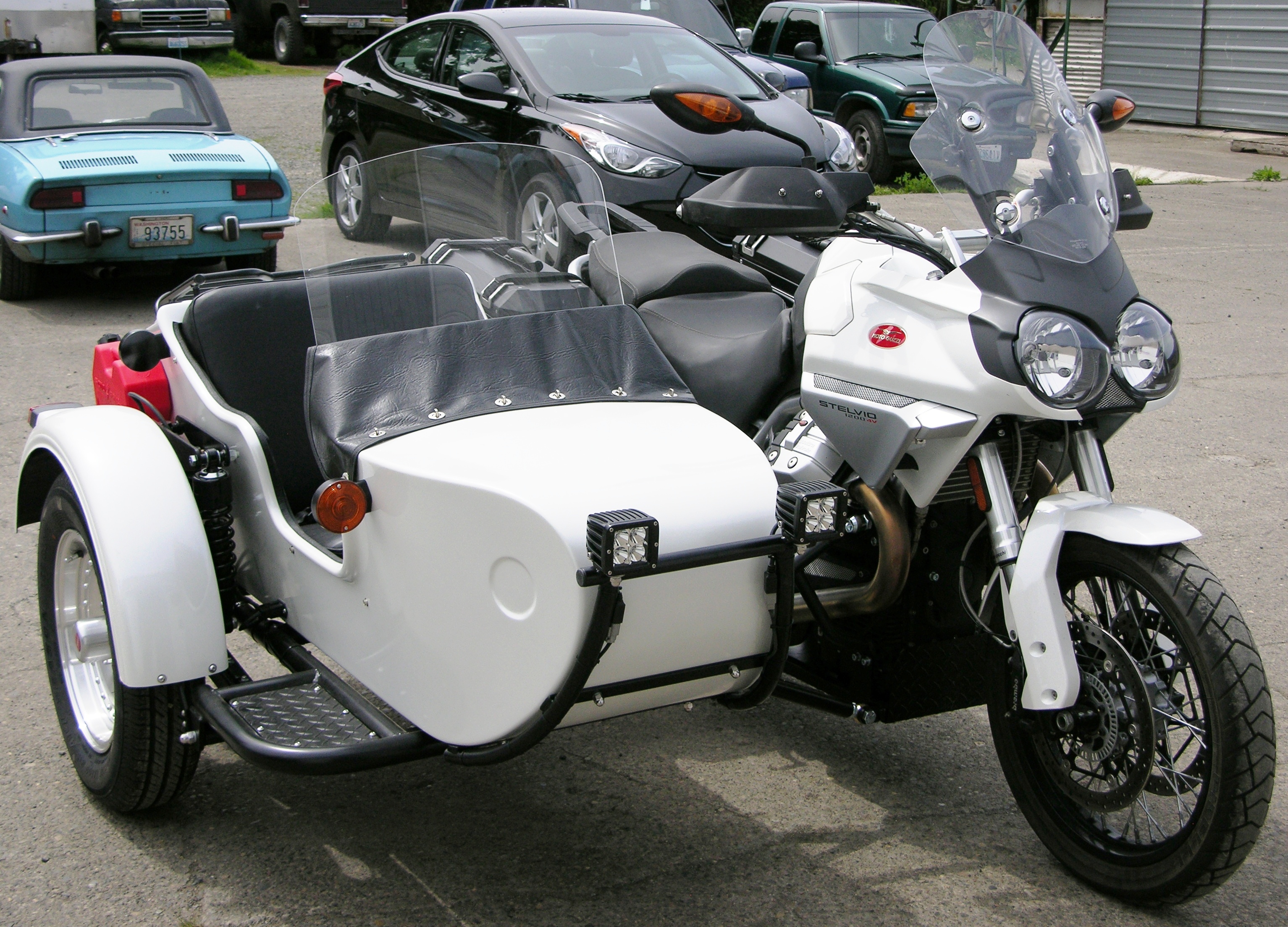

The triple tree's come with spacers for the forks to keep the ride height the same, The Tomahawk sidecars are quite a bit larger then one would think, what we did was start with a 1940's Indian type sidecar and make it larger by about 20% as modern Indians are larger and so are modern people. Many sidecars like the Champion Escort or some of the Hannigan sidecars that open to get you in and out while they look easy to get in and out of the seat is quite low to the point where when peoples knees start giving them concerns we have added seat lifts. The Expedition is by far our easiest sidecar to get in and out of and the seating position is the most optimal. We of course can do the Expedition for the Stelvio or the Harley. I do not have a photo of the Expedition on a Stelvio but I do have our M72DX.
