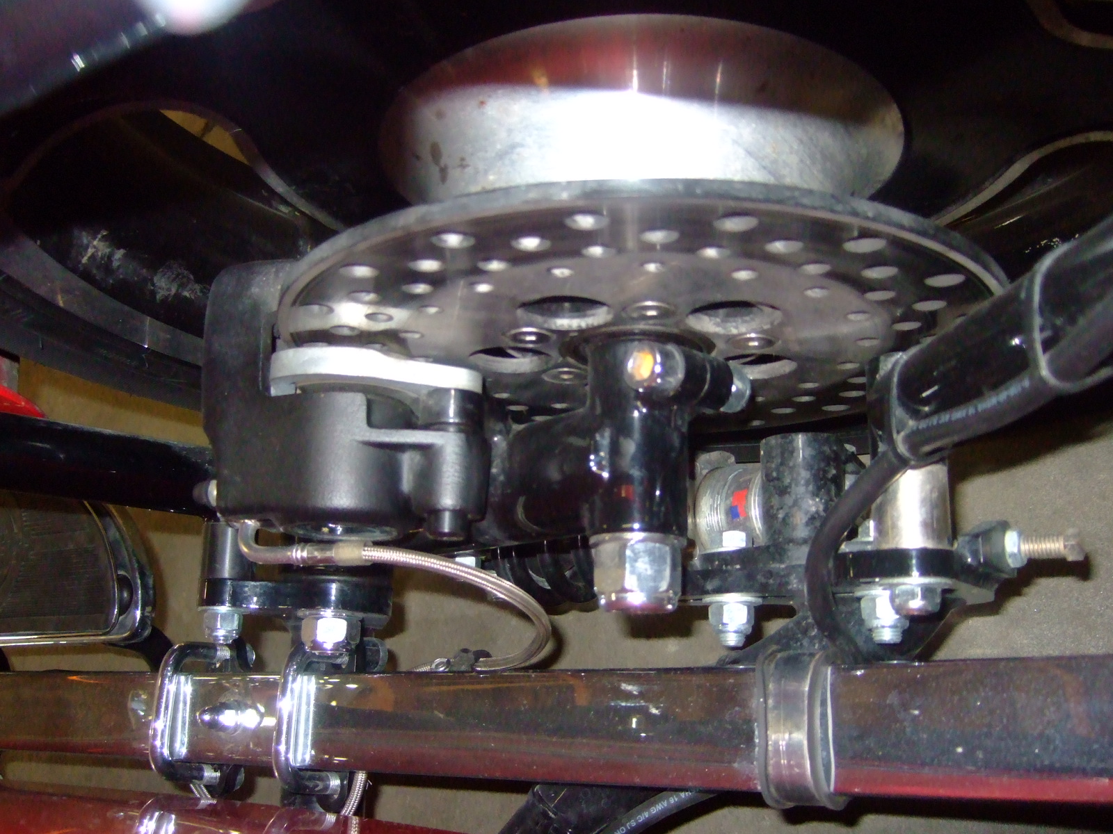

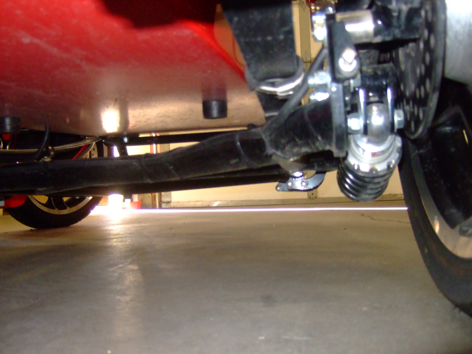

The Liberty sidecar has a sprung swingarm on the frame and also has a sprung tub. I can't say what I really think about that because Lonnie woudl get mad. LOL.
Posted : July 1, 2012 8:49 am
One could use a leaf spring connected to a swingam and do okay but I don't see any up side to it over the use of a coil over shock or maybe a torsion bar for a sidecar.
Posted : July 1, 2012 10:23 am
Gaylord,
Try one, you'll love the ride and so will your monkey.
BTW: My Liberty has multiple leaf springs for the tub and adjustable coil over shock to smooth the potholes.
