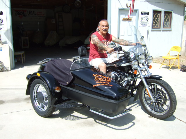

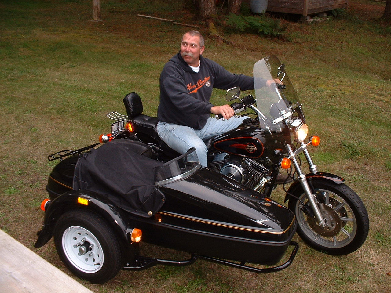

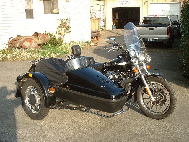

There is more to it then how heavy a bike is, How high the weight is also makes a difference and even how heavy the rider is and if they will ever have a passenger on the rear of the bike as thier weight also adds into the overall equation and while you might get away with the dyna with a lighter rider and no passenger on the bike assuming you never have to make evasive manoeuvers what happens if some one else rides the bike, say you sell it and the new owner is a heavier rider that will have a passenger on the rear of the bike as well as the sidecar. So you now have a heavy bike, with two heavy riders on the bike, when you make a left hand turn a lot of weight is being transfered onto the sidecar, its mounts, frame, suspesion, wheel and axle. You must build to the worst case senerio. Even in Lonnies photo's you can see from the first two photo's that he upgraded the wheel, tire and axle from what is shown in the last photo. If this is good match up, why the up grade?
Posted : July 5, 2012 7:28 am
The later Velorex models on the 2003 and 2008 bikes have the newer Velorex upgraded adjustable suspension. The '91 FRRSP had an early (pre 2005) Velorex which had the 15mm axle and was designed for the 500 JAWA and MZ motorcycles. To support this bike I added my propriatery suspension upgrade kit (worked great even with the 280# Canuck aboard in the picture) and 75# of ballast. I bought the bike from him as a solo and added the hack
The later Cruiser Models of Velorex have the 20mm axles and upgraded suspension, swingarm and adjustable shock. They and the Touring Models have bigger wheels too and the Touring models all have a triple tube reinforced frame and wider wheel with 130x90x16" tire to support late model Cruiser bikes.
We still don't recommend the Velorexs for use with the big baggers and heavy Cruisers.
I don't know of any manufacturer who will recommend putting two heavyweights on the bike and noone in the sidecar. Do you?
I always recommend that tha driver has a heavy sidecar or enough ballast to offset the bike load.
Common sense is always a good addition to any sidehack/ pilot combination. As is knowledge, training and experience.
