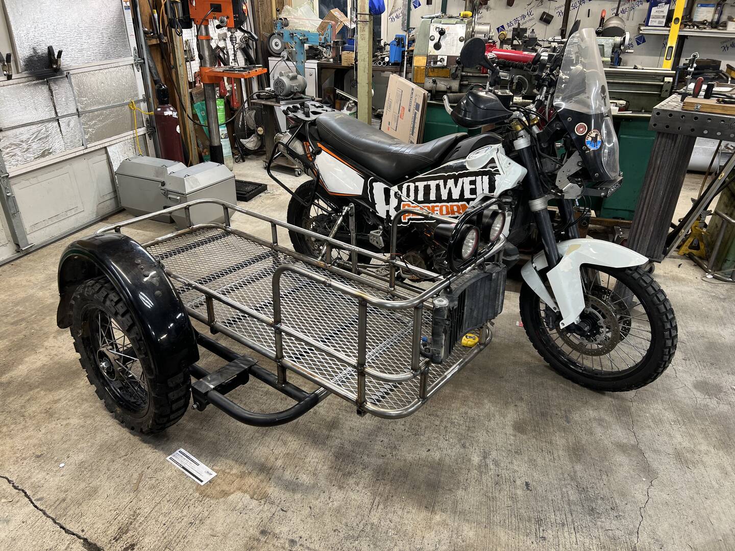

Custom build being fabbed up by 54Vintage sidecars
IMG 9620
IMG 9619
IMG 9618

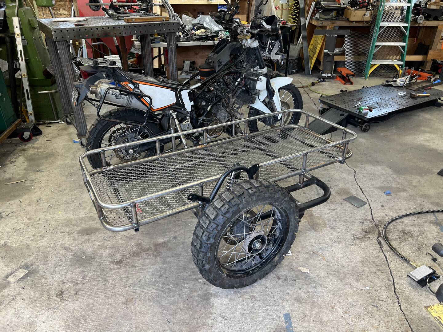

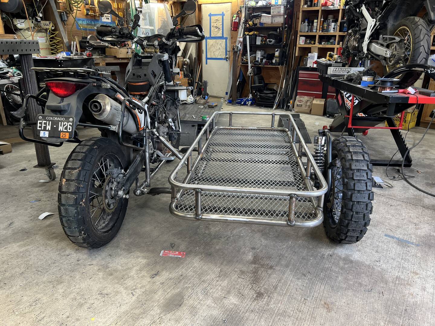

yes it’s wide. 58 inches centered of the rear tire to the center of the sidecar tire. Using a stock KTM rear wheel on the sidecar. So that I can run an knobby on one and a street tire on the other. Different terrains require different things. Two wide to run trails but perfect for fire roads. I also have a spare front wheel that will probably get mounted. Same deal street tire versus knobby. Easy swap to do hard off road if I want to try it. And it’s never a bad idea to have a spare lol8

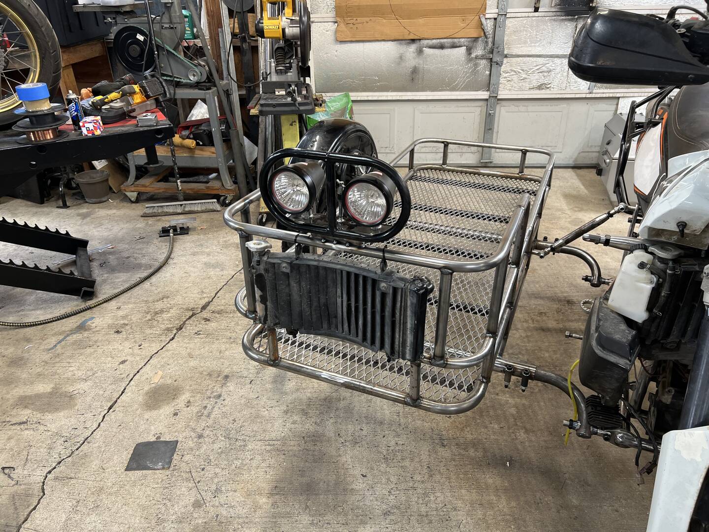

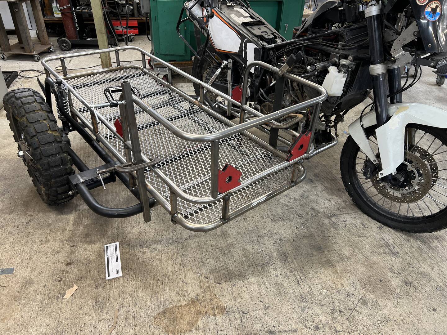

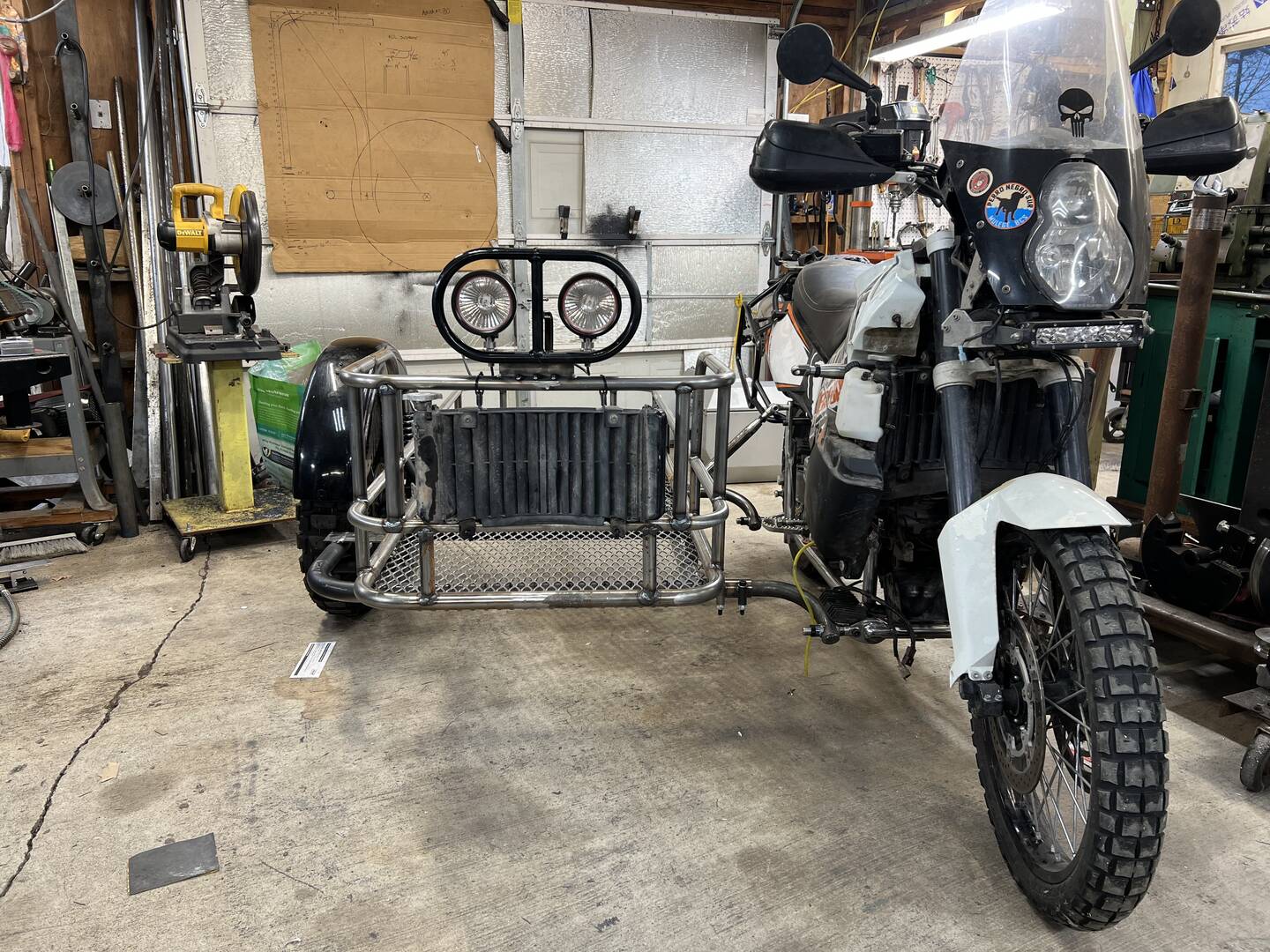

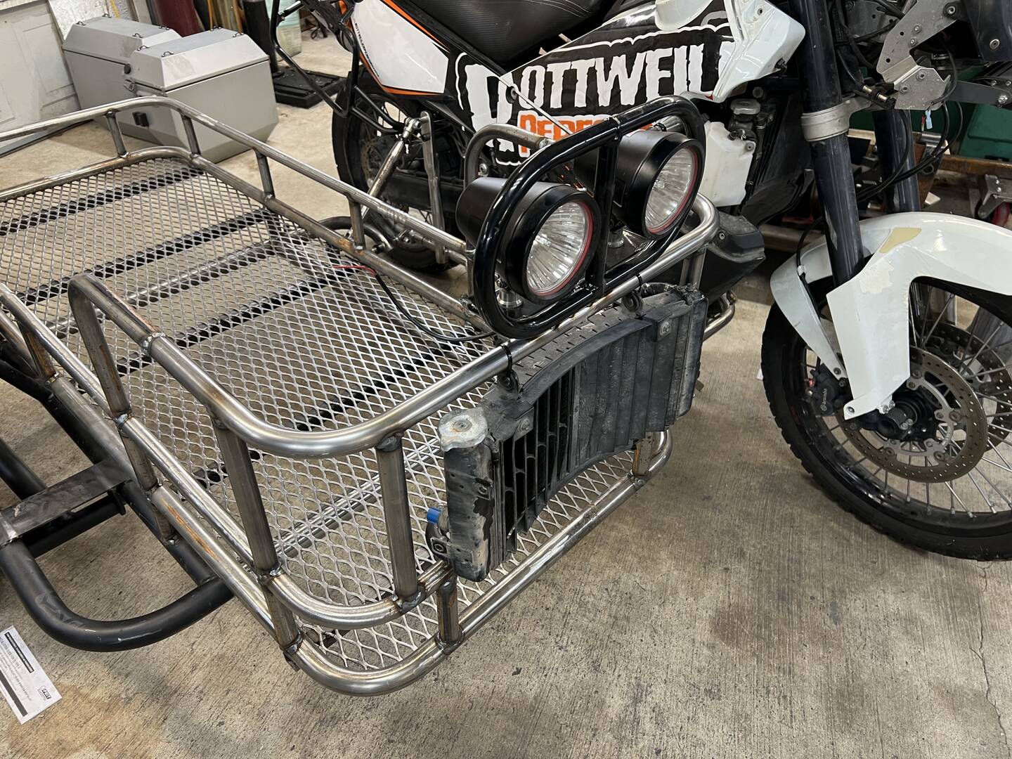

Radiator and lights position for the mounts getting fab up. As well as the fender. Final mock up before he does that welding. Pretty happy overall. The things looking good to me
Posted : March 15, 2026 9:29 am
CCjon, Ben Franklin, Thane Lewis and 3 people reacted
Posts: 1294
I'm digging the big aux lights.  Almost the same height as the bikes headlight, which (imo) is also very cool.  Should work great on the Baja roads.
A nice light bar mounted to the lowest frame tube would be a help to get depth of potholes and whoops.   I find high mounted LED lights makes everything out front look flat.  Especially at higher speeds in the desert.  Almost went arse over tea kettle at a bit over 80mph one night due to this (well, actually due to my stupidity for running that fast at night... lol)  Sucked the seat cover so far up my rump the stitching was tickling my tonsils.
Are you planning to run the two radiators in series, or will the radiator on the sidecar take the place of the one on the bike?

Sheath, the radiators will be running series. The KTM‘s tend to run on the hot side. And now that I’ve added a lot of load to it. I don’t wanna cook the engine. As for the light bar,that’s a great idea. And I definitely want to add light to it for driving it at night. The one thing that should not ever happen is riding it in Baja at night. Because that is lethal. That’s when the Bandidos come out. And they do exist. Yeah I’m real happy with the build so far. I’m gonna have to go out and pick up the bike and sidecar in my truck and bring them back home to finish up.

@qwik , She's going to be a beast!  Oil cooler, as well?  I think you are going to have some fun!

I want to see what kind of temperatures it runs at. If I need to do an oil cooler, I will add one. Plenty of places to put it. LoL
