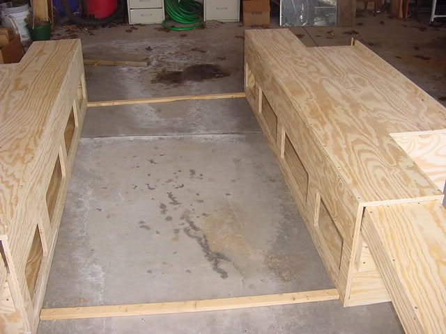

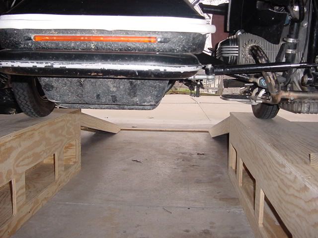

this is what I built and use to get the rig off the floor. just slide the ramps out and drive it up.I can work under the rig very easily. also has side extensions for tool or a car/scissors jack to raise one or more whhla off the surface.
the ramps store inside each workstand and they stack up on top of each other for storage.

a good thing is one stand can be used by itself for a solo bike.has the extensions for both sides. I didnt install the inside ones because I need to get under , between the bike and SC.
one bad thing is you need room for them to ride the bike up. the stand is 8" long, the ramps are 8' long, plus you need the room in front of the ramp to line the rig up. 16' plus the bike.
I have no problem just opening the garage door and pull the bike in front of the ramps, then ride up. or push with help..not for me tho .
the wood strips on the floor are just spacers. cut to size of your rig WB. they are moved out of the way after the rig is up there.
the left ramp is painted with a sand textured paint for great traction for the bike...no slippy!!!
