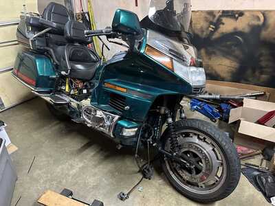

UPDATE:
Well I'm getting closer.  I haven't worked on it near as much as I've wanted to. By the time I get home in the evening I'm shot. It's hell getting old. So it's just been mostly the week ends.
I got the steering bearings done, and the handle bars put back. I need to decide if I'm going to take the time right now and re-do the po's hacked up wiring. It's horrible to look at.
The leading link is installed. I still need to mount the BT-46 on the rim and replace the front wheel bearings. Then I can mount the calipers and bleed the brakes.
If things go right I should get the sidecar mounted this week end. Heck. I still have to finish installing the convertible top for "Sidecar Willie".  Gotta keep the sun off my boy.
Then I will need to do a near by fully loaded camping trip just to see how things go. I've never went on the Wing. Normally I go truck camping in the F-150. Wilton is used to sleeping in a 10x14 canvas tent. His furry little arse is downsizing to a 3 man tent on a single wide air matress,,,,,lol.
Here's where I'm at right now. I had see what it looked like so I put the original wheel back on so I could at least sit on it,,,lol. I'm dying to ride it but I know I can't with out the sidecar.

Posts: 1874
Calvin,  Caretaker of  Sidecar  Willie,  it sounds like you are  making  great progress....don't  disparage yourself.
On the BT-46  , if it's  the rear tire....being  mounted on  to the  front wheel....make sure you have  it mounted  backwards....opposite the  directional  arrow.
The bike/Sidecar  WIRING may look hacked up horrible,  BUT....before you  cut any wires....check to see if everything  actually works....actually  functioning.
Then.... ONE WIRE AT A TIME.
On a serious note,  do whatever you  can to  attend the  Flint Hills Sidecar Rally,  because  surrounding  yourself  with  50+ other  Olde guys, and 5 young ladies, will comfort your  feelings and questions about  where you are  with this  Sidecar  project.
Every  person  there  will  offer you  encouragement.
Posted : July 15, 2024 9:59 pm

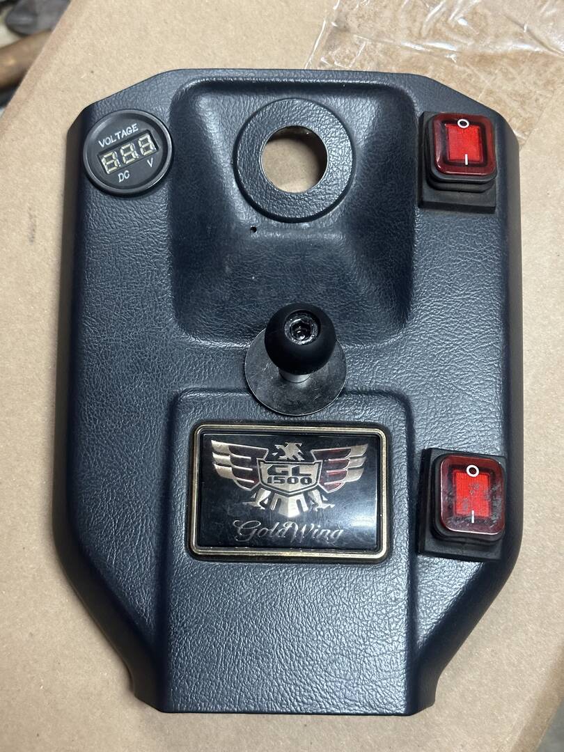

As far as the wiring goes. The main issue is he has 2 big rocker switches for the lower driving lights mounted in the ignition switch cover. One of the rocker switches is loose in the hole he cut too big. And there's a amp meter that flickers off and on. I followed the wires down to the driving light. It looks like there's a wire missing from a spade connector that is taped up, where he tied in for something. That might explain a random wire going through the inside of a saddle bag running the rear lights. Don't know until I get a good, deep look.
But I really need to swap out the switch cover. It has a broken mounting tab that holds it tight. He had a big hole for a ram mount for a cell phone holder. I used that hole to mount MY ram mount to hold my tablet. But it shakes a lot because of the broken mounting tab on the cover.
I think I'm going to remove the cb and put a factory blank panel there and mount a volt meter and hopefully one switch to work both lower lights? Just thinking about it right now.

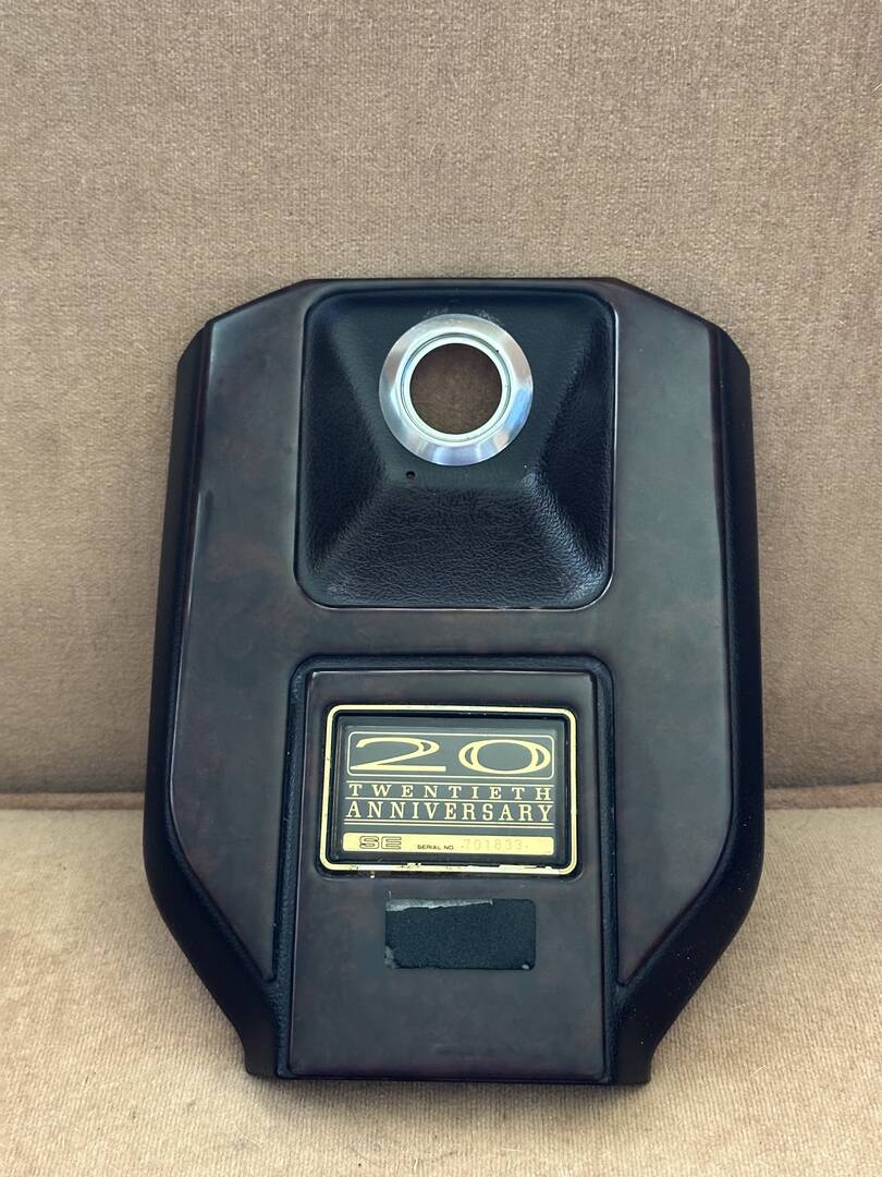

I have a nice switch cover that I got from Paul with the leading link package. But it's brown and I need black. It also has the nice wood grain rubber pad on it. I fear it may leave glue residue all over if I peel it off to paint. I have this cover up for trade on the Goldwing forum. Does anyone here need a nice 20th anniversary cover? I'll trade for a nice black one,,,lol.

Posted : July 16, 2024 7:49 am
Posts: 1874
Calvin, the new tire on the front should be set at 40 psi.
The 13" sidecar tire should be set at 30 psi.
The Austone taxi tire on the rear wheel should be set between 35 to 40 psi.
Check on www.wingstuff.com for things for your bike, like rocker switches, etc.
And, since I will get to the Flint Hills Sidecar Rally before you, I will forewarn everyone to NOT tease you if you have a Brown ignition switch cover, rather than a Black one.
Posted : July 16, 2024 9:59 am
