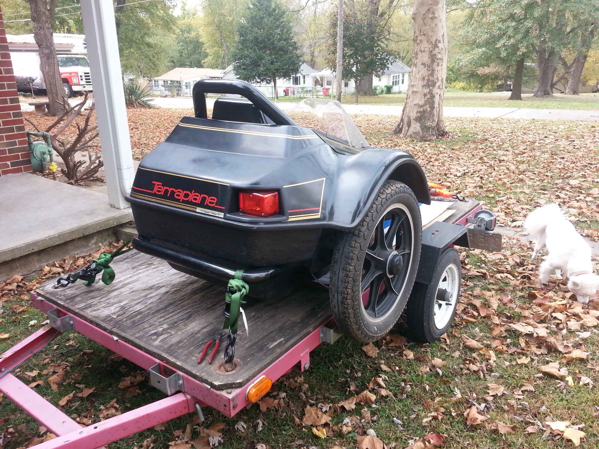

OK, so I'm picking up a Champion Escort and I have to haul it home on the trailer. No Bike attached..
A bike is easy, but having never hauled a Hack can I get some hints on what I can expect?
Here's the trailer..
Sorry I guess I wasn't clear I'll be hauling the Side Car only. Not attached to a Motorcycle.

Picture help?

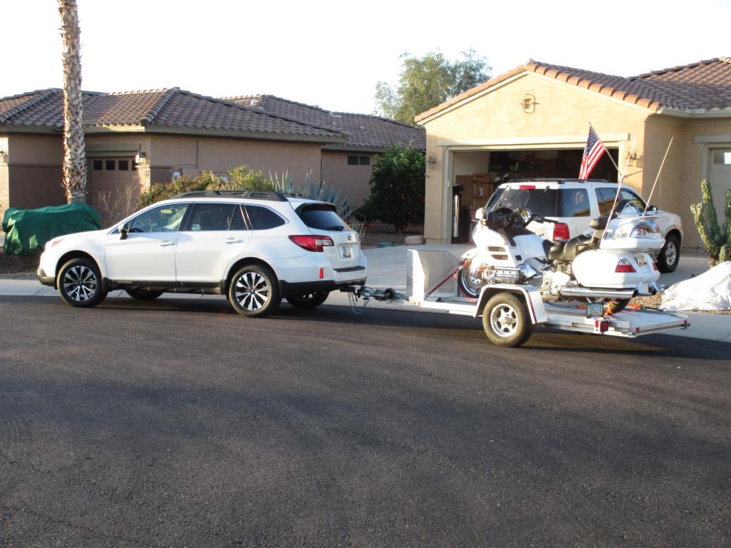

I ty my rig with the bike wheel in a chock, and two ratchet straps one on each side of the front of the bike run from the triple tree. I then run one strap from the rear wheel of the bike to a tie down point across the trailer and one from a point on the sidecar to a tie down point on the opposite side of the trailer in a crisscross pattern. Sidecars have a tendency to "dance" across the trailer when being towed on a trailer. This has worked very well for me! Soft ties work well for attaching the ratchet straps. Just my 2 cents worth

OK, I'm late to this discussion, but if you are still looking for ideas. here's how I carried mine from North Dakota to Kansas City. Very simple with cardboard under it and strapped down solidly. Of course, using the furniture dolly works quite well once you get it home and need to move it around, too! I fabricated a custom dolly for mine when it's not on the bike.

OK here's how I got it done...
