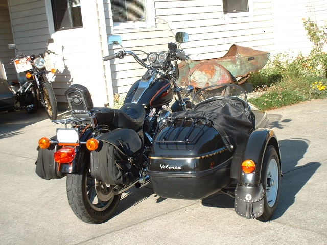

I have an '03 softtail, as best I can tell it has the stock handlebar. I'm a little short on one end (5'-8") and found with the stock risers I had to lean too far forward to reach the bars making my back hurt. I have taken to using a T-bag stuffed with rags, a 2" thick foam pad in front of and attached to the pack for a back rest, and I installed 9" pullback risers with the stock(?) bars and it is a very comfortable riding position, kinda' like sitting in an easy chair. The risers are PN 500-740, pg 784 from the J&P Cycles catalog. They are also on the net at www.jpcycles.com. For $75.00 for the risers and whatever it cost for the control mods has been the best money I ever spent. I can ride all day and my back feels great! I also installed PN 531-006 and PN 531-009, pg 872, same catalog. These are the Ultimate Highway Mounts and 3" extension pegs. Just like having the footrest on your recliner attached to the bike. The reason I used these is they cleared the front down brace for the sidecar. Hope this gives you some good info to think about!
Chris
'03 Fatboy
Champion Legend Hack
