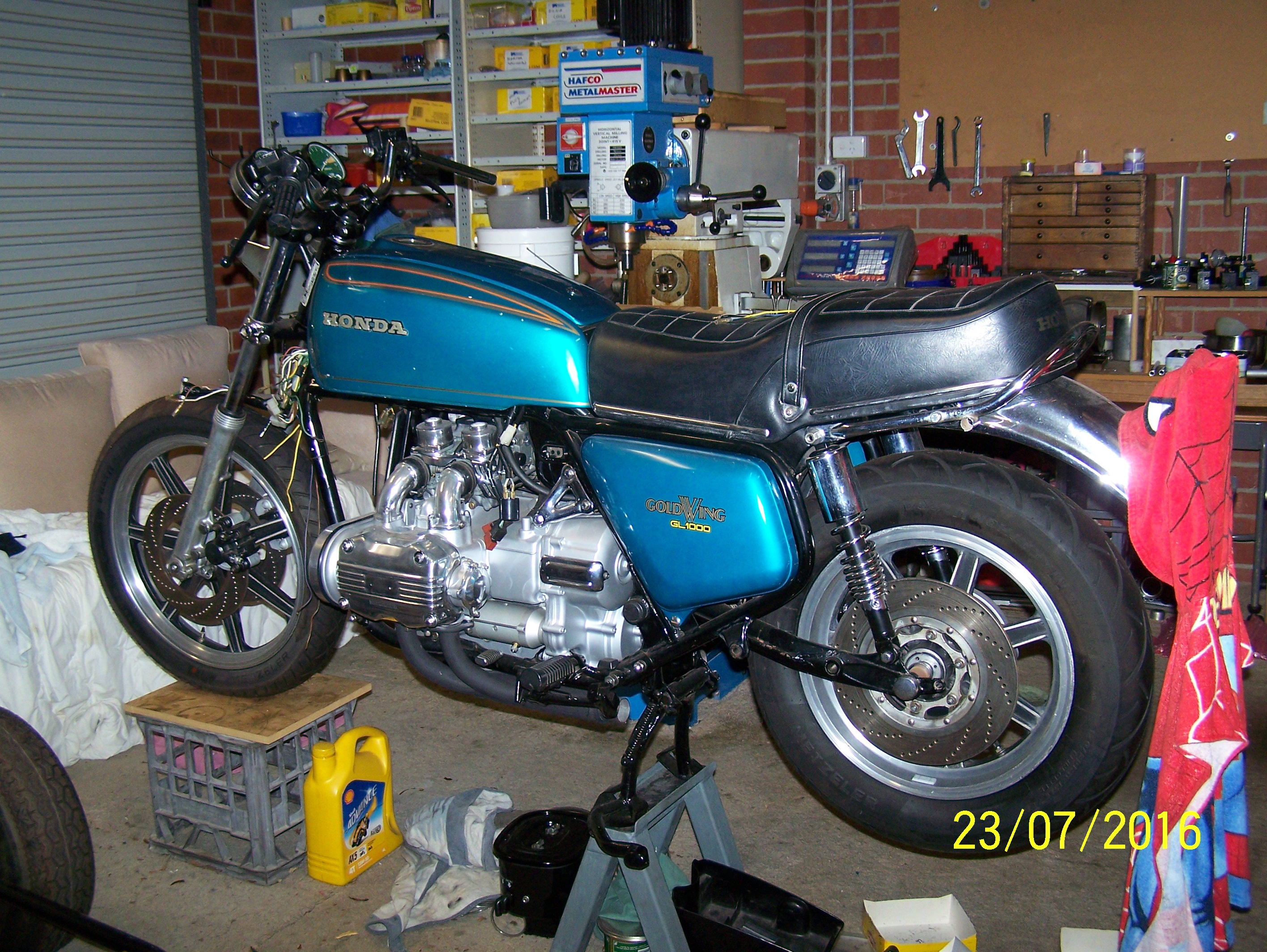

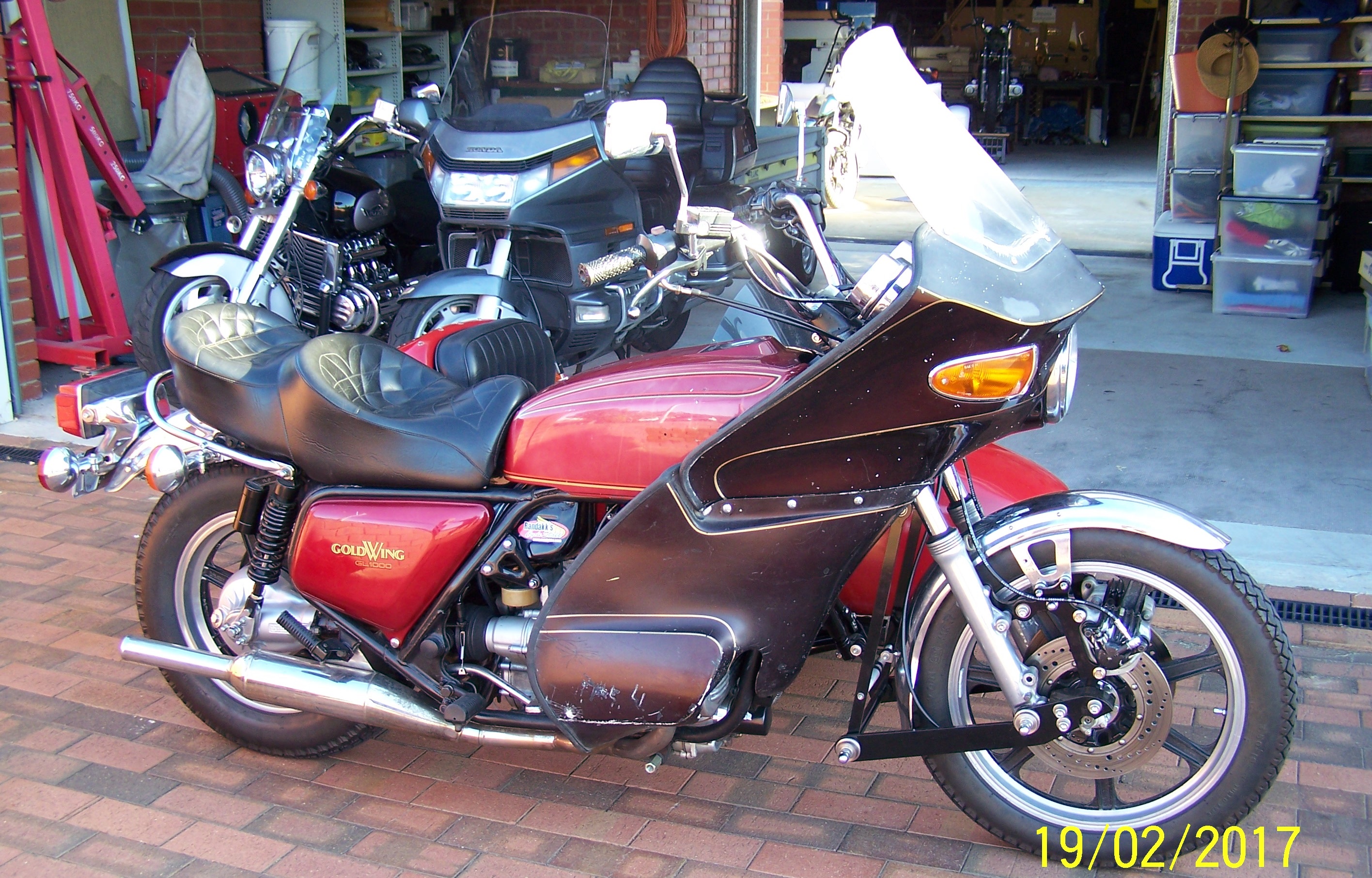

I have a 1976 Goldwing with a DJP outfit which is still in the commissioning stages, handles great but runs like crap! I have rebuilt the engine but used non OEM float valves (new ones in a bag on the workbench), the boat has to come off for some fiberglass repairs and modifications to gain a roadworthy permit so I will change them out then. The front end is of my own design and took 18 months to manufacture piece by piece.

that's a nice looking set up, interesting lowers you have in the wing, never seen that before. The bike looks to be in very nice condition
what model car is that, pretty sharp looking

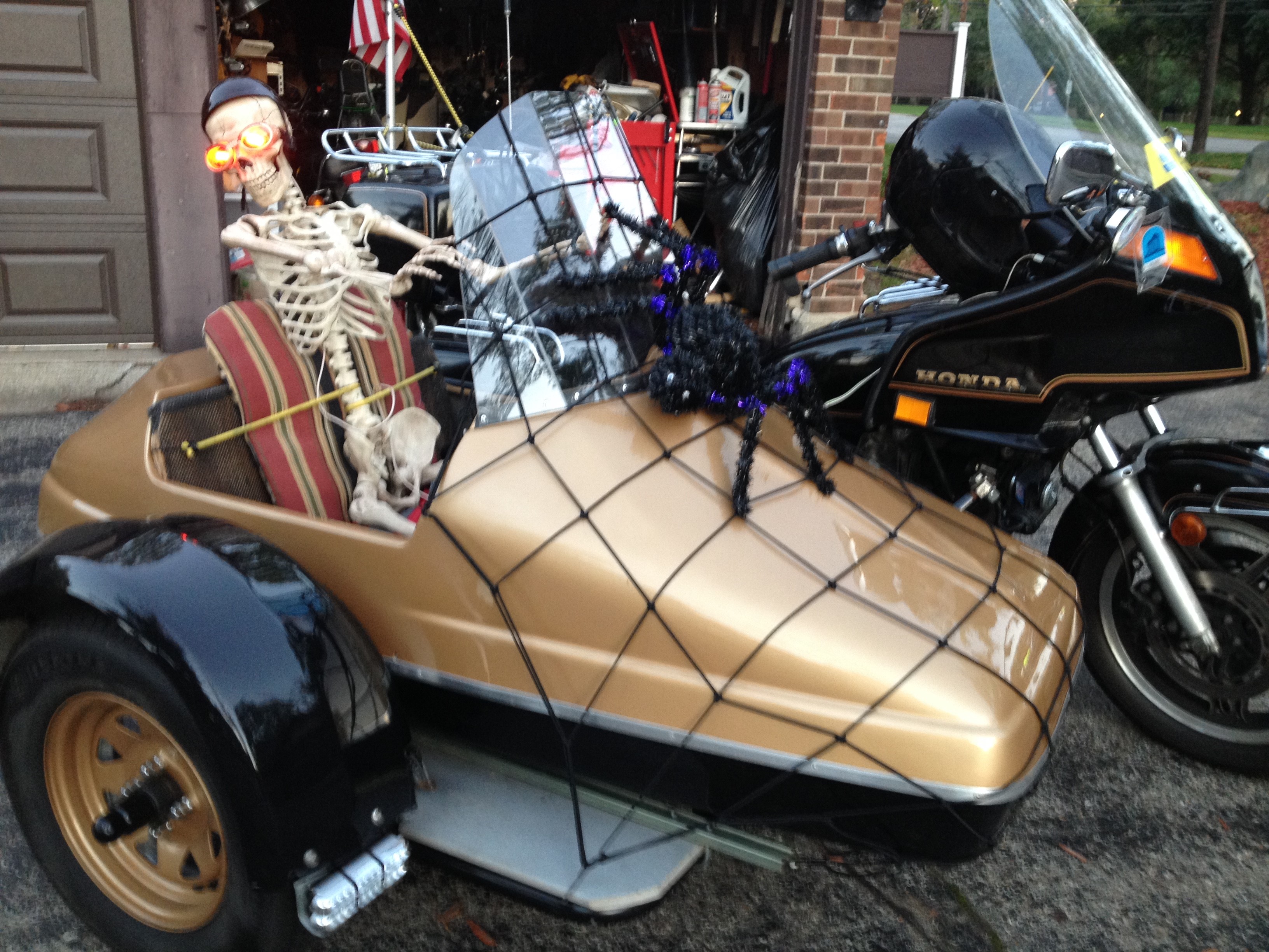

The fairing is a "Rickman, Polaris" from the mid 70's and the boat is a "DJP" (David John Pearce) also from the mid 70's. This outfit is made up from 2nds (parts), my 1975 has all the Prize parts fitted (pictured)

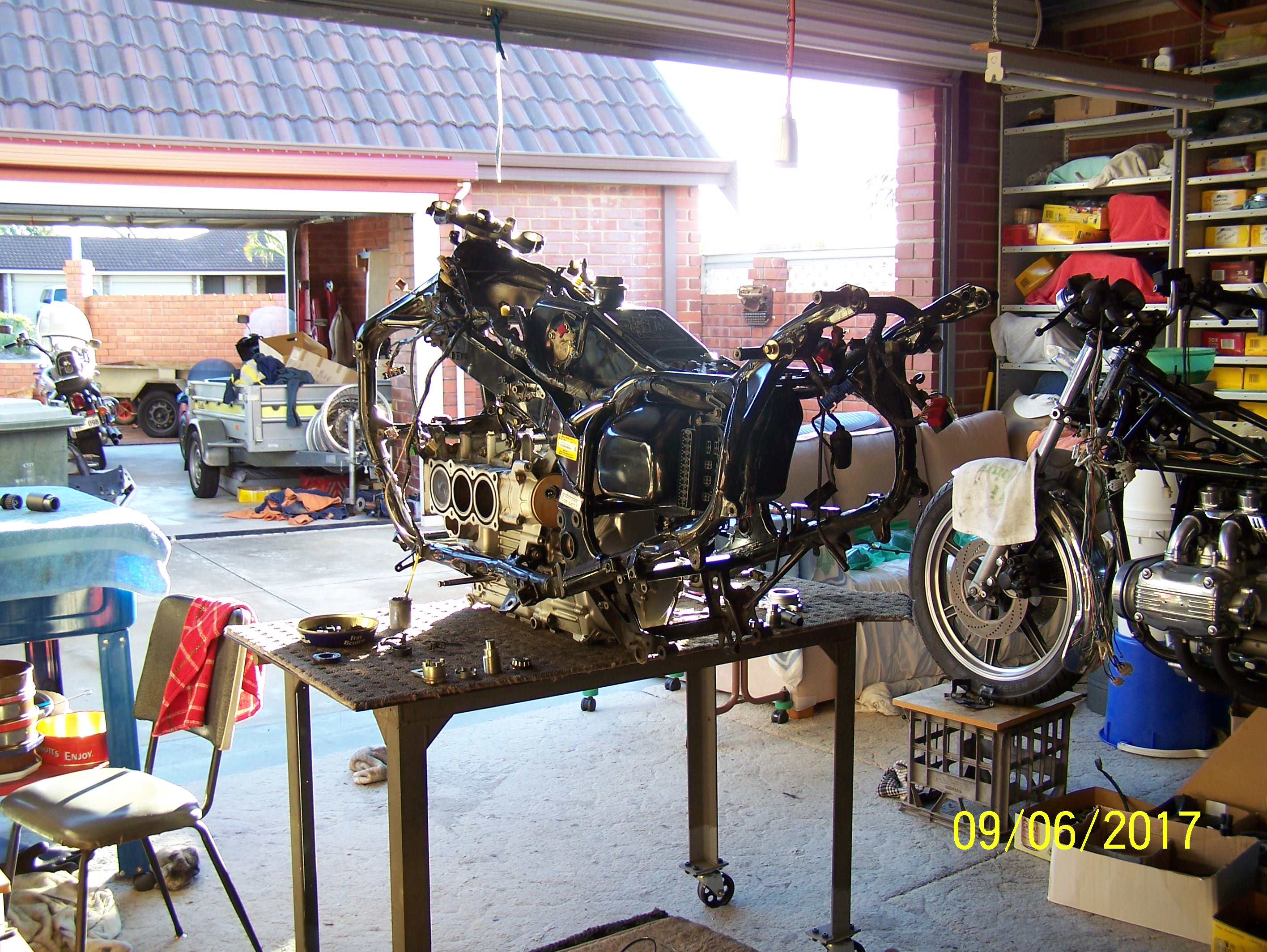

Perhaps a stiffer bike stand for your shop would do well 😉 ...a nice help in my shop is a double A frame on roller skates with a 1 ton tackling. A couple of tip overs have been avoided by teathering the girls.
On the red one, isn't the bu..er* a bit too low for Skippy?

Yes, the "Roo-Bar" is a little low, but will come in handy when moving abandoned shopping trolleys in car parks 🙂 if too heavy she will come off? I am led to believe she will be arriving in Kewdale freight yard tomorrow, I work 1000 miles away from home and fly home Monday night so I am hoping to pick her up on Tuesday 🙂
The milk-crate stand is only a temp one to keep her at working height and out of my way, I have a bigger workbench which I hoist up my bikes when I work on them.

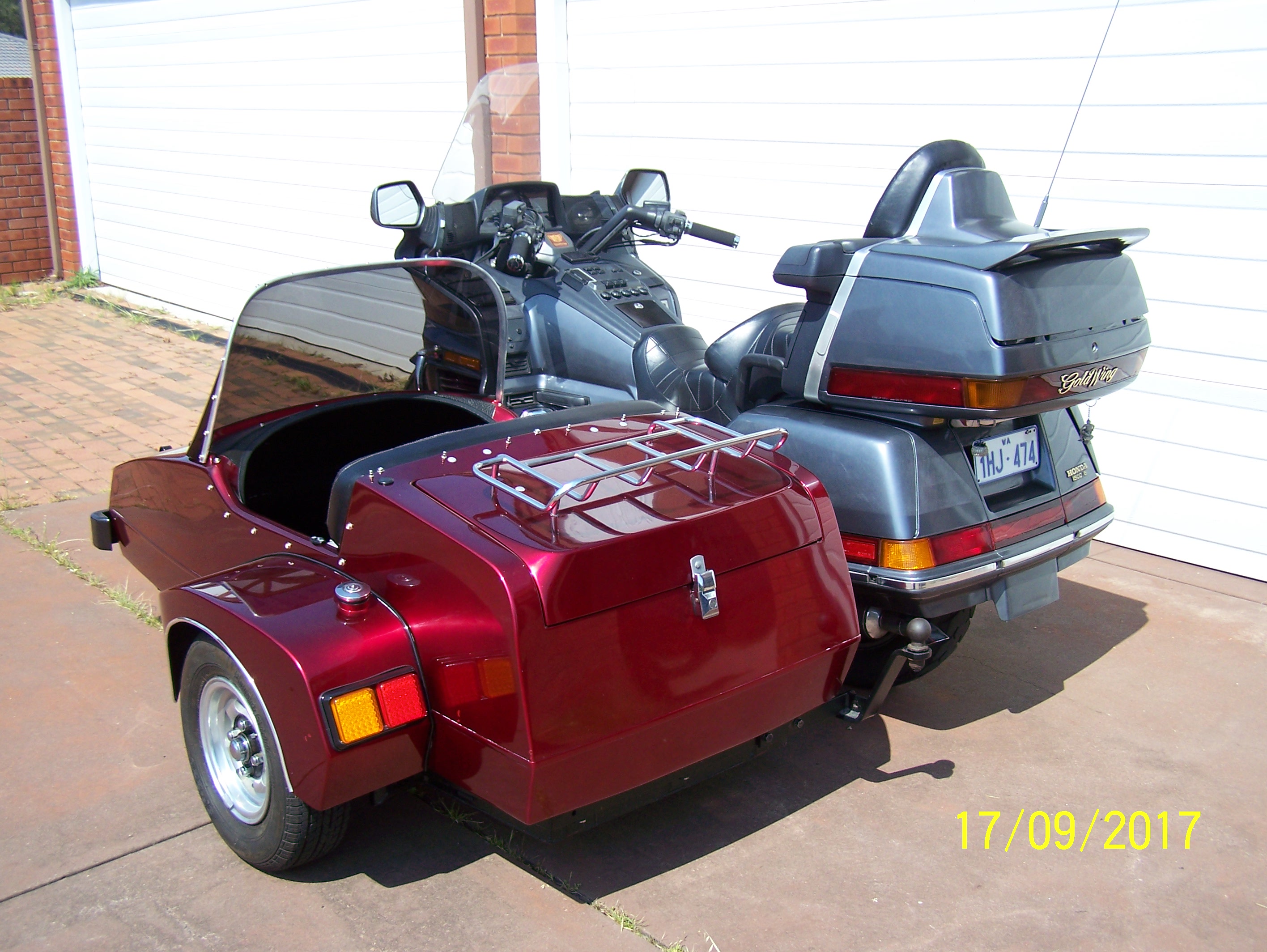

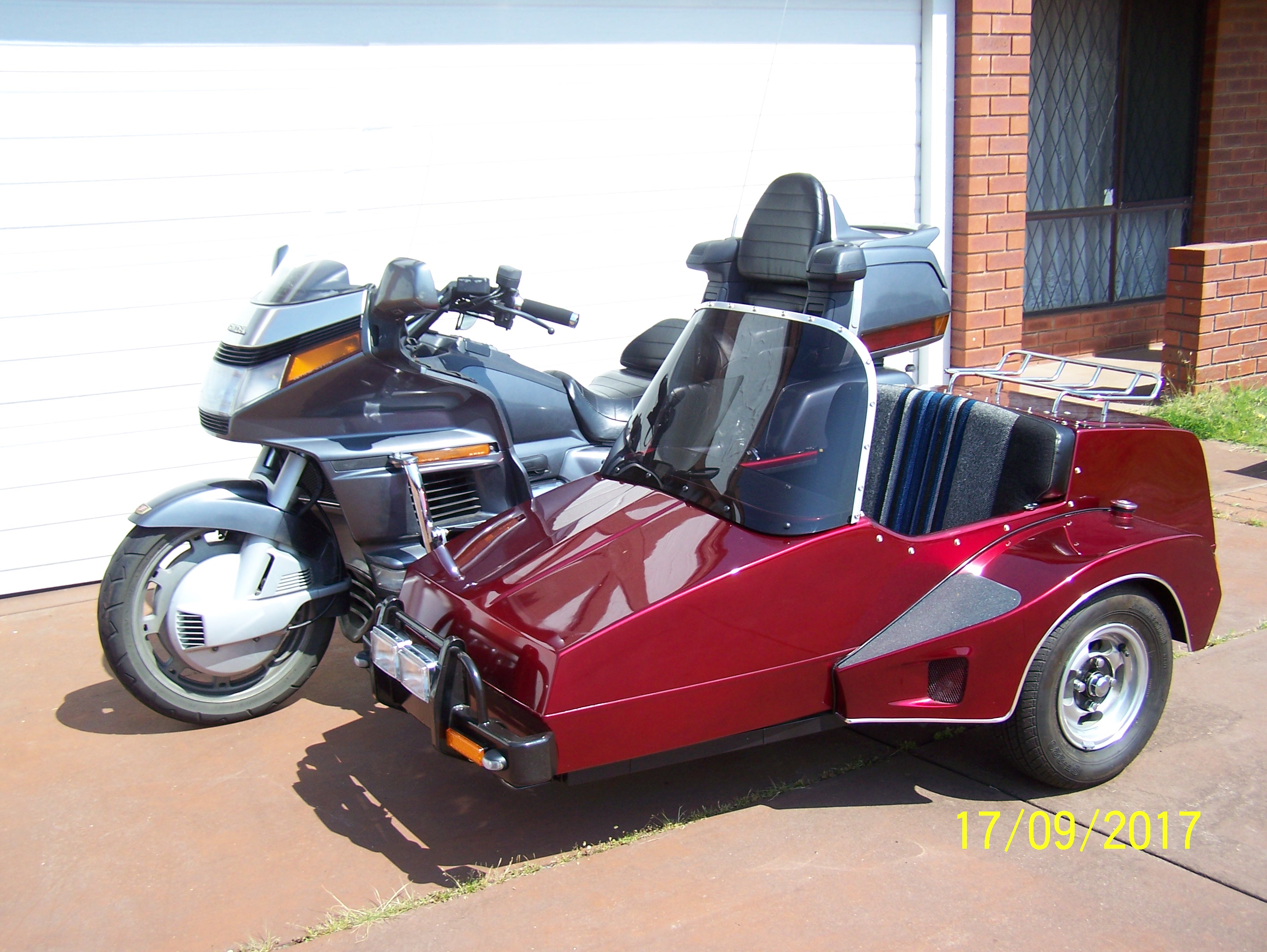

Ooops! ... missed a pic in the middle, I still need to work out how to put a caption for each pic, but the above is my latest acquisition, a 1990 SE and having a birthday of a lifetime.

in deed a Golden "striptease"
Peter, you are well equipped, go for the new one.

Well Folks, I finally got her on the road, the hard part was carefully nibbling away the Tupperware so as to not make a mess of her.
She handles well and no fears on Left handers, takes a lot of effort to fly her. She has the wobbles under 70kmh and bad at 40kmh but down the freeway at 100kmh she purrs along. A leading link is now on order from "Wasp".

The low speed wobble can be taken care of by a hydraulic damper. Sometimes even with just snug a tad the steering head bearing nut.
