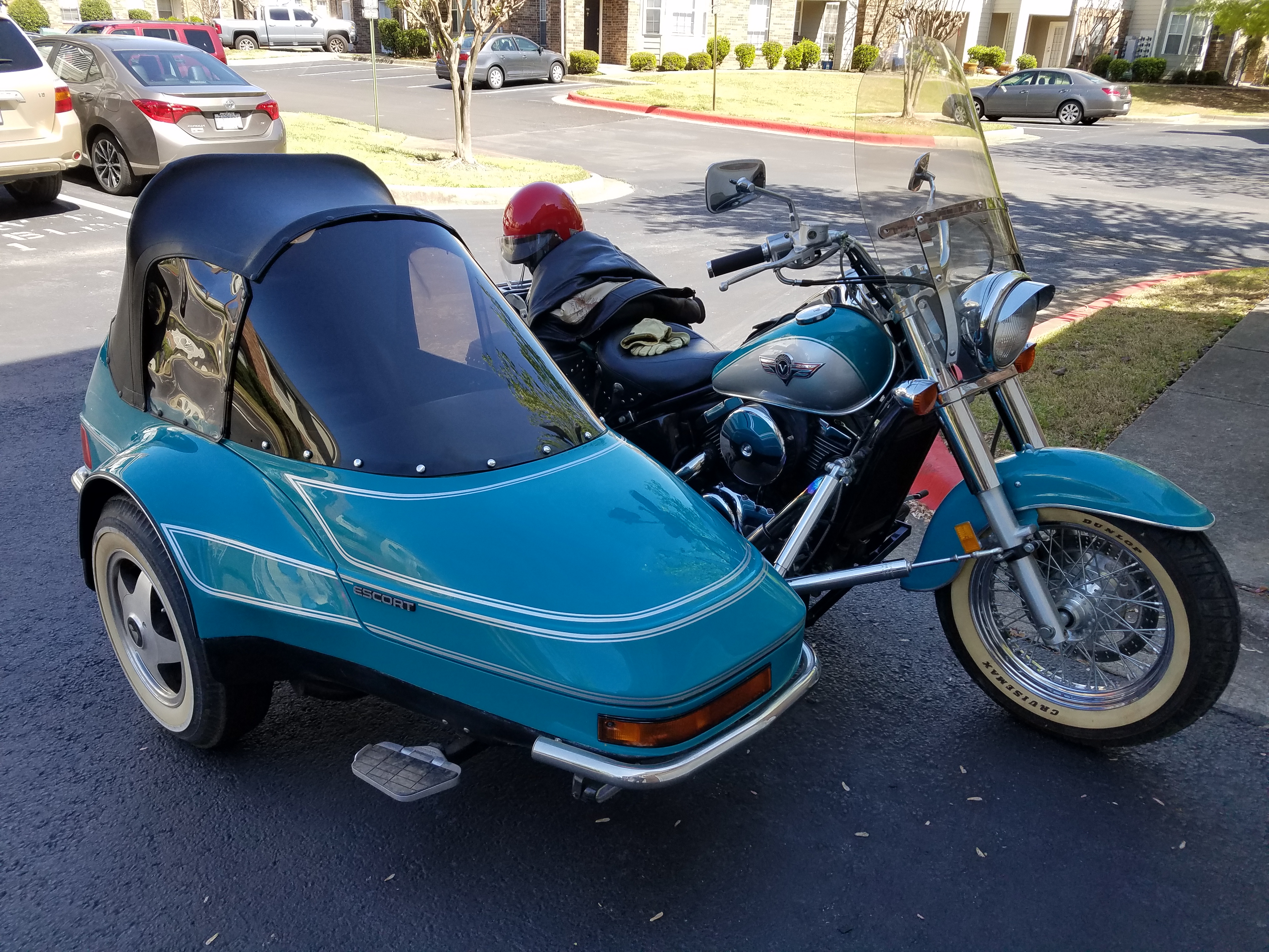

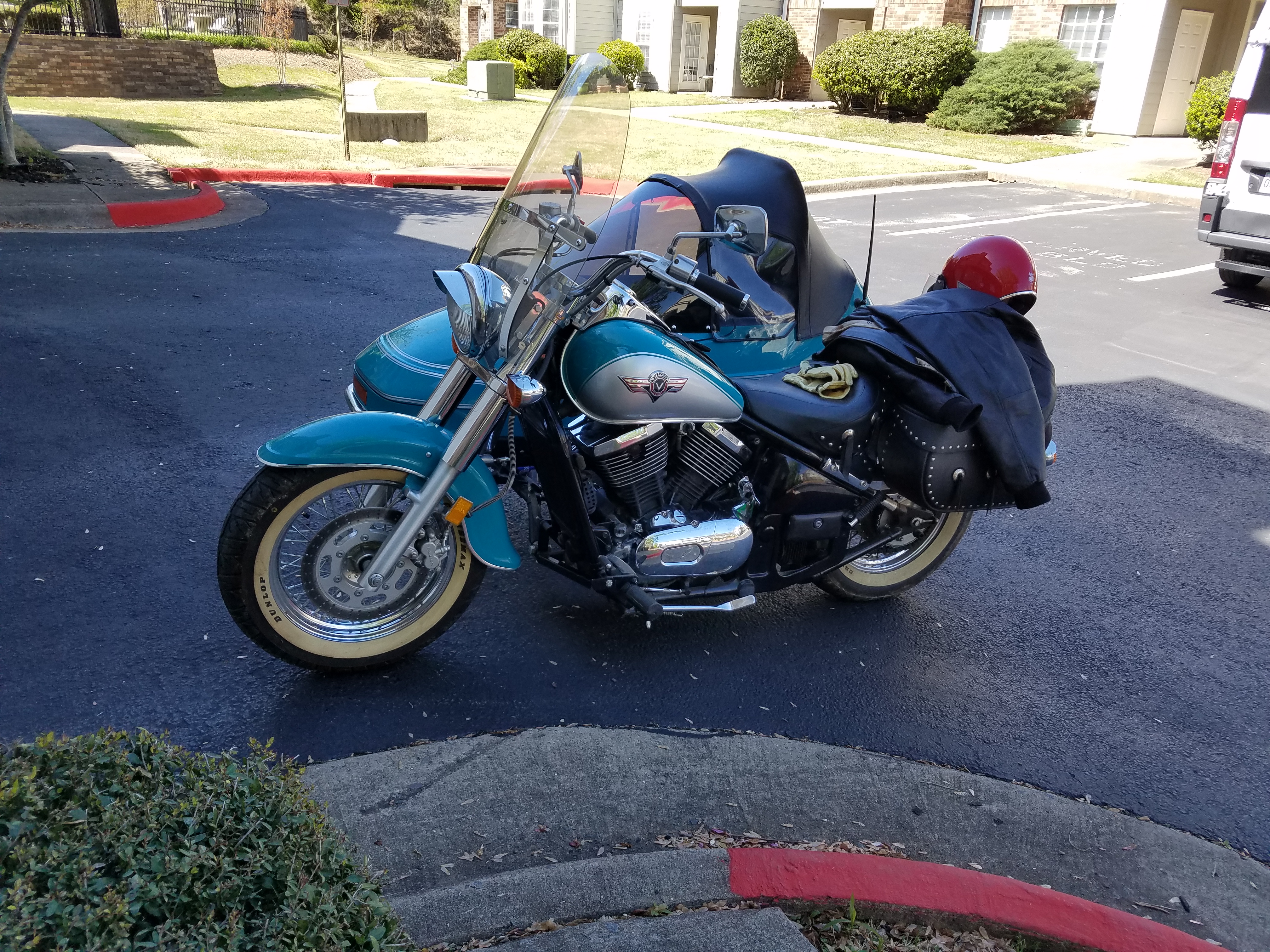

Finally got me a full rig. The last few months have been a roller coaster ride after getting into my head I wanted to get in to the world of sidecarist. First I thought I had the extra cash to put a rig on my Harley. Picked up 1979 Velorex cheap to restore. But the IRS had other plans for my extra cash. Then the State taxman decided he needed more from me then I planned and I had to part with my Harley to pay him. But low and behold I had some cash left over from selling my Harley and I find someone who had a complete rig and they too needed cash to pay the taxman.  To get the cash they decided to sell their Kawasaki/Champion Escort rig. So now I am a proud owner of a low mileage yet older Vulcan 800 classic with a Champion factory installed Escort. Only issue is a faulty petcock from setting in storage too long.

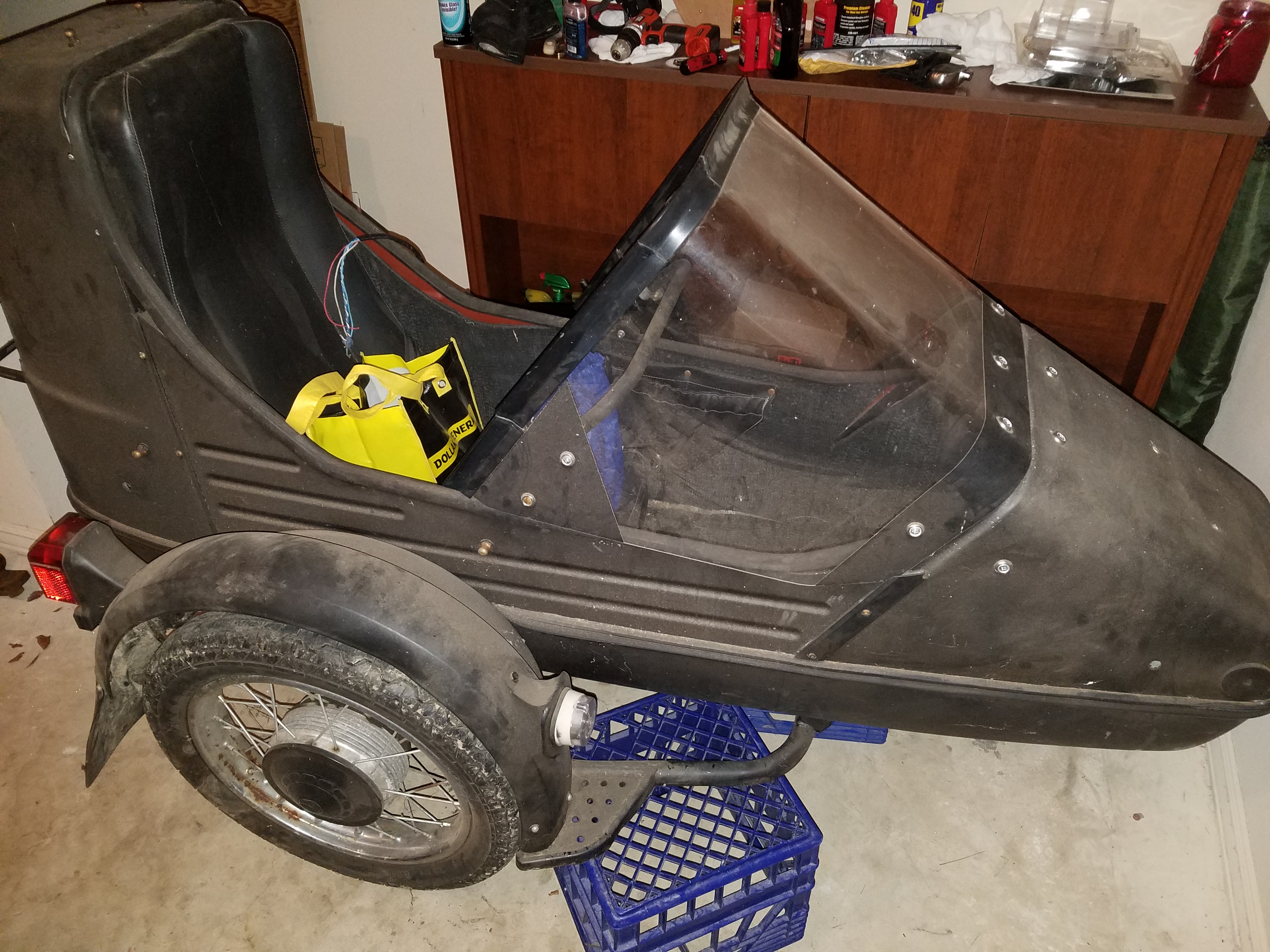

By the way I have a 1979 Velorex 700 in need of restoration if any one interested $600 located in Little Rock, AR

Glad you got stuff sorted, and still riding! 🙂 I'm in the middle of re-doing my Velorex, it's a 562, but if someone wants some noobie help, have them PM me. I'd need to check, but I think the 700 had a decent axle & suspension from the beginning, I need to redo mine.

The tax man giveth and the tax man taketh away. That's a fine looking rig. Looks like the Escort is tricked out with all the options. I have an Escort on my Valk and really like it though not painted to match. Like the whitewall. Was it a local bike?

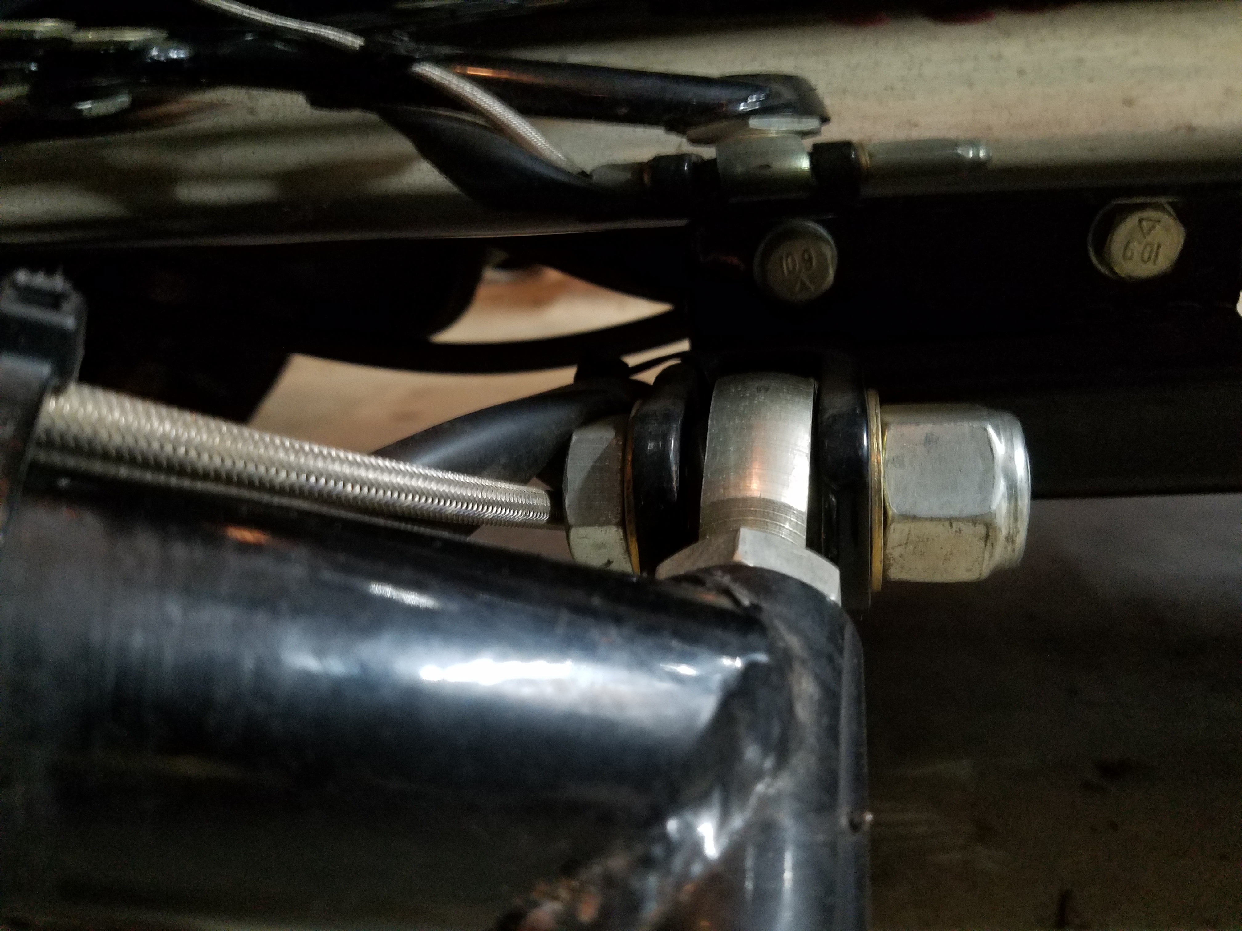

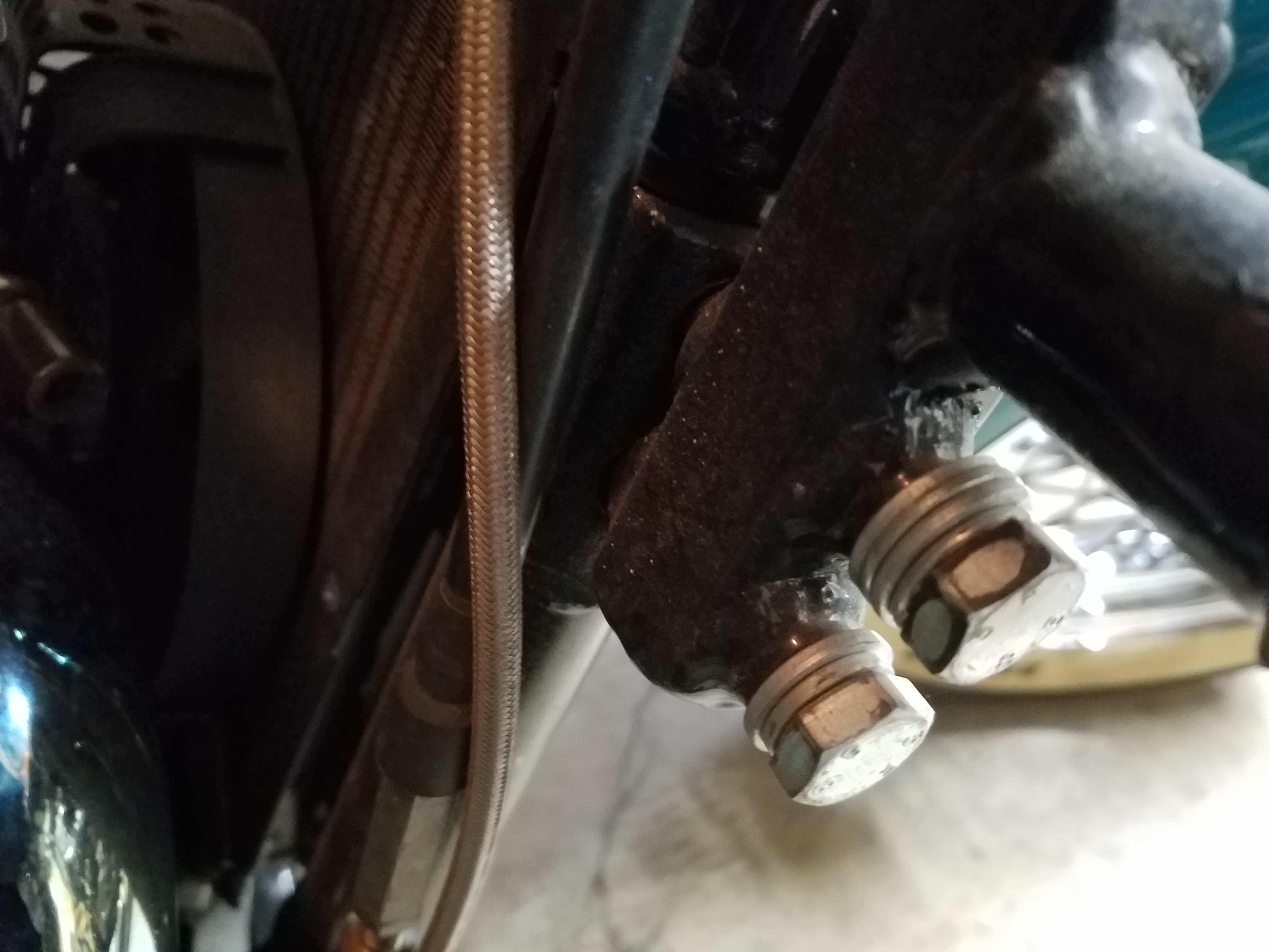

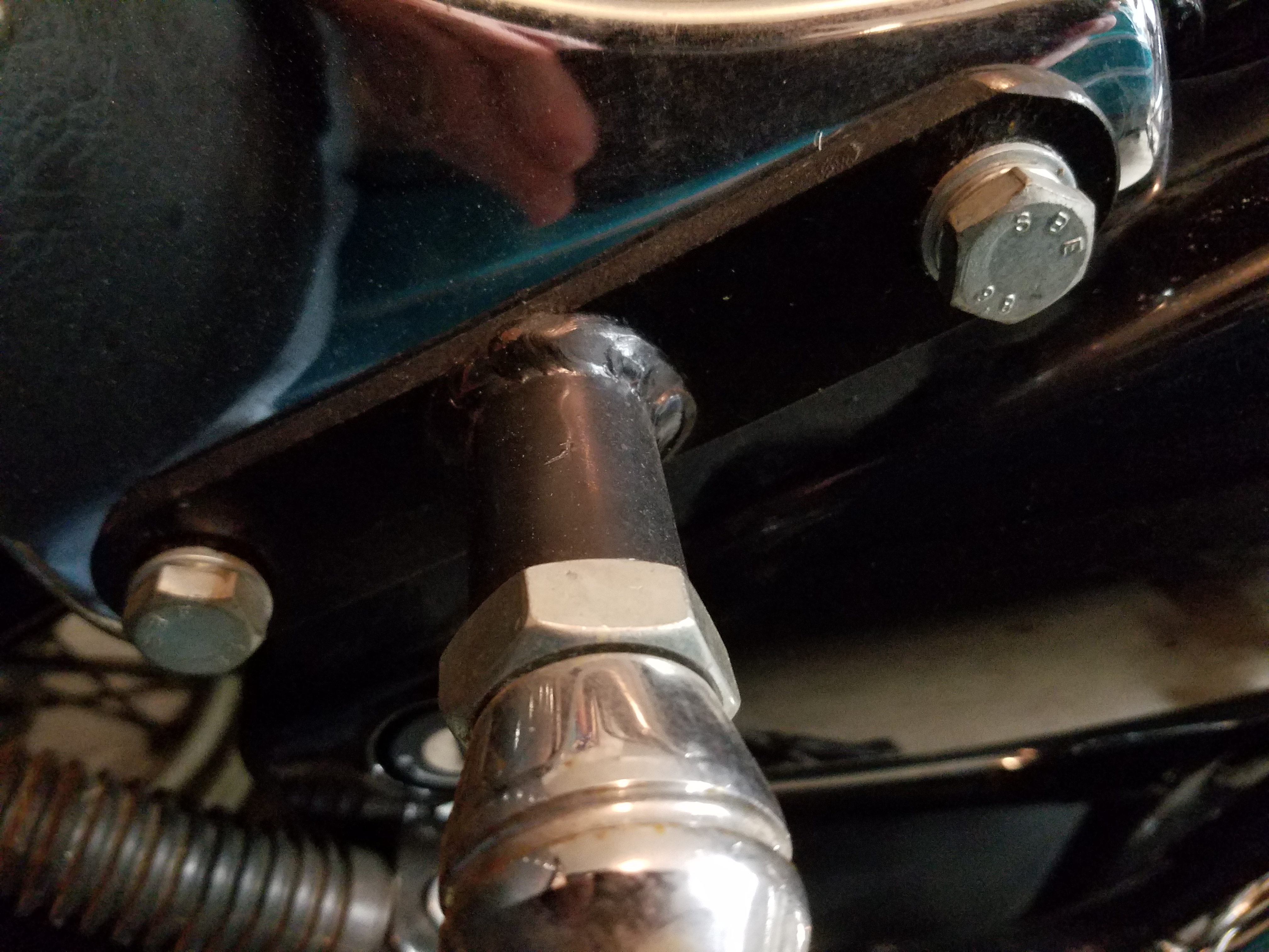

That's a nice looking rig, and a good starter rig. I've heard that the Vulcan 800 was made at the Kawasaki factory in Nebraska. But do you really think the sidecar was installed there? If yes, it would be nice to see some close-up pics of the struts and mounting points on the bike.

I am sorry I didn't mean to indicate the Kawasaki Factory, in fact the VN800 were built in Japan, but at the Champion factory, the person who had the car installed claims the local Kawasaki dealer sent the bike in 1999 to California to the Champion factory to have the sidecar installed. We have no sidecar dealerships in Arkansas. Maybe it was sent to a champion dealership in California, I am just repeating what I have been told. Here are pictures of the connections. Every connection is using the bikes "natural" bolt holes, if that is makes since?

In my research there seems to been a change of the Model 700 axle since it was first built, I couldn't say if the original axle is inferior quality or not. the one I have was built in 1989.

Well, just measure the diameter. If it's 15mm, it's might be due for an upgrade. The 20mm seems to be the minimum most would accept for a decent sized bike. (Bigger than a Rebel, say.) The trailer wheel upgrade seems pretty consistent with 25mm (1").
I'm using a 35 mm (1 3/8"), but I figure not only is bigger better, but I need more weight in the car anyhow. Definitely overkill on that one, but the frame will bend before the axle ever will. 🙂
