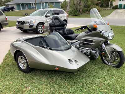

Are you talking about this one ?????
https://www.sidecar.com/forum/complete-rigs-for-sale/2003-goldwing-with-hannigan-bandido/#post-85187
250 IMG2296

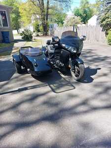

So the two I am currently looking at are the one you mentioned above - the silver '03 Wing with the Bandito sidecar and this '13 Wing with the Classic sidecar.
https://www.facebook.com/marketplace/item/451346150783310/?ref=saved&referral_code=null
Any thoughts on these two units would be appreciated.

Mike @bannerguy...here is my comparison of those two rigs you are looking at:
2013 Honda F6B:  In Mass....I see rusty connections at some of the sidecar mounts, 99% chance they are just surface rust, and can be cleaned up.
The Honda F6B does NOT have Reverse, but that is not a big deal, depending on YOUR physical abilities, as pushing these backwards is relatively easy, just be mindful of where you park. The Cobra 6 in 6 exhaust on the F6B is going to be LOUD...I know...and I am hard of hearing, so think about your two dogs, and your grandkids. The F6B is $ 2,000 more than the other rig. But, at least it does have the correct Front Tire on the F6B. But it does have almost twice the overall mileage than the other bike. In the world of Honda Goldwing 1800's, mileage is NOT a big deal, and for someone like me, I would prefer the 35k miles on it, vs the 20k on the other rig. That tells me it has been ridden more miles in 11 years, than the other bike has in 21 year.
The 2003 Honda Goldwing 1800, has Reverse, has self-cancelling turn signals, shows less rust on surfaces, but...it too is an East Coast bike, being in Florida, so LOOK for surface rust, and remove it. This bike has stock exhaust, so it will be quieter....dogs & grandkids. This Hannigan Bandito double is wider, so easier to carry both dogs, AND both grandkids, all at the same time, or...one dog, one grandkid, then the other dog, other grandkid (you get the idea)
The 2003 Goldwings did have a FRAME recall, and there is a 99% chance that this bike's frame has been addressed, but it is best to check, most especially since it is now tugging a sidecar alongside it. I could explain to you how to check if the recall has been done, but...its' a visual inspection for a few dimples they hammer into the area that was inspected and fixed, so you need to know where to look. Most likely any Honda dealer can check the VIN, and verify if that bike has had the frame recall performed. (I would NOT put a lot of weight into the decision making of which rig to buy, based on this frame recall)
This 2003 Wing, is painted Platinum color, and it last much longer, and easier to clean, and keep clean, than the Black Honda F6B.
The ad for the F6B says it comes with a "hard top"....yet it shows in the 3rd picture that it is a soft top convertible. That is a nice top, and usable on rainy days or cold days, but....also confines the passenger, whether the passengers bark or whine.
YOU, Mike, need to decide if Mass or Florida is worth going to to pick up this rig (because...We, The People have no idea of where you live) so let's say you live in Borneo, and that is a long distance from Borneo to the East Coast of the USA.
The 2013 bike is 10 years newer, but....has almost twice the mileage. The 2003 Wing is 10 years older, but half the mileage. Almost identical engine, transmission, and rear differential on both bikes.
The 2003 Wing has an 1100 watt alternator, and the engine mapping was tuned for a marathon bike, long distance, higher overall top speed.
The 2013 F6B has a 1200 watt alternator (if I remember correctly) but it is still big enough to power a small city, BUT...and this is an important (at least to me), these Honda F6B engines were mapped to be more of a Sprinter....much quicker from 0 to 125 mph, just don't ask it to go 126 mph, as it will cut the fuel to 2 cylinders, and stumble at 126 mph.
REALITY.....you are going to spend ZERO time with this or any sidecar rig at speeds in excess of 120 mph.
Therefore, and Ergo, the F6B is engine mapped better for hauling a sidecar attached to it, than the Goldwing 1800 is, simply due to the added grunt at lower speeds.
Were it ME...I would lean towards the 2003 Goldwing with double Bandito, less mileage, less money, but gets reverse, and a few smaller items that are on the Goldwing 1800's that are not on the F6B's.
Personally, I think that BOTH bikes/sidecar rigs are overpriced. If it were me buying, I would offer $ 16k even for the 2003 Wing w/Bandito, and I would offer the exact same price, $ 16k for the F6B/Hannigan Classic.
Ironically...I have owned a brand new 2003 Wing, this same color, and owned a brand new 2013 Honda F6B, this same color..so I have direct experience with both bikes.
Ultimately it is your choice, feel out the sellers....Paul selling the 2003 Wing is known here, get a sense of which one feels right for YOUR needs and wants.
