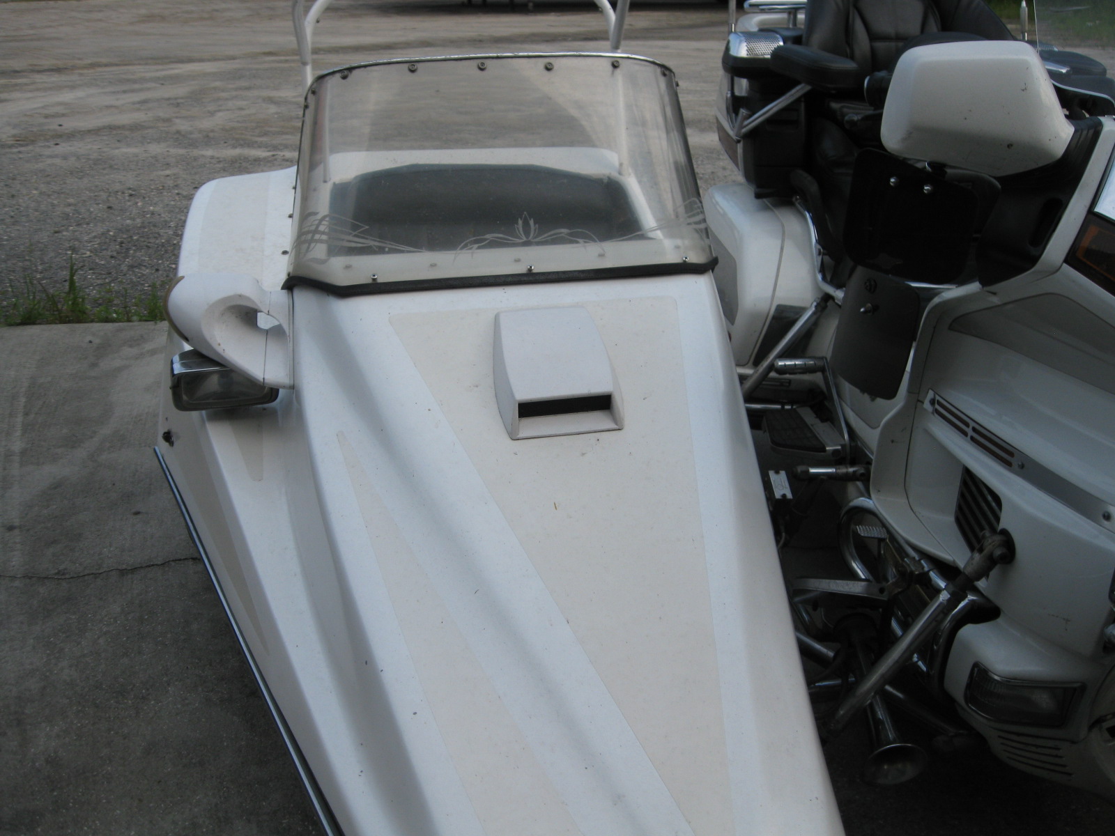

in my opinion that sidecar is ideal for a hood scoop as it has the design flow already. I would not cut into the windshield if it were mine.
I have a Motorvation FII and after seeing another one that someone here did I added a small hood scoop to mine, I used a RV grey tank valve as a water seal and flow control valve
My wife loves it as she can control the air flow at any given time. the scoop was for a small Honda car, not sure which one but there are tons of different styles out there
the other thing you have to decide is where you want to cut your hole for air flow. I don't think the bike side is a good idea as it could pull engine heat if it was not forward enough
the floor works good but in my opinion interferes with,,, well the floor,, and anything on the floor would restrict it's air flow
just my 2 cents worth, by the way nice posse

Thanks folks. I really like the scoop idea. Thanks for the pictures too!

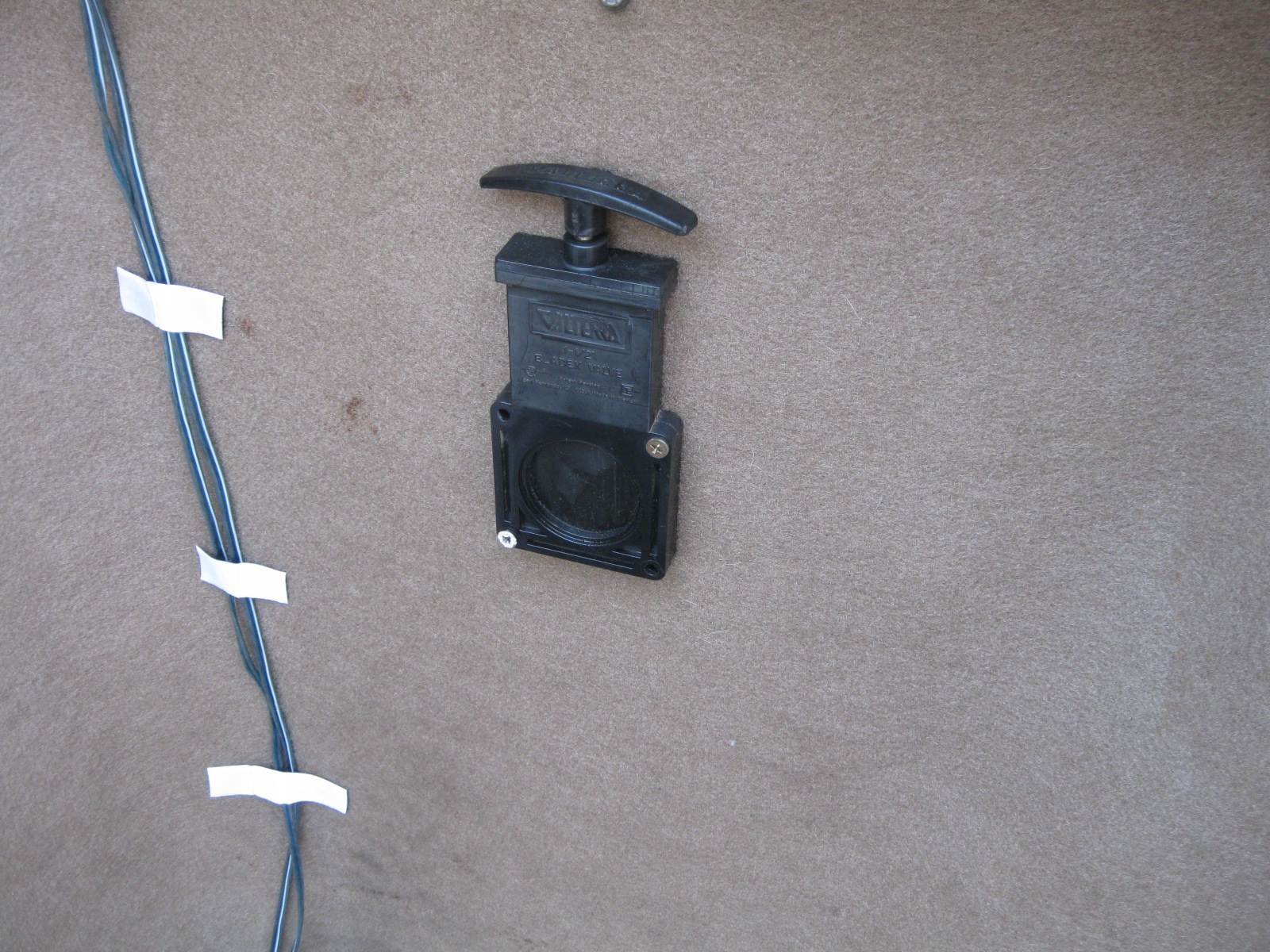

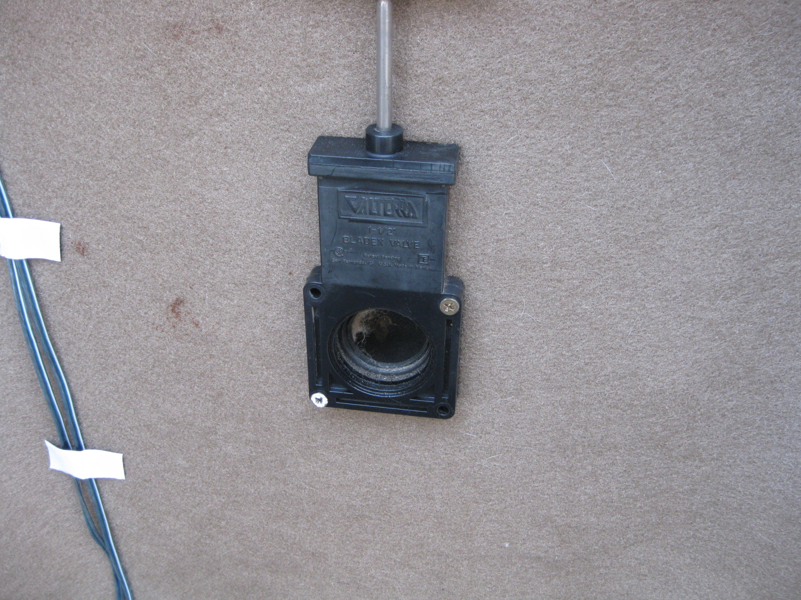

After a bit of research, I decided to go with a vent from Florida sidecar products. It was a bit unnerving to cut a 4-1/2" hole in my sidecar.  One problem I ran into, the screws that come with the kit did not have a large enough head to hold vent ring in due to the sponginess (if that is a word) of the rug and curve of the body.  I picked this screw up at HD that did the trick.
  http://www.homedepot.com/p/Everbilt-3-16-in-x-1-4-in-Aluminum-Flat-Head-Slotted-Machine-Screw-with-Binding-Post-815581/204274860
 This vent works really well.  My doggies approve!  Here's a few pictures.  Sorry about the dog hair ??
