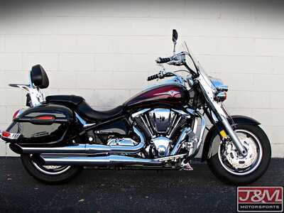

 In my constant search for a trade I may have found a 2005 Vulcan VN2000. I like the idea of the 2 liters engine, I like less the HD wannabe look but I am looking at the feasibility of attaching my California FS3; triple trees seem to be available, in the US & in Germany, I am waiting for some answers from Champion & Hannigan (should I ask Texas sidecar?) for mountings but  (and I already read everything about the 141ft/lb torque!!) I'd like to have some 1st impressions from people who did drive a rig with this big mama of a tug. Good freeway speed? not to heavy in mountains? brake OK (btw: linked?)? ok suspensions?
Thanks for your input!

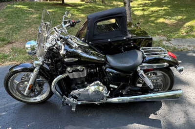

Too bad you already have that California sidecar because @croleyg is doing a fire sale on his Thunderbird/Hannigan rig, built by Hannigan and not too different from what you're proposing to build.
https://www.sidecar.com/forum/complete-rigs-for-sale/2012-triumph-2015-hannigan-rig-9500/
2012Triumph

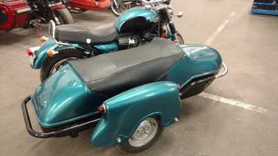

Here you are 1999 TBS… frt calipers off a VFR, RC Mikuni, T150 paint, XT225 handlebars, Xcell rims.
IMG 8143
IMG 8079
IMG 8046
Posted : September 25, 2024 4:15 pm
So cool.  Thanks for posting those.
I loved mine. I bought it to encourage me to keep doing my physical therapy and getting my back sorted out.
The more work I did, the better I felt, the more I could ride.
I sold it to start a martial arts school.
I don't regret it but I do miss it from time to time.
Posted : September 26, 2024 1:22 pm
@andrew-baker The 3 pots is great (like most of 3 cylinders!!) my main problem was the 2 guys, one after the other, from who I got the bike: they left the gas tank rust inside creating a lot of particles plugging the carbs which as you surely know are a pain to access (who had this idea of a one piece air filter non replaceable but as a complete unit?)... plugging the carbs (Keihin on mine) was not enough, rust and debris destroyed the needle seats (part of the body and not interchangeable) and I had to buy a complete set of Mikuni RS, new from NZ $$$$.
It is a fun and light rig but for the stock front real heavy even with a larger handlebars!! It use gas as if it was free but it is almost as fun as my Vmax!!
Posted : September 26, 2024 2:06 pm
