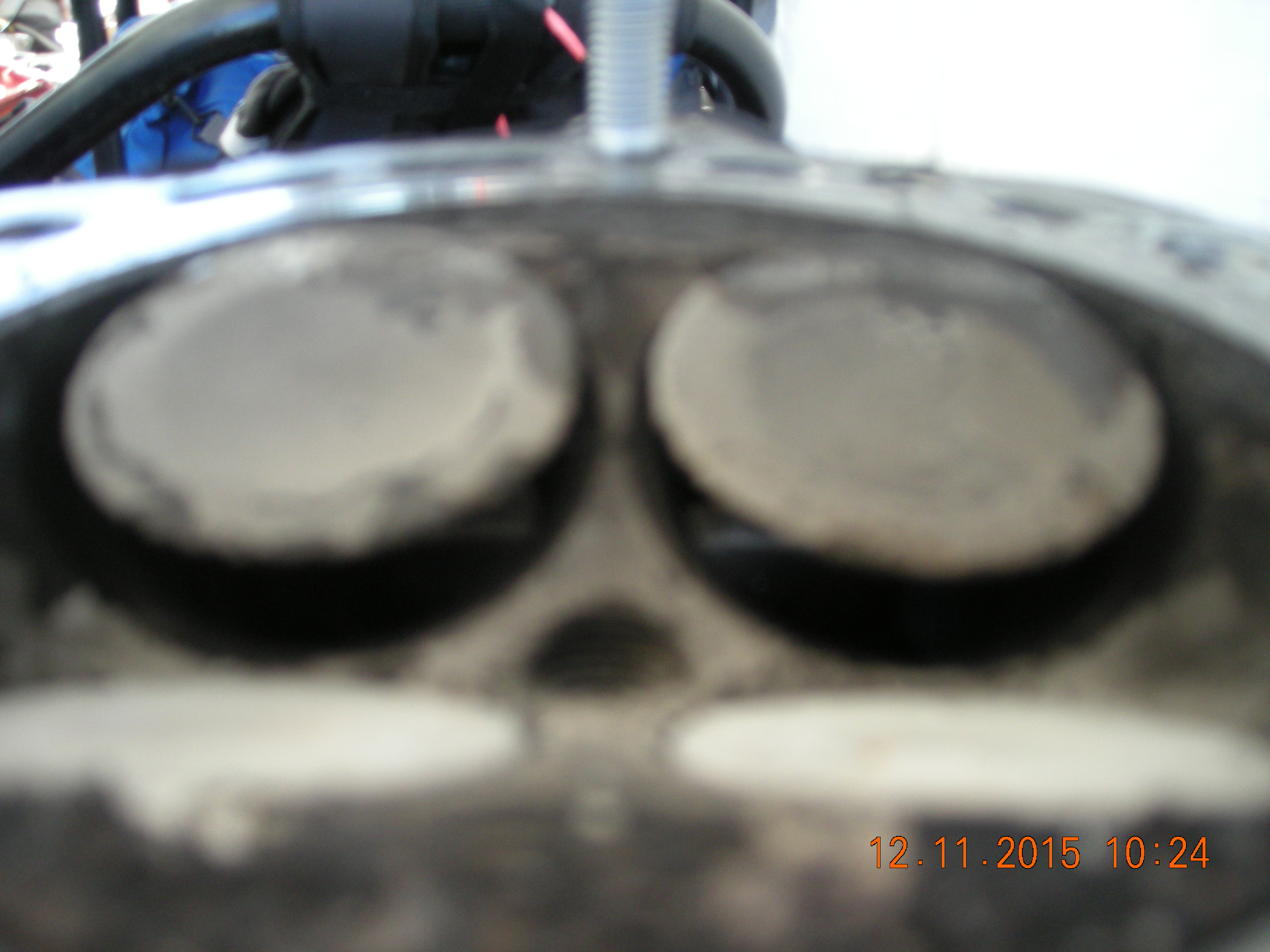

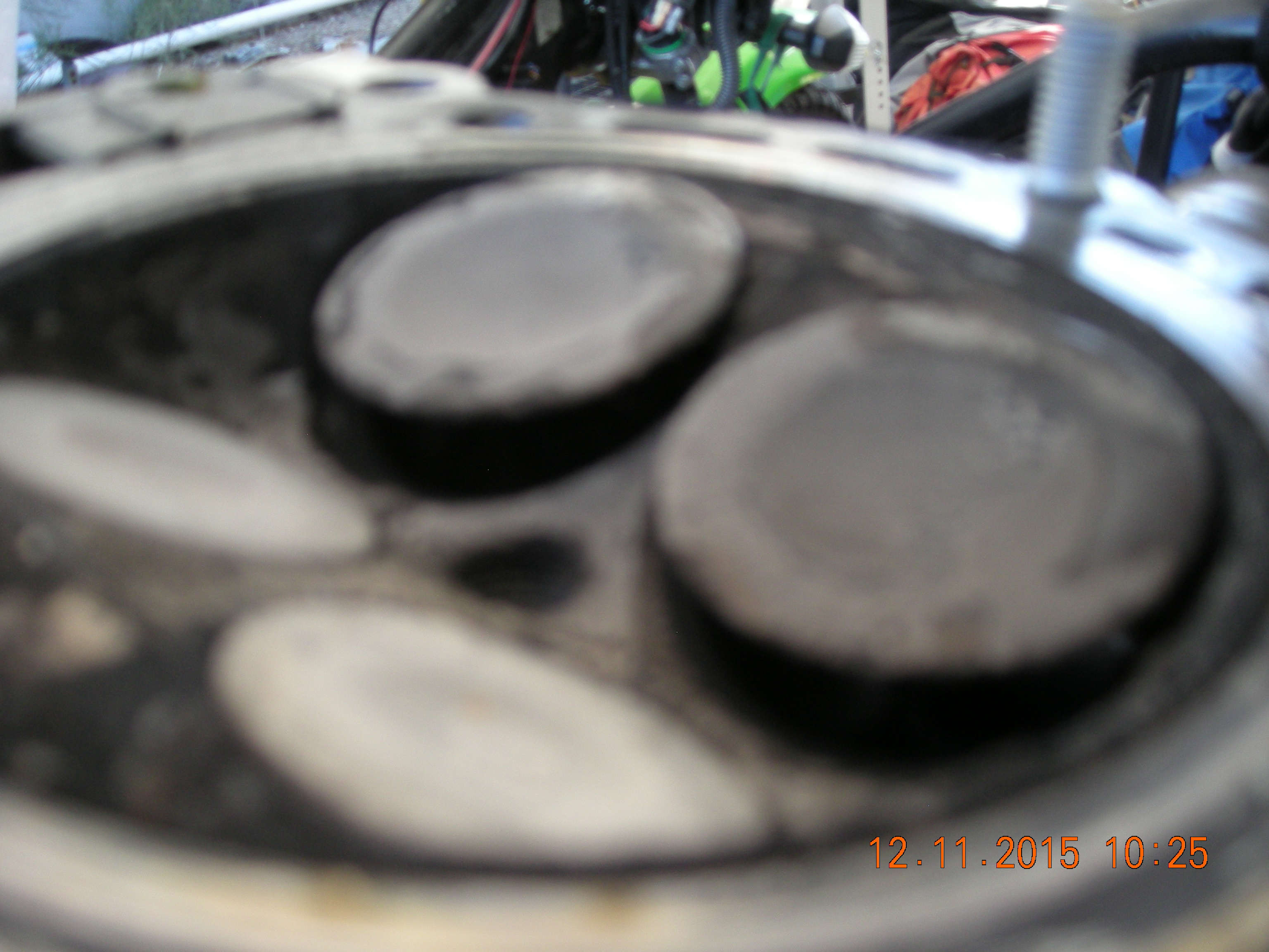

It was a long hot summer so I just started to tear down the KLR and found bent valves, so far no one knows why I maybe the frist with this problem. Ant way sending it of to M-Tech for the 705 kit. Should be up and running for Colorardo.

Bent valves don't know why but and sending everything up to M-Tech for the 705 kit.

Bent valves???? That's a first.

Yep it up and running, now a 705 with cams and carb work all done. I only cost about $3,000. The doohickey failed and the balance chain slapped around and caused the cam chain to jump and that is what bent the valves, so fix those doohickey's before it is too late.
I had a stroke the 1st of June so I had to miss Hotchkiss but still waiting on my t-shirts That I had ordered.
Thanks for asking, Joe
