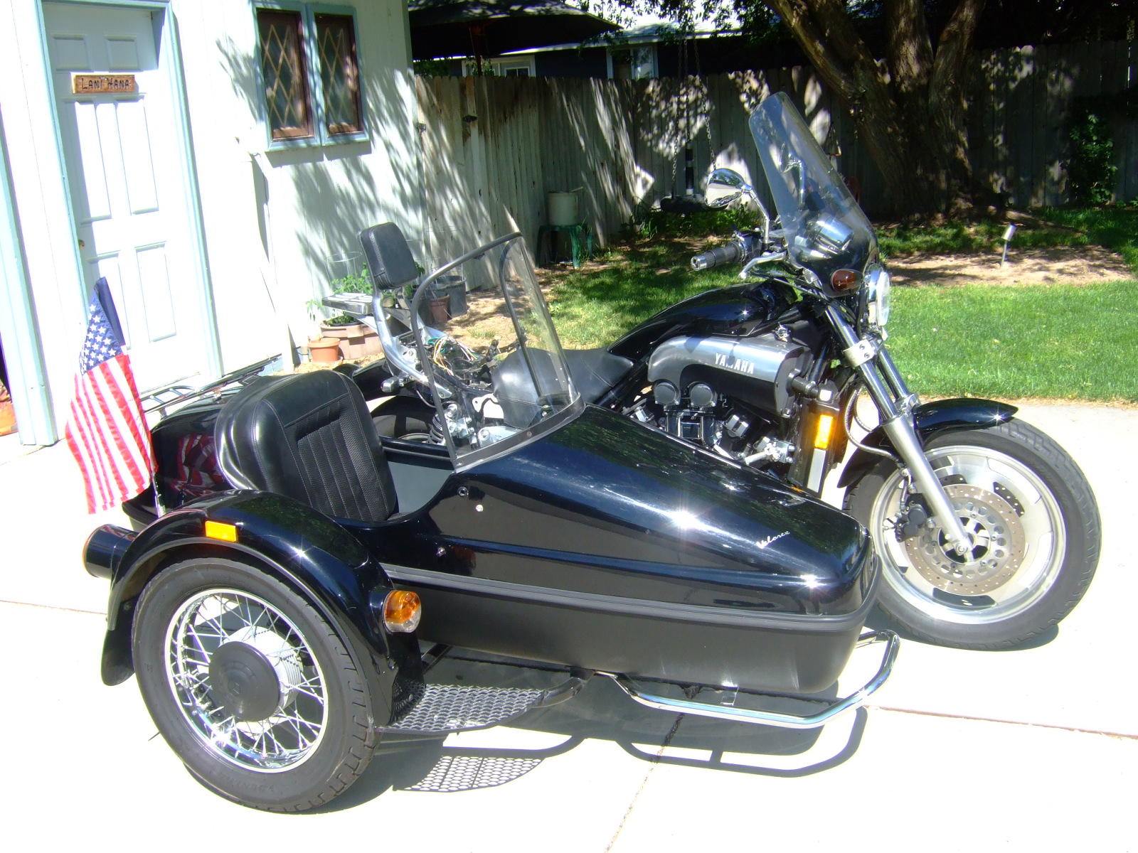

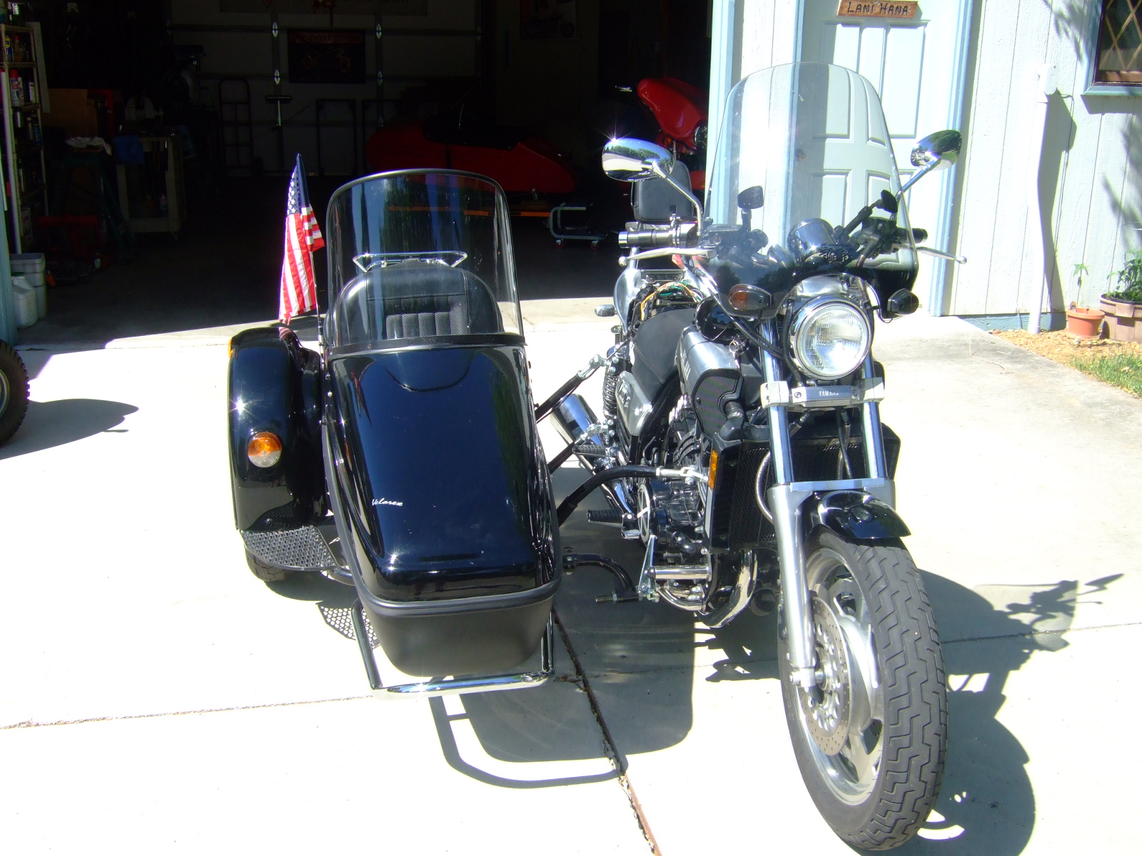

Depends upon what hack you are mounting.
Here is a V-Max/563Tour rig we set up recently.
Posted : December 18, 2012 10:26 am

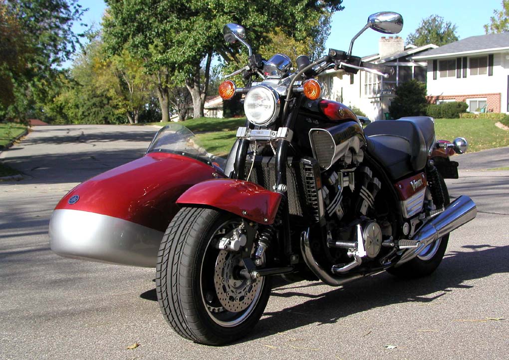

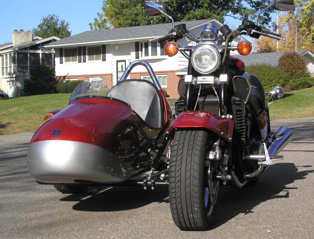

(@pierobassi)
Posts: 212
1989 V-Max with Motek Bobby/LE Sidecar.
Piero Bassi
Minneapolis, MN
pierbassi@gmail.com
Posted : December 18, 2012 11:57 am
Awesome guys thanks. Particularly like the leading link set up on Piero's one although my setup will be more like Hak'ns one. Was there any tricks with securing the clamps to the bike frame?
Posted : December 18, 2012 6:31 pm
I would avoid using "universal" type frame clamps if at all possible. If you do use them, use them only on the top and make sure that the forces going into the clamp are in line with the frame tubes not tying to rotate the clamp around the frame. You have a bike with lots of power, you should be mounting a strong heavy sidecar on it and as such the mounts have a lot of work to do. They must be done right and safe.
