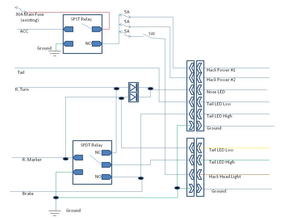

Here is what I did. I used a flat-4 trailer connector for all things on the hack frame and a square-6 for all things in the car itself. I wanted to keep the frame and car connectors separate because my car is easily dismounted from the frame and I plan to build a flatbed that can go on in it's place for hauling cargo and for possible wheel chair use. Having the car on it's own connector makes the swap easier. The tug is a Goldwing 1100 by the way.
The top relay is connected to the ACC feed on the bike. It goes live when the key is turned on. A fuse block then feeds power to "Hack Power 1" and "Hack Power 2". A third fuse is switched and used to power auxiliary head lights on the frame. Other connections on the square-6 feed a front marker light and a second tail/brake light that is mounted high on the car like an automobile's 3rd brake light. The HIGH and LOW you see is for brake lights and running lights respectively. Then finally there is the ground connector.
On Goldwings (and I assume many other bikes) the marker light turns off when the turn signal is activated. The bottom relay and diodes are there to do that same function for the hack. It basically converts the brake light (LED High) into a turn signal.

(@al-olme)
Posts: 1704
OldSchool,
That's a nice clean way to do things. You could have the same function out of just the flat 6 but that would add complexity and there's plenty to be said in favor of nice clean direct wiring. Good job.
