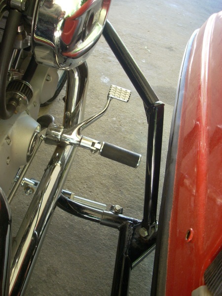

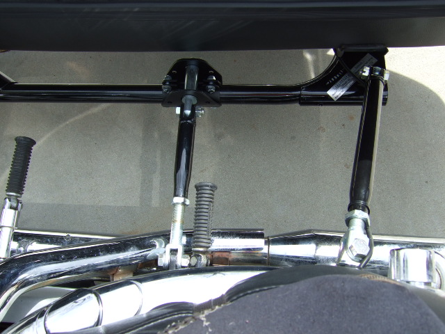

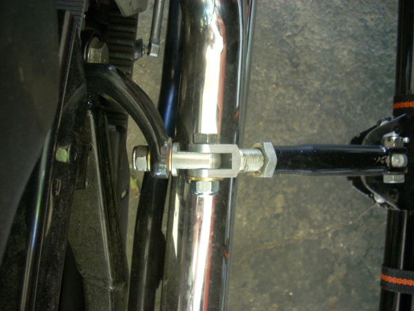

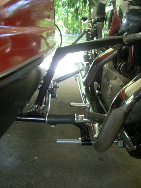

Well, I'm on the road. Took my two spare struts and my right side passenger peg mount to the local Indy/fabricator. He bored my passenger peg mount to accept a trimmed down eye-bolt. I placed a lock-nut on the eye bolt and fixed the lower rear strut to this. He then cut my two spare struts and welded them together at a 135 degree angle. The weld is extremely strong and has a reinforcing plate on the inside of the angle. Cost me 40 Euro for all the welding and machining. I also added a 45 lbs. Olympic plate to the sidecar frame so that I have permanent ballast. I'm satisfied with the set-up and am looking forward to some good touring with my boy. Thanks to all who offered advice and examples.

You might consider repositioning the rear lower strut and clamp as shown here if it has a tendency to slip or rotate.
Posted : June 1, 2008 9:48 am
Lonnie, thanks for the advice. I'm hoping it doesn't slip. If it does, I'll have to remount the whole car. I have that strut backed-in all the way it can go. I guess I could cut the thread by and inch or so, but I'm not too keen on that idea.
