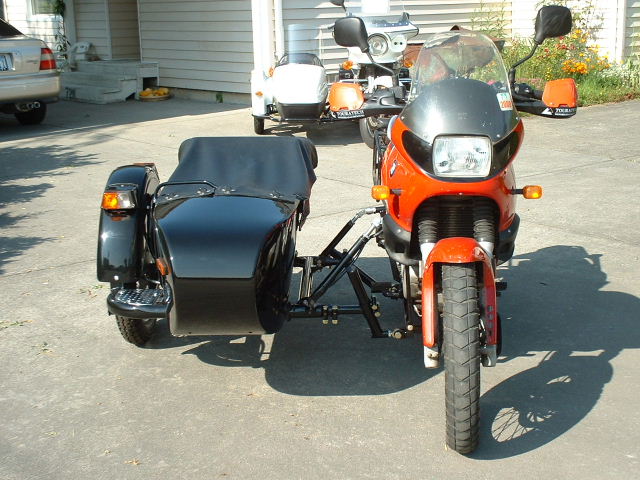

What is the 'optimal' wheel offset and wheel location for installing a Sputnik to an F650GS w/Dauntless frame. By 'Optimali I mean it will be my starting base.
Figure A on attached: Distance from frame to hack frame?
Figure B on attached: Wheel offset between rear and hack wheel axles?
Thanks in advance,
felix

Jay found some spare parts for me--they are UPSing their way to Connecticut. AS soon as I get them installed I will post photos.

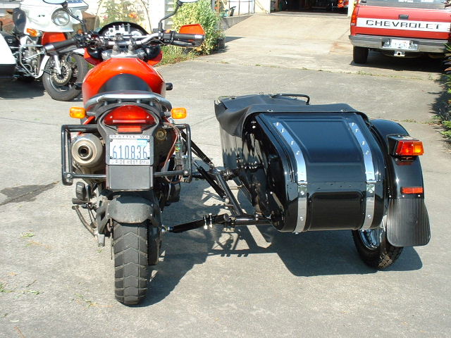

I have received the parts from Jay at Dauntless and installed the frame and hack this weekend. A test run to get gas for the bike, I found the bike handles well on the straight aways. No shimmy, no crabbing. Ooh what fun it was. I guess I got some what lucky after 4 hours of adjusting and measuring and repeating it again a few times. Just need to finish installing the bling that came with the Sputnik then I'll post some photos.
