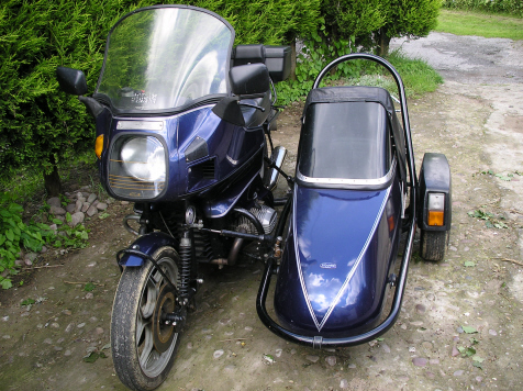

Back to the subject of sreering dampers, has anyone here experianced the phenomenon of over damping, i had a bmw r80 rt with a squire st2 with unit front forks wich i bought from a guy who said he had tried to ride it but found it to scary no probs thought i until i hit 50mph i was all over the road did 100 mls at 40 just to get it home turned out that the steering was so light that the damper cancelled out the self centering of the steering, so be careful its a lot scarier than head shake. Hank

Well, I haven't personally experienced it. but I wouldn't want to ride very far that way. With a BMW, unless the steering damper was a factory accessory, it's possible that it could be too stiff. If the damping action is too stiff, it could be dangerous.

Dangerous it was, i felt sorry for the chap who sold it to me as it was his first time on an outfit i even offered to let him have it back but he felt giulty selling me a dodgy rig & wouldnt here of it. and it was a VW Damper. Hank

It could be that the VW steering damper was too heavy for the bike. They aren't adjustable, of course like some of the more expensive ones that are sold for Japanese bikes. It's also possible that the steering head bearings were shot or poorly adjusted. I had to change the ones in my 1994 SE Goldwing becuae they were completely worn out with notches and flakey spots in them.

Hank41 - Strange tale that one about the VW damper on a BMW, cause I have one on my R100/Squire ST2 and it's brill. Ran for 10 yrs without one then decided to put one on cause of the deflection's I was getting when going into corner's hard n fast. Completely cured it and it's no bother at all.

Hi Karl still rode with a damper just put a well used second hand one on & it worked fine. like where you live roads are great fun. safe riding. Hank
