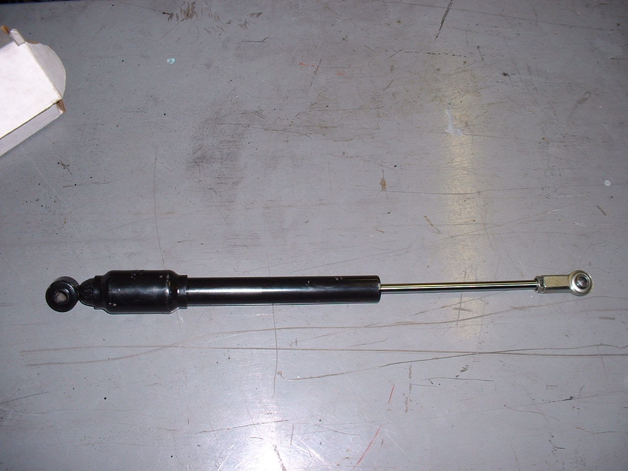

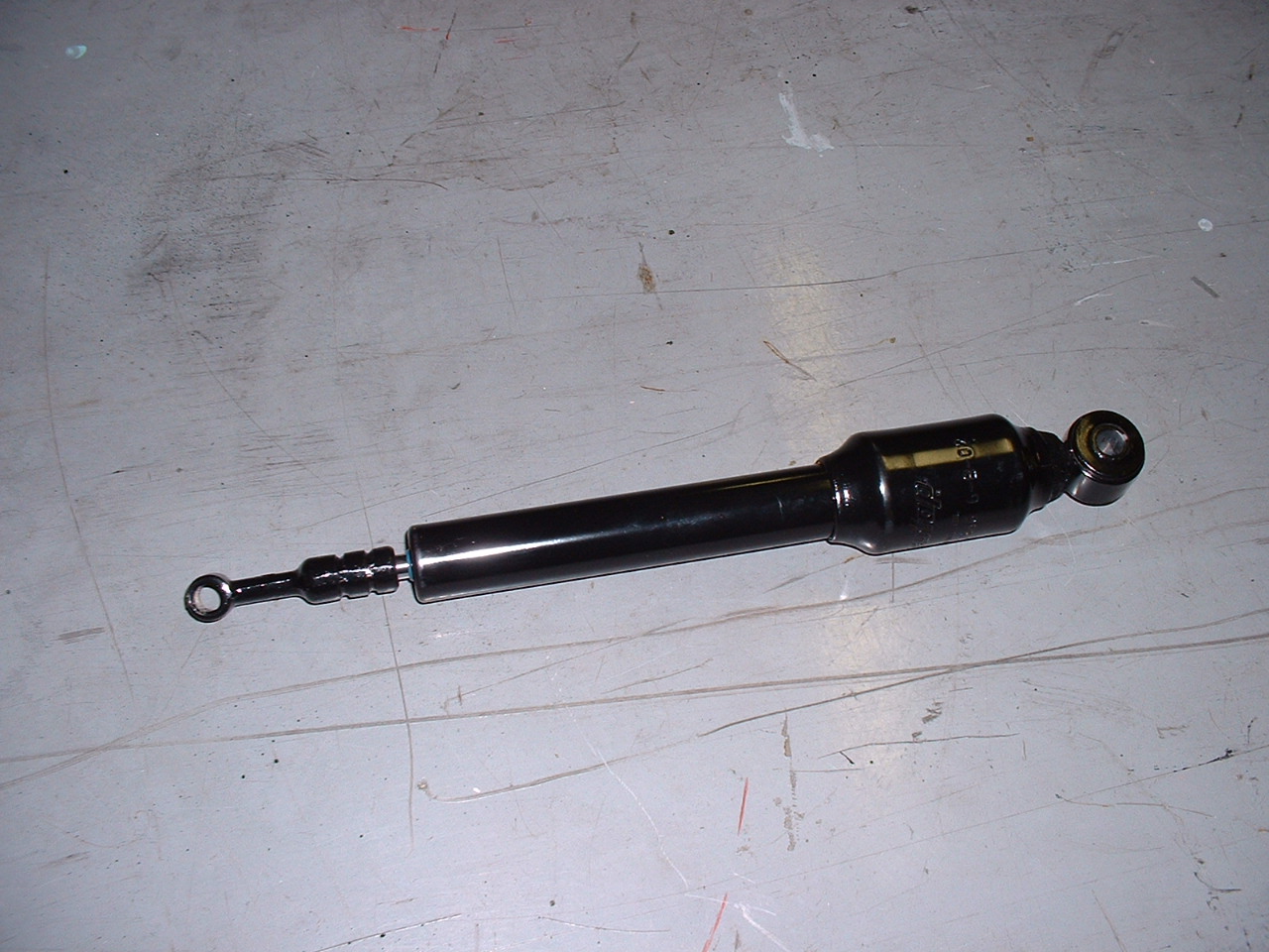

Well, you've got three choices. You can buy a new damper from Harley. You can get a VW Beetle damper from a VW shop or you can try to weld the broken part. If you could post a picture of the broken part, maybe someone could make a suggestion.
Posted : July 25, 2008 2:45 pm
I have adapted rod ends (heim joints) depending on the application.
The stock fittings are swedged onto the piston rod.
Posted : July 25, 2008 6:45 pm
