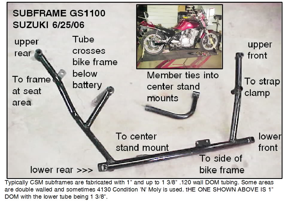

We have done a couple of Suzuki rigs and one GS1100 with a Terraplane. It is a pretty straigth forward setup if you use a subframe. We did use a four point mounting system though. See attached subframe picture below.

hello claude,
thanks for the information, but my fault was not to write, that
i have a 82' GS1100GK.
i think the subframe on your picture is for a much younger
SUZUKI.
Thanks anyway.
Regards Thomas

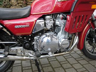

Can you post a picture of the bike?
Posted : December 1, 2008 9:40 am
hello Claude,
no problem.
Posted : December 1, 2008 6:56 pm
Sould be a fairly straight forward mount IF you can locate or fabricate a subframe. Contacting Dauntless is a good idea they may have one on the shelf.
