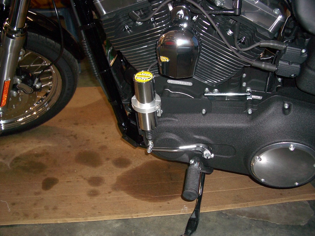

Did some research before I got an electronic shifter for my handicapped sidecar and decided on the Klictronic because it has an easy to reach neutral.
If I would have had the money I might of invested in an automatic transmission but I have been using automatic tranys since becoming paralyzed after a motorbike wreck 25 years ago and wanted to use a manual again! Missing going through the gears....

Nice unit and I hope it works well for you, I do wonder how the down shifts will work out, let us know OK?, it better work cause it sure ain't cheap but I'm glad you found something that will let you grab some gears 🙂
